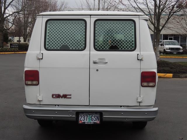

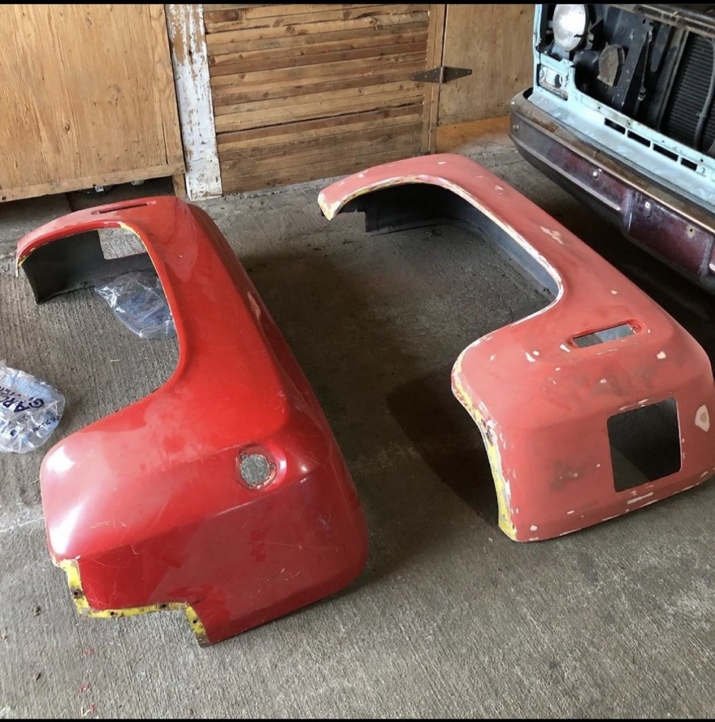

I’m painting my truck in stages. I’ve got the cab and front clip in primer, I’d like to move onto the box and rear fenders but before I do so I need to figure out what to do with the holes in my fenders. I bought these fiberglass stepside fenders off a kid as they are in great shape, however, there’s some fairly large holes on the back of each fender that were probably meant for custom taillights. I have the original taillights and brackets but that would require me patching the holes. Any ideas from the veterans here as to what I should do? I was looking at retrofitting some taillights from the older Vandura’s as they are quite large and might fit. What do you guys think?

I disagree. I always wanted to do an old El Camino bumper with the lights down there. I think the rear of the stepside fender with nothing blocking the view looks awesome.

Ok, ok. If you DO use the factory lights, make sure to run a ground wire from the bulb socket down to the frame.
The original ground via star washers, which break the paint on the bracket and then rust. If you paint everything up nice you won't have a good ground and your brake lights and turn signals will be wonky.

Thanks everyone for the suggestions. I’m leaning towards going with the stock lights then, I’ve done fiberglass before, it’s not terribly hard but it’s nothing to enjoy. I have to finish painting the doors anyways so I have some time to think about it. I am excited to get this thing on the road and finally have some worthwhile photos to post on this forum.
