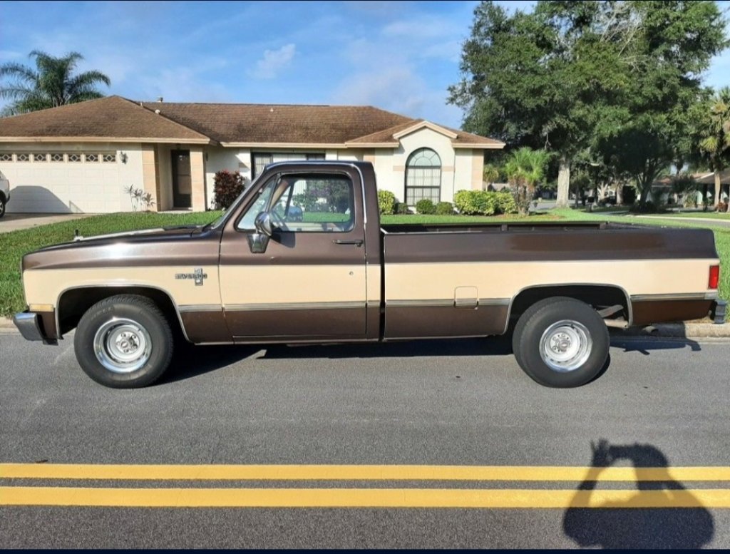

I have a 84 c10 i want to lowering.
I just want the top of the tire to be flash with the fender edge. I dont want the tires inserted in to the fender box.
What are you guys recommend cheap, easy to do and i will try no to change a lot from original for alignment etc.
If you guys can help me with best rout to go and links with parts i have to buy i will appreciate.
