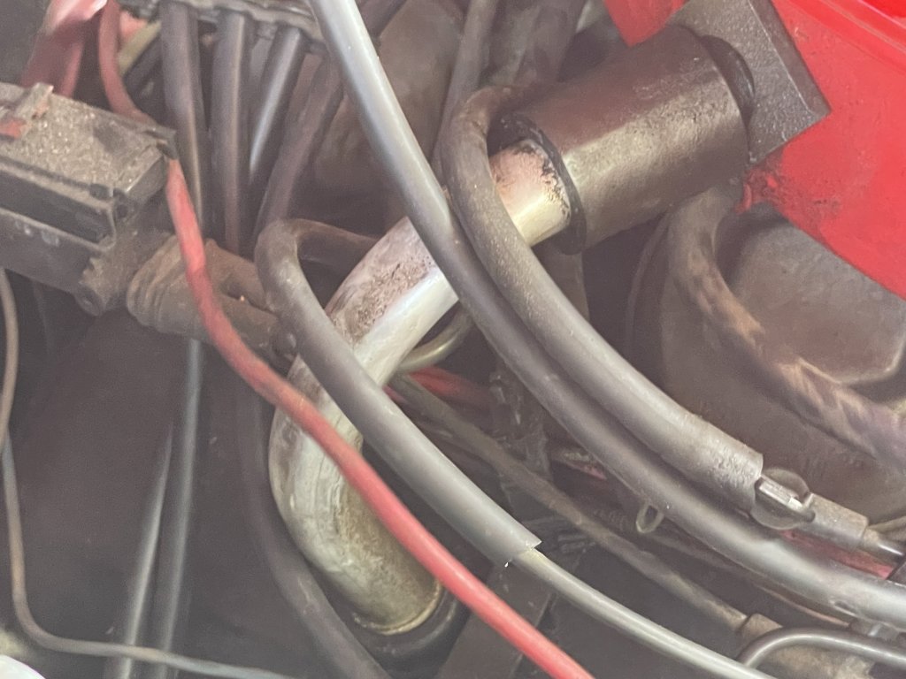

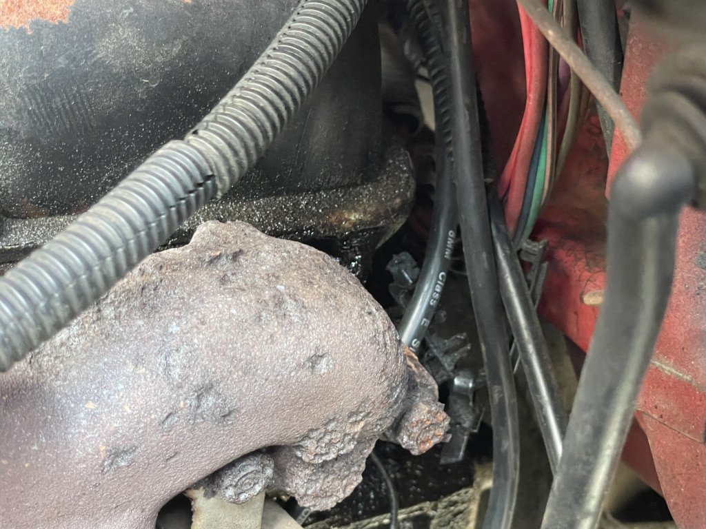

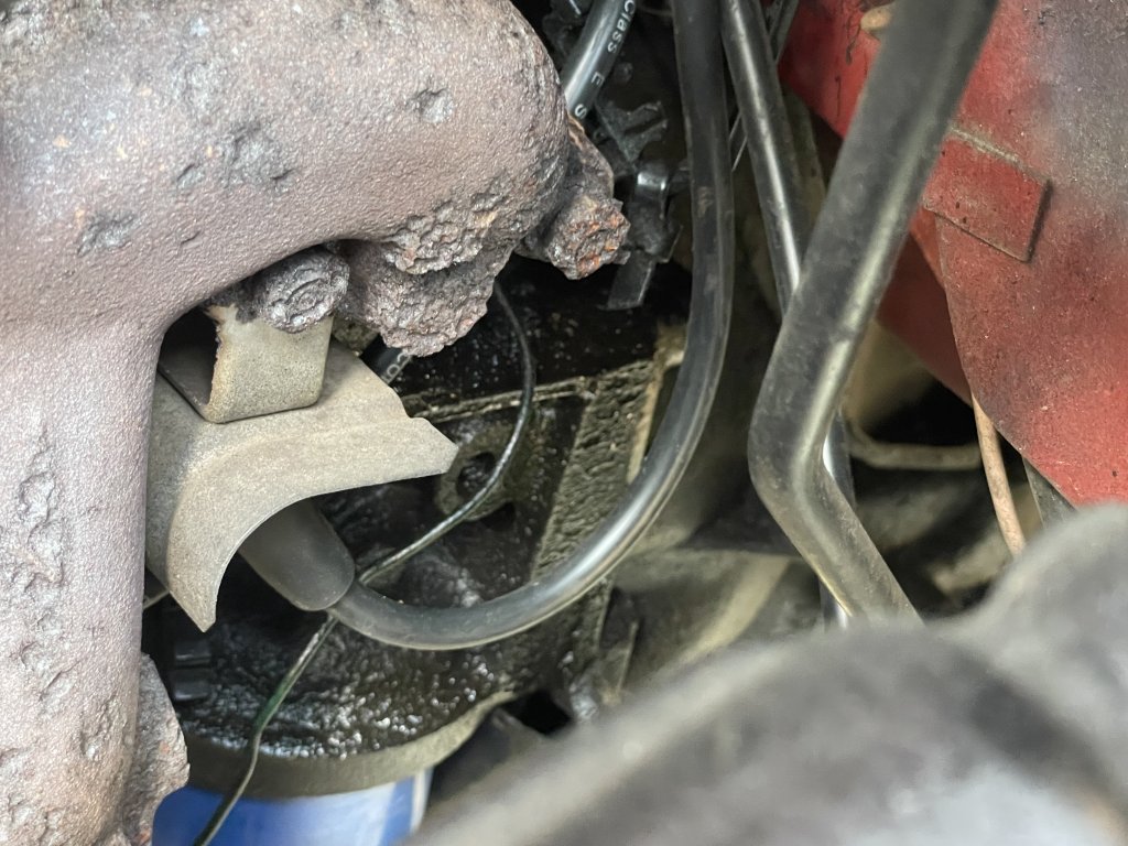

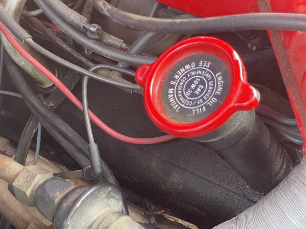

I've got a new distributor cap and rotor to install, and I also noticed oil running down the back of the engine on the driver's side only. There's no puddle under the vehicle, but it's down about a quart and I did change the oil recently, so I've also got some new gaskets for the valve covers that I'm going to put on it. I can see oil along the seam of the driver's side valve cover, so I'm hoping that addresses the oil issue. I've got some pics I can share of that, too.
I'm very new to all of this, but I want to learn. Since it's running now, I just want to make sure I don't get myself in a position where I can't drive it to the auto parts store since I don't have another vehicle right now. I'm thinking once I change the cap and rotor I'm going to need to adjust the timing, so I'm thinking I should rent a timing light before I install them, right? I really need to get this truck running right, and I think it's just in need of some basic maintenance, although I'm starting to get discouraged. Any advice from more experienced C10 owners is appreciated.
Dropped some pics below with file names that describe what I was photographing. Couldn't upload video, but I took some and put them in a Google Drive folder so you can see and hear what it sounds like right now. It didn't keep firing when I cut it off this time, but the third video does show how much the engine is shaking while idling right now. Seems like more than it should to me. I'll try to get out an drive it in the next day or two and get video of the shaking to add to the resources.
