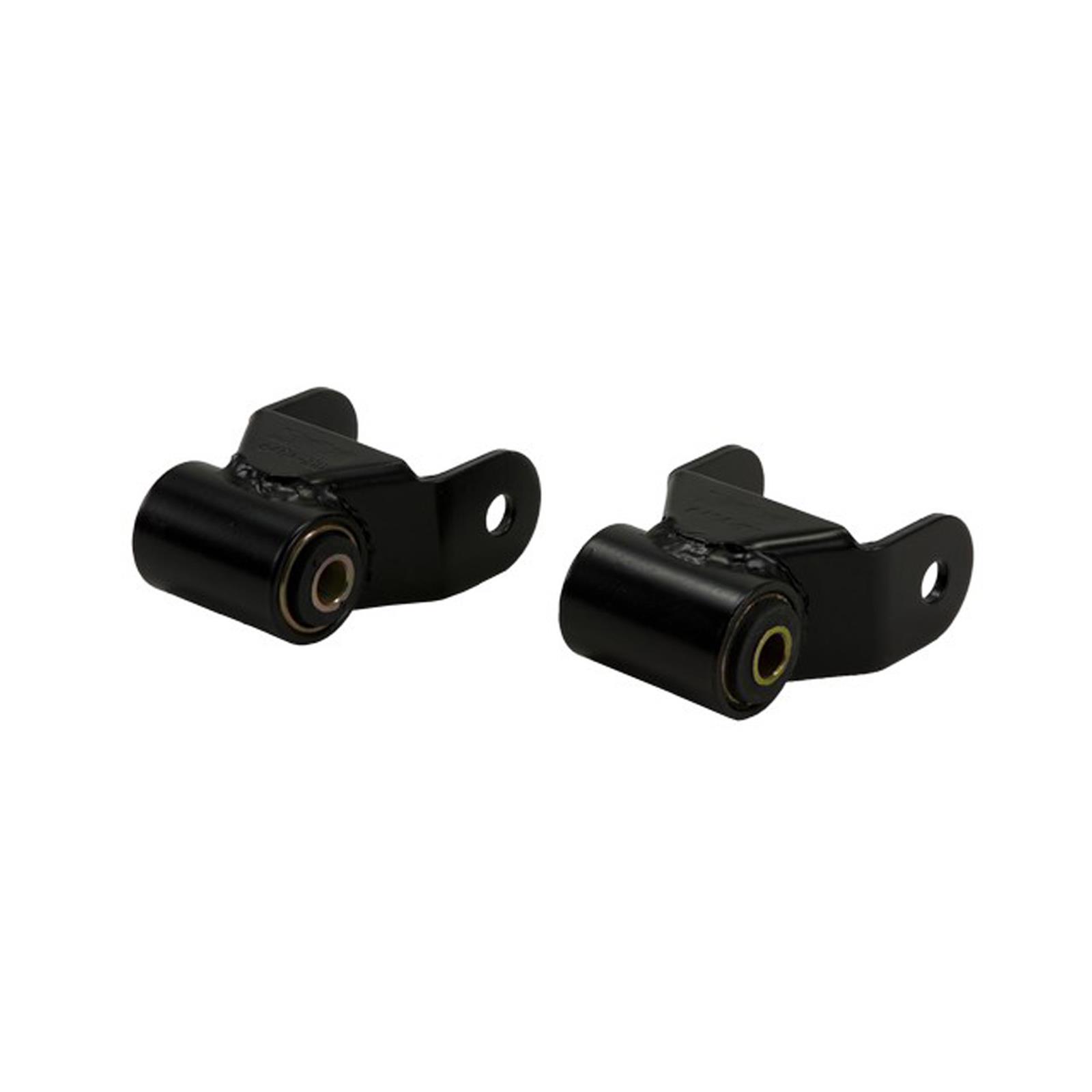

Here’s my thoughts on the rear drop. Measure and do the math but you won’t get but maybe an inch of travel if you do an axle flip and don’t notch the frame.
Other options, drop hanger and shackle can get about 4” plus whatever you pull out of the spring pack. But you have to do some major surgery on the front spring mounts which looks either very difficult without removing gas tanks or easier if tanks removed.
3” or 4” drop leafs are simple bolt in for not much more $ than the above with about 80% less work.

do flip kits ever fail ? - I mean I'm sure people no longer use their lowered trucks to haul or tow, however just looking at it from a "structural" perspective, all weight and force at the rear is now directed through only a pair of U bolts and their threaded nuts. OEM mounts the leaf pack over the axle, so all weight is transferred directly into / onto the axle shaft and then to the wheels.
Always been interested in thoughts on this?...

To get enough weight in the bed of one of these to break stuff the frame would meet and rest on the axle before that point, then you'd have other issues like steering being super twitchy and possibly bending the axles out by the flanges.

I've seen several fail but always due to poor quality parts or improper install, never from the load. I've had my truck loaded TF down several times and never had an issue with it, my only issue was driveshaft clearance :lol:

Slide under your truck with a tape measure. A flip is 6-7” with no ability to make it “slightly less” unlike the multitude of options if you don’t flip it.
Axle flip is a no go without a notch on C10s like ours.

The only real way to know is measure the axle and perch height and see what that leaves you over the spring to frame rail, for sure you will need to remove the bump stop and its mount, 2 rivets on each. My flip kit fit with 3 inches between the top of the axle and frame rail when it still had the stock BIG TEN leaves and 12 bolt and it did not hit, but I've heard others weren't so lucky.
There is a shorter shackle available, but it doesn't do much.
Unfortunately, don't have a pick of the flip kit with the stock parts still in it.
