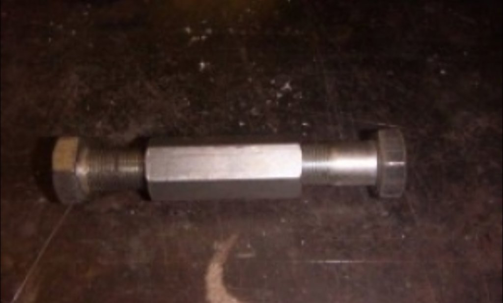

Regular hammer,you just need to know how and where to hit them.Put some pressure up with a prybar on the tie rod hit the socket from the side hard with a hammer,the vibration pops them apart. Ball joints back the nuts off to their ends and again big hammer whack from the side. If they won't pop screw 2 bolts into a coupling nut put it between the 2 ball joint studs and unscrew the bolts from the coupling nut it will push the ball joints out. Grind the markings off the top of the bolts and use a big drill bit to put divots on the tops of the bolts so the don't walk off the ball joint studs. I'll see if I can a YouTube video if I do I'll post it here,check back. You have to hit them hard sometimes and git em more than once not tap tap,oh this doesn't work. It does its how I've done the literally decades. 99.9 effective. With just a hammer and pry bar the extra pressure of the prybar makes them pop easier,the spring acts as the pressure with ball joints . If they just won't pop use the 2 bolts for more presdure whacknthem again. Remember your hitting the socket from the side.

.....If they won't pop screw 2 bolts into a coupling nut put it between the 2 ball joint studs and unscrew the bolts from the coupling nut it will push the ball joints out.
Spreader...
