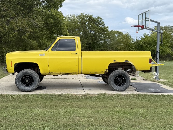

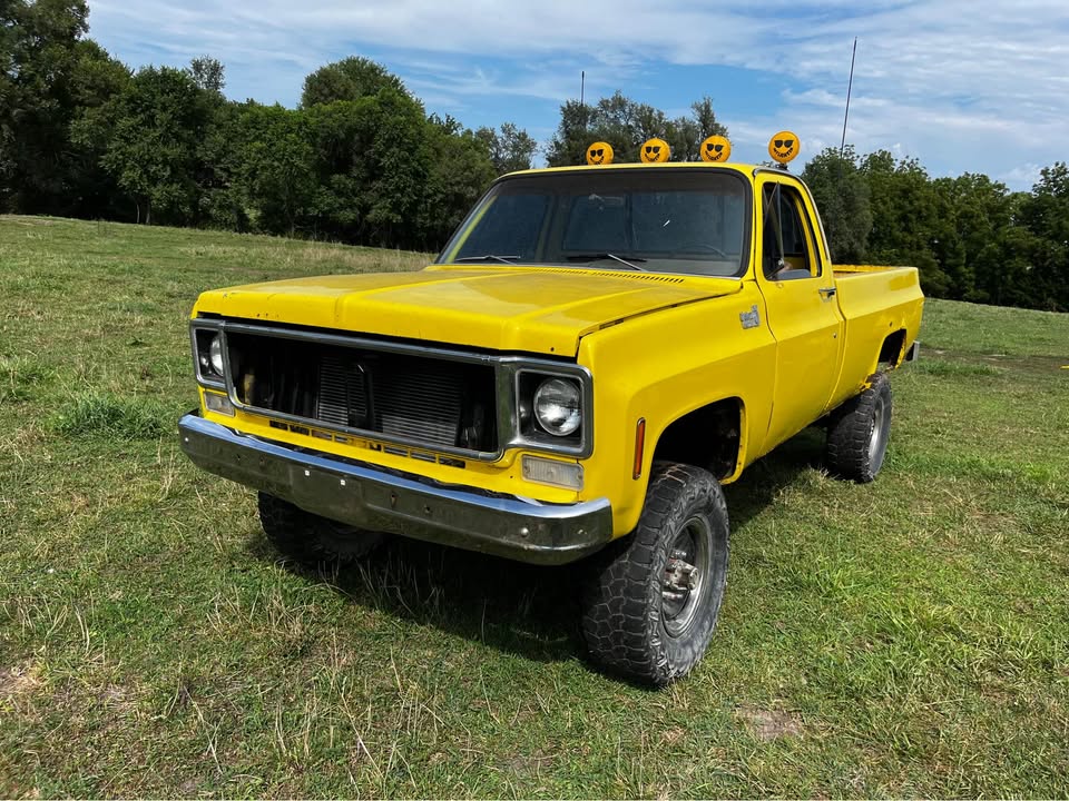

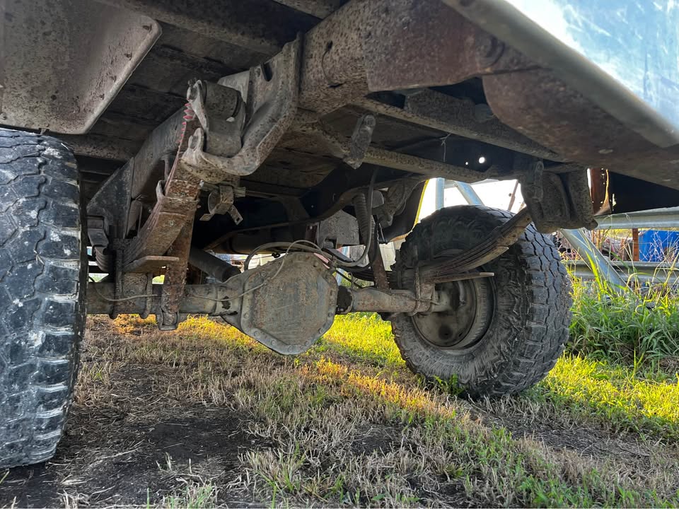

Here is another side pic. I'll go measure the front as well. I haven't done that yet.
Looks like a healthy 4” spring in front. But why do those tires look bigger than 265s.
This is 5” front lift and 35 12.50s but I think the springs been packing around the big block since my son who’s truck it is was 3 years old.(He’s 19 now).
9,558
17,536
4” ripped the fender trim off almost immediately but the wheels are 9” wide 3.5 backspacing so they are outies not innies. (Didn’t use offset @bucket the Karen…lol)
You can see it crinkled in the pic.
