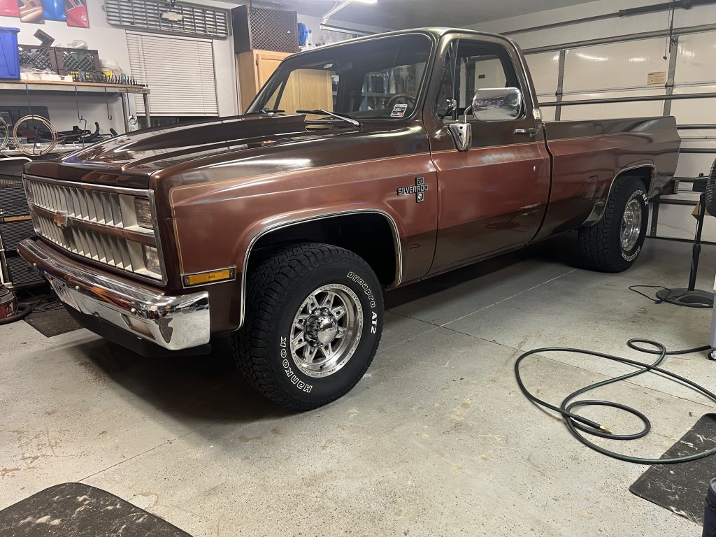

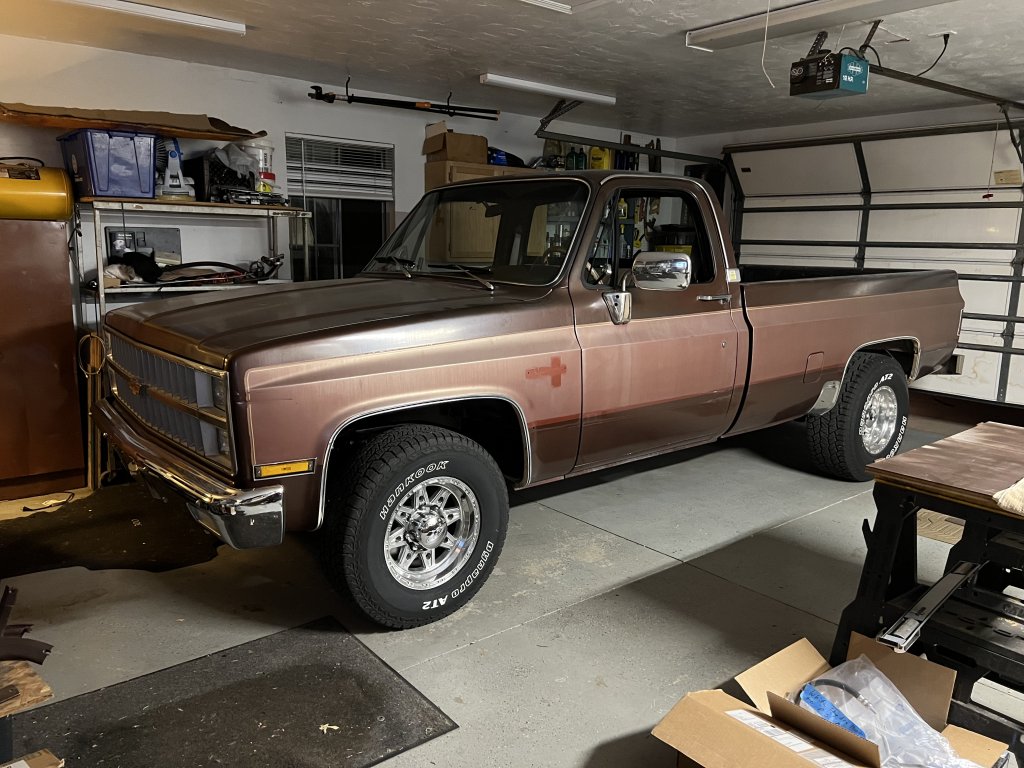

I’ve got a 82 C20 that I rebuilt the front end with new moog components including the coils springs, I was shocked at how much higher the front sits now! So many people think it’s four wheel drive now. Before & after pics attached
Is that factory paint colors? Cool color combo!
Wow that really is exactly the amount of lift I'm wanting in the front. Do you remember which Moog springs you used? Other elements may make our results different, but it might be worth me trying nevertheless.
