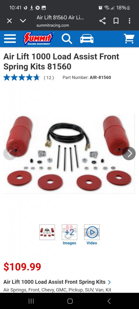

I have a pair of those for my s10 but i wasnt real sure i liked the idea of them. Your truck looks sweet!! And i love those bfgs!
