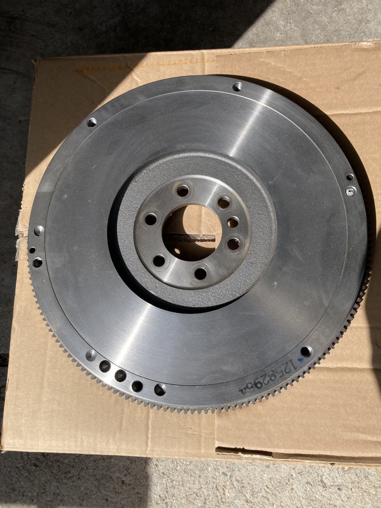

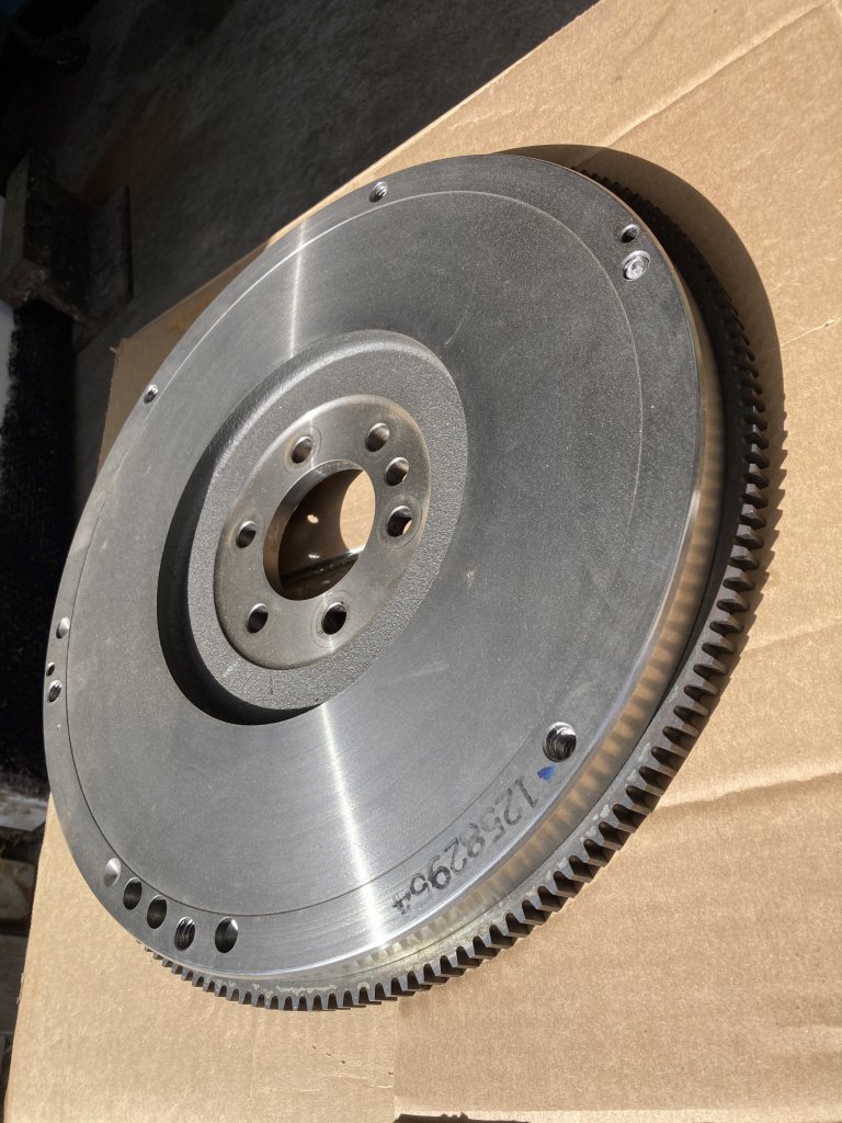

This is the flywheel I used with the 8.1. GM performance part number 12582964. Notes say “Also fits internally balanced Small and Big Block Chevy engines with 2-piece rear main seal.” Visually it’s identical to the flywheel that’s on the original 350sbc. Only difference is the 12582964 has dowl pins and metric threaded holes. I can get some pics in a day or two if you need

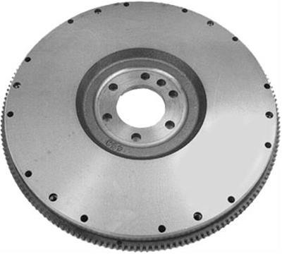

Lu Blunt
Jun 6, 2016
222
231
Rye, CO
Luke
350ci

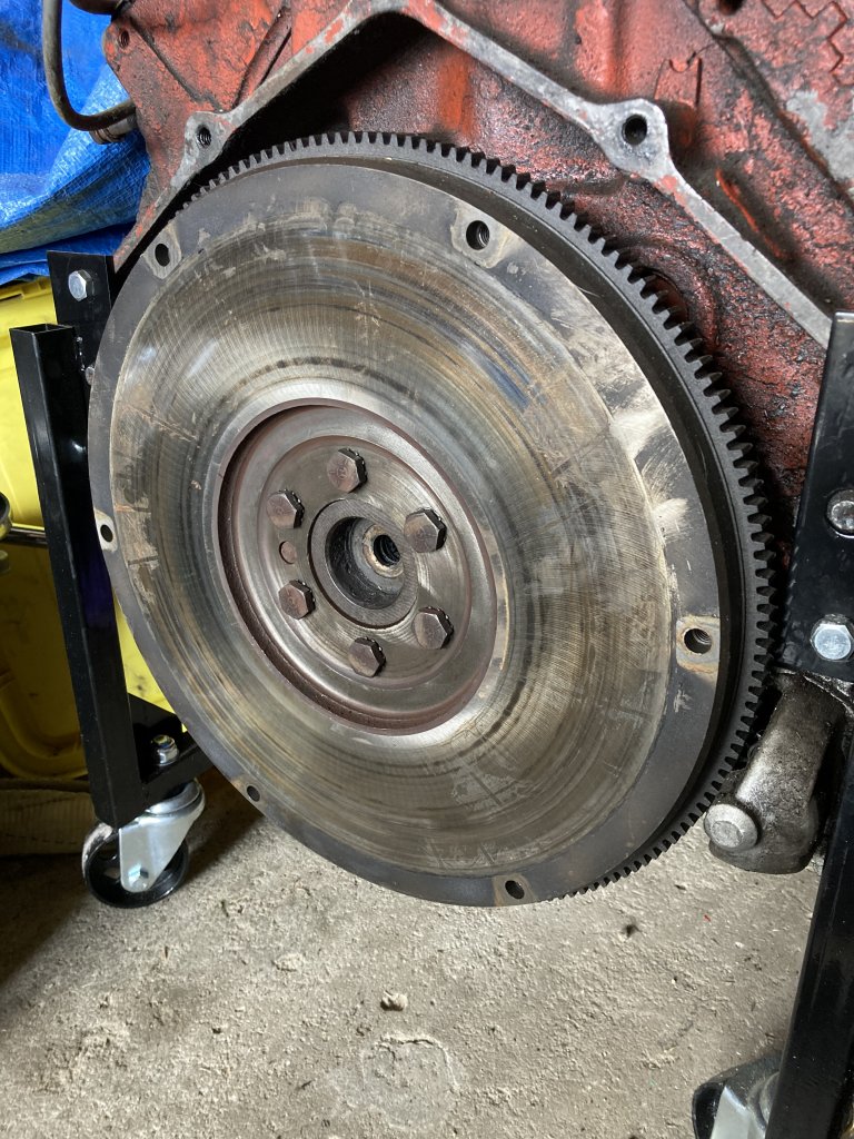

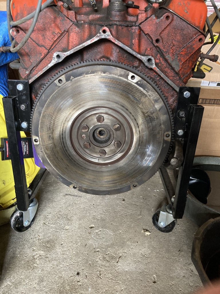

The flywheel from the 350sbc

Lu Blunt
Jun 6, 2016
222
231
Rye, CO
Luke
350ci
The gm performance 12582964 flywheel

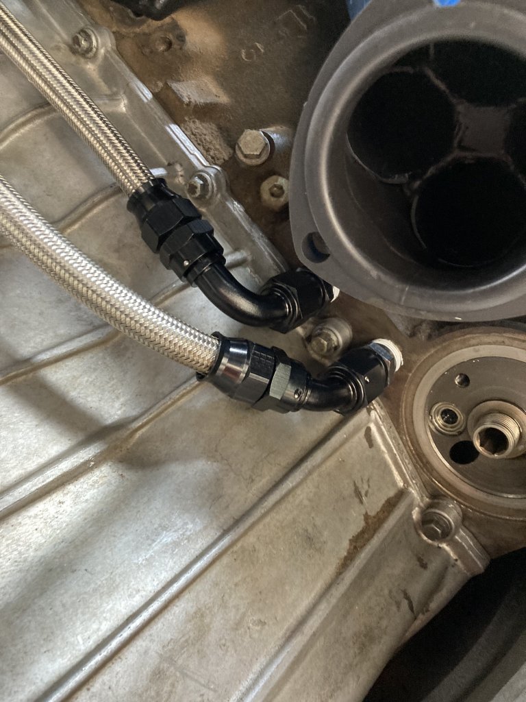

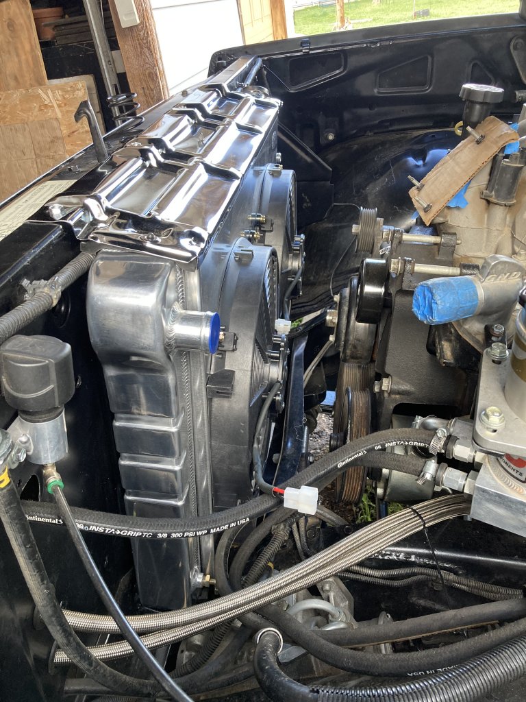

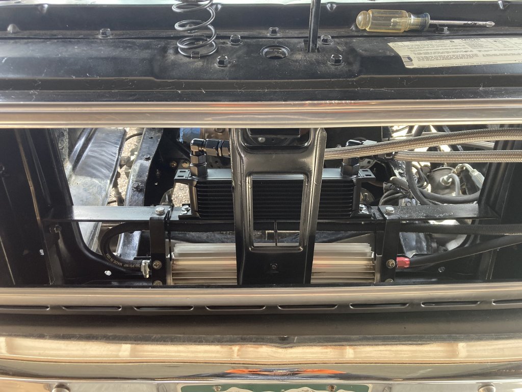

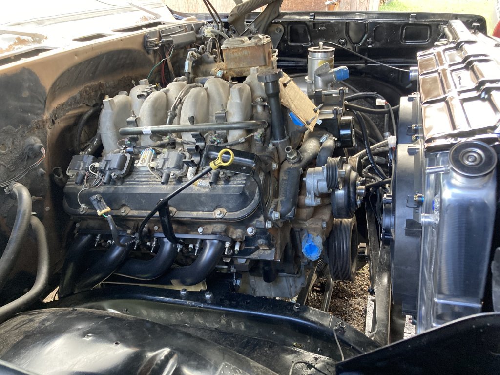

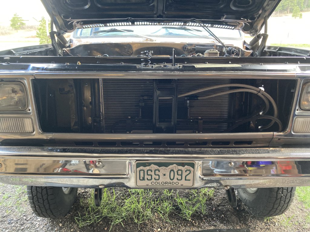

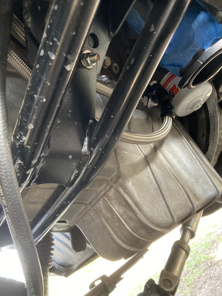

I got the headers installed but I need to relocate drivers knock sensor. I’m trying to find a knock sensor with smaller threads so I can use a different hole on the side of the block. New spark plugs installed. I made brackets and mounted the oil cooler, power steering cooler and psc external reservoir. Also made hoses for the oil cooler. Pressed the 8.1 pulley onto the psc power steering pump. Oil changed with new filter. Filled trans and tcase with new gear oil. I will need to source a different oil fill tube or modify the current one inorder to clear the throttle cable. Installed cold case radiator but still need to get longer heater core hoses and new radiator hoses. Headlights, new grille and trim installed.
Lu Blunt
Jun 6, 2016
222
231
Rye, CO
Luke
350ci

Lu Blunt
Jun 6, 2016
222
231
Rye, CO
Luke
350ci
