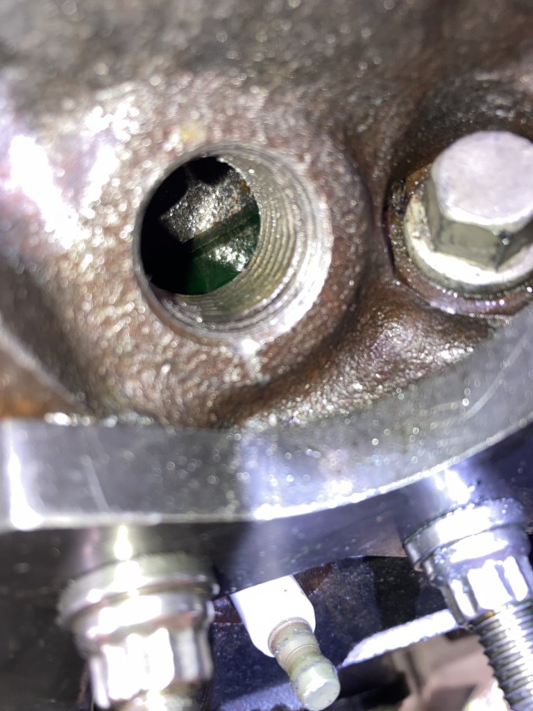

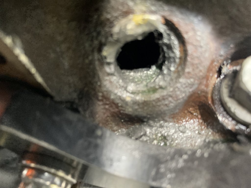

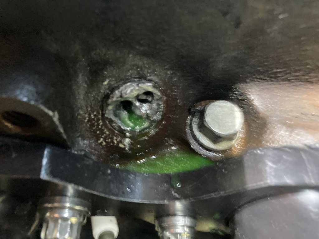

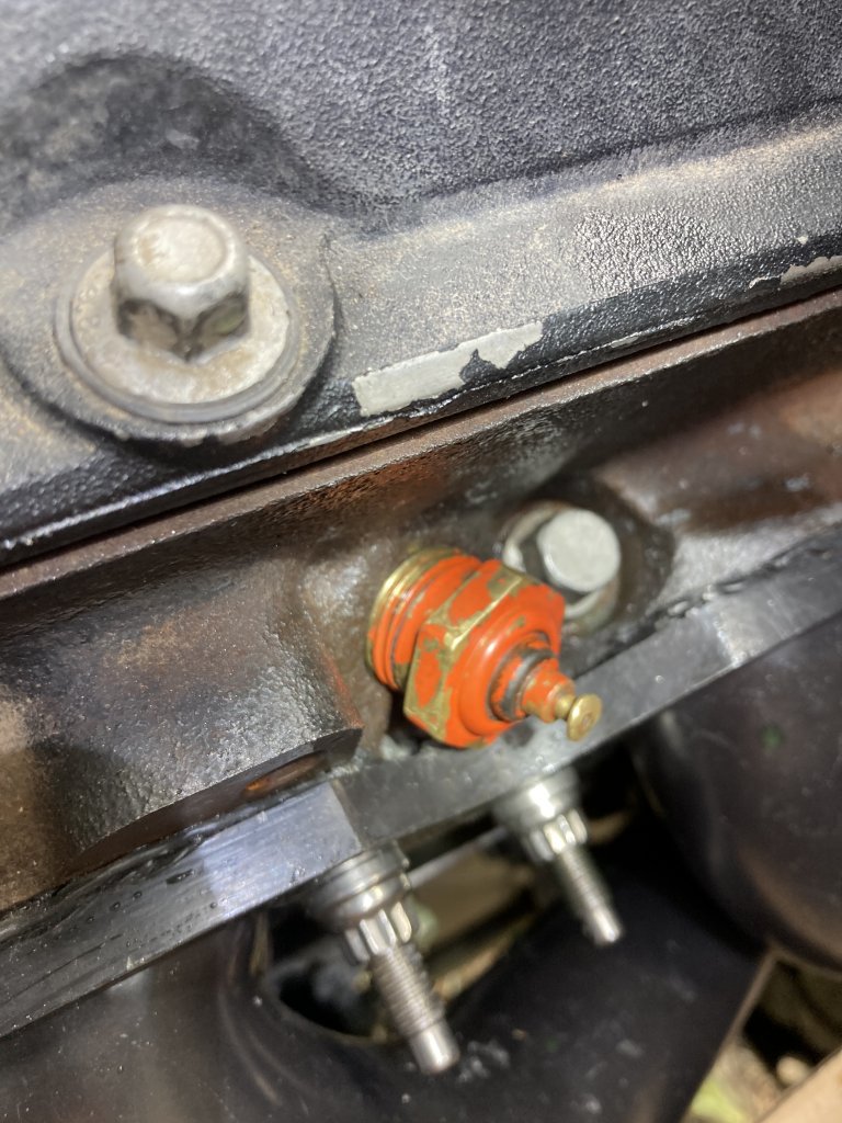

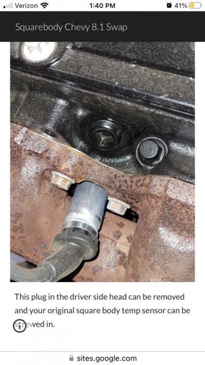

Damn coolant plug broke on me. Took a few days but finally got the threads clean enough to install the squarebody coolant sensor

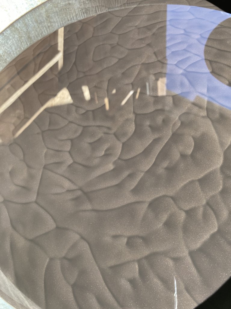

I got the exhaust fixed today. Had about a 30 mile drive back to my house. Maybe 10 miles from home and the engine starting making a knocking sound. I had double checked everything before driving and nothing seemed wrong. Never got hot and had good oil pressure. I drained the oil when I got home and it doesn’t look good.
not knowing an 8.1, but you couldn't use a 3 wire camaro sensor for the gauge and the ECM signal? They might be threaded differently than a 5.3....dunno.
...and you may have answered this already previously, sorry if you did.
Lu Blunt
Jun 6, 2016
223
231
Rye, CO
Luke
350ci
I’m not familiar with the 3 wire camaro sensor. Sounds like its similar to the oem 8.1 sensor. The 8.1 uses a three wire temperature sensor located on the passenger side head. Two of the wires go to the ECM. The third is not used from the factory but supports a temperature gauge and you can use that third wire for the square body gauge. Around 79-81 the resistance values that the temperature gauge uses changed from one value to another. The later model gauge is the one that uses the correct value for the factory 8.1 third wire from the temperature sensor.
I thought it would be cool to use the squarebodys temp sensor but if I’d known the plug would be such a problem to remove I would have tried the using the 3rd wire from 8.1 sensor.

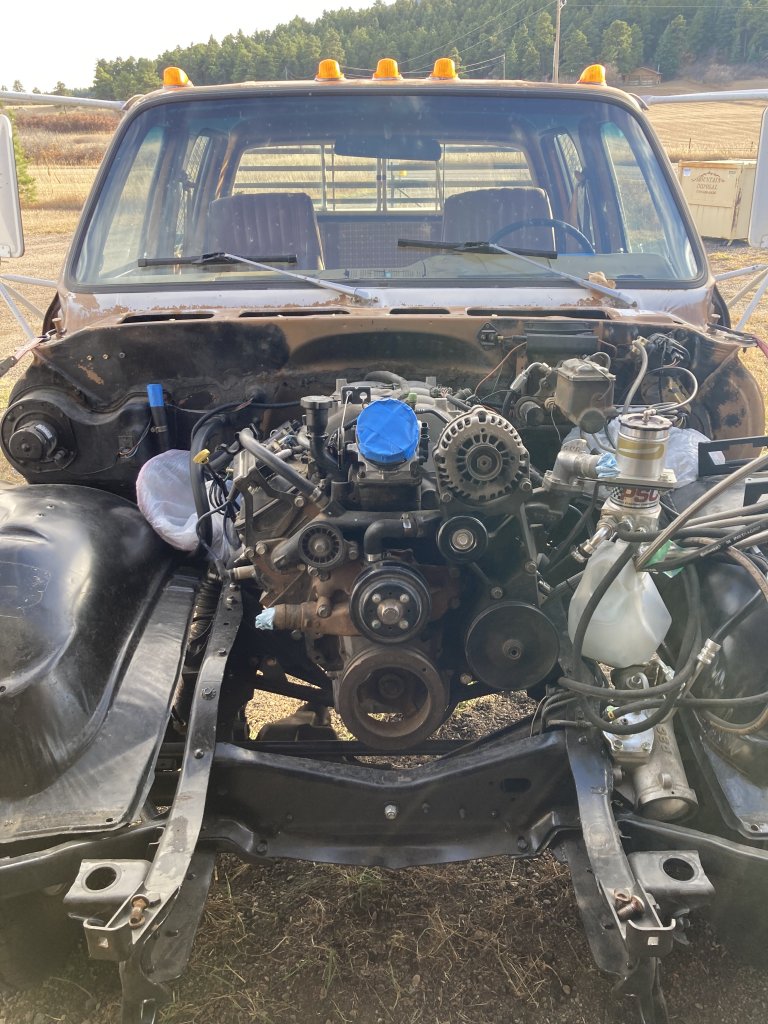

Weather was nice the last couple days and I was able to make some progress on the dually. Drained fluids, removed driveshafts and t-case. Front end taken apart. Next step is remove trans and pull the 8.1
