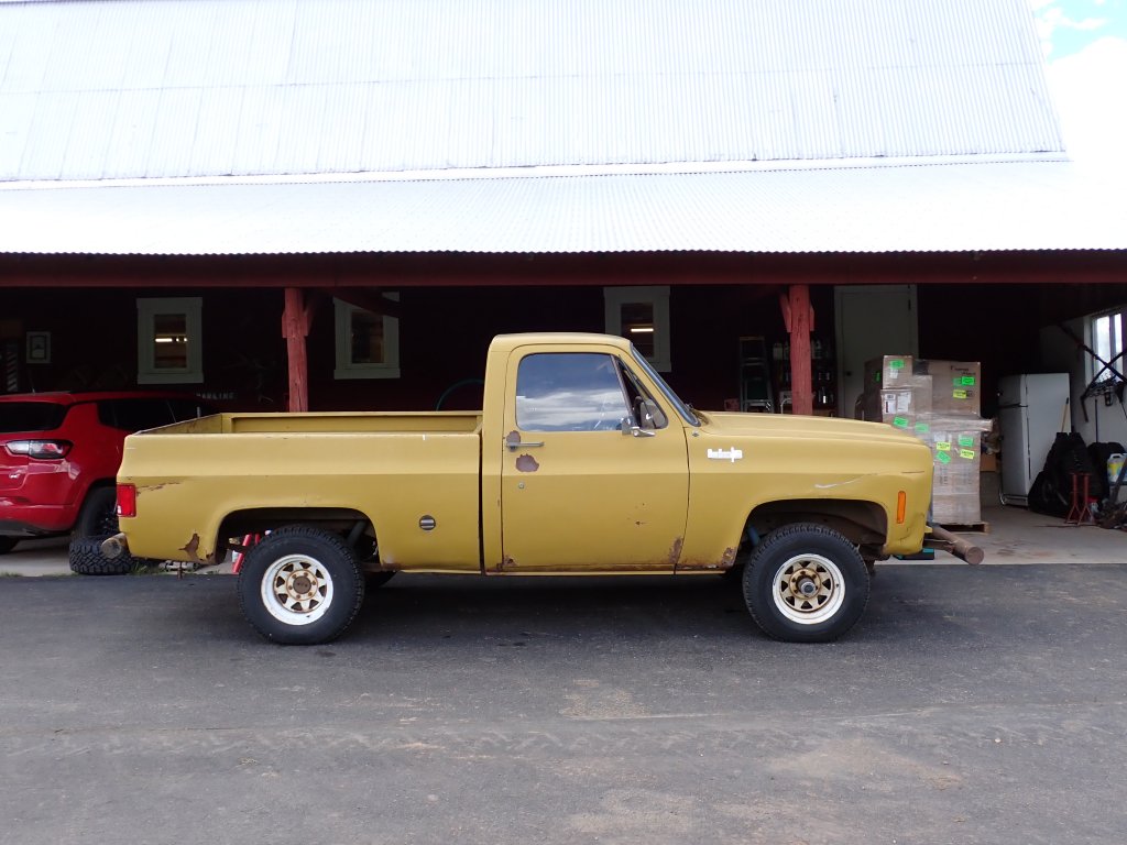

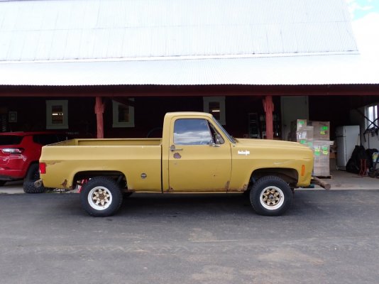

A bit about the truck: My grandpa bought it new in 1972 and it's pretty much been beat to **** since then. Nowadays it's a ranch truck and plow truck in the winter (we live at 8000ft in Colorado, there's usually a fair bit of snow, just mud this winter though...) I come from a Toyota background, and took some interest in making this truck work a little better when it turned 50 back in early 2023. I replaced a couple missing lug studs, fixed the windshield washer pump, replaced a tail light, and then, fatefully, decided it should have a spare tire. And that it should be 33". Then we got four more wheels and tires.

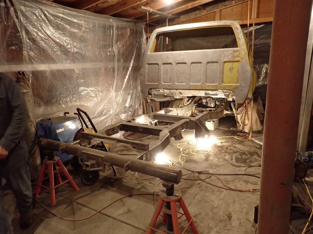

Before long the truck was up on jack stands taking up half of my shop. I'm more interested in function than form, and would have been happy fixing the leaky drivetrain and with some minor frame work to make the 33" spare fit up under the bed. My granddad wanted to get some new body panels, and it just kept snowballing.

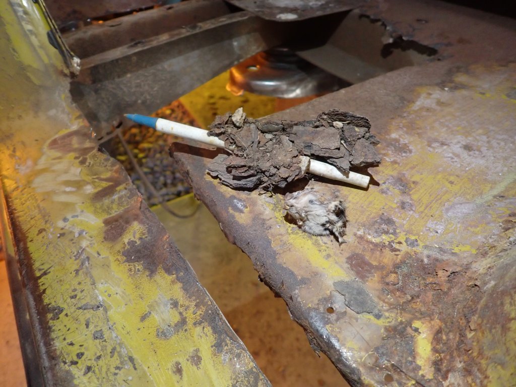

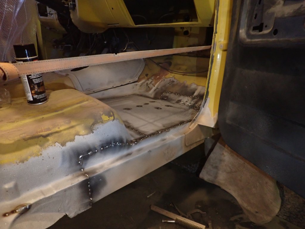

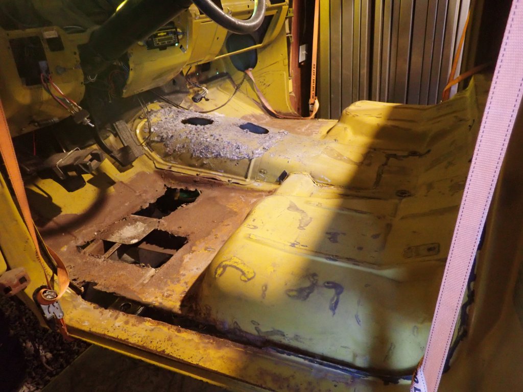

I fixed the rusty rocker panels and cab corners, sandblasted and epoxy primed the cab, and we took it to a local body shop for paint. They did an excellent job of justifying my proclivity towards doing all of my own work and mistrust towards most body/auto shops. It came back looking nice enough, but with loose bolts, missing parts, wiring all sorts of disconnected and misconnected, vacuum hoses hooked up wrong, a botched windshield install, poorly adhered paint... This was in mid 2024, and prompted really going through everything.
