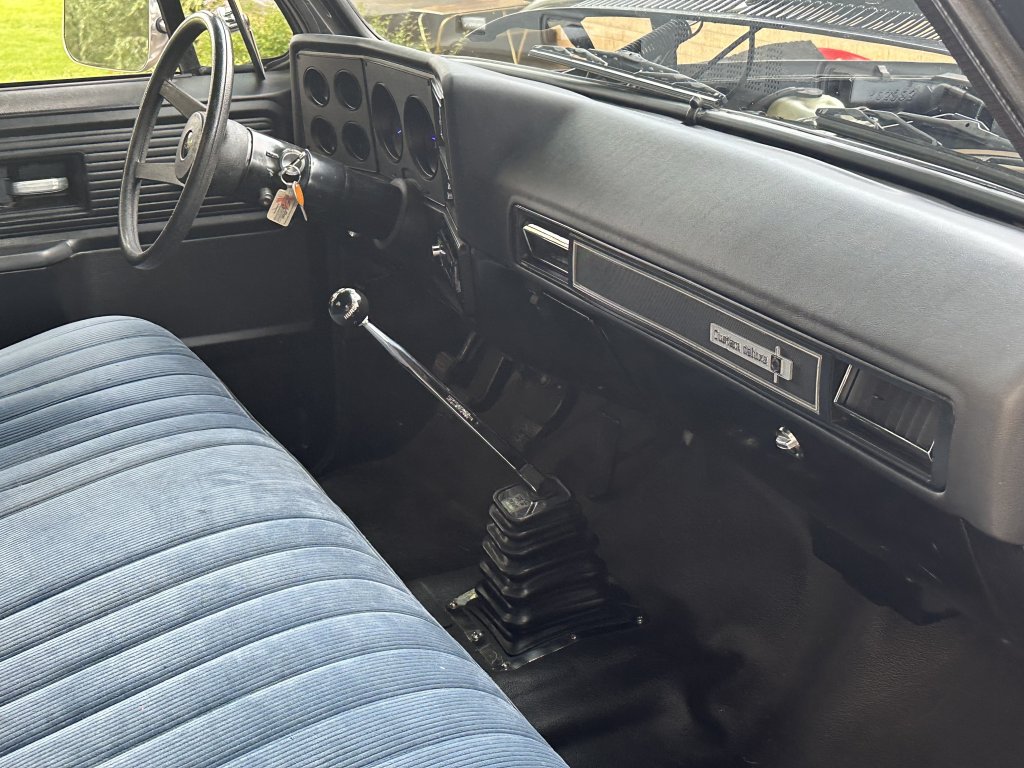

Not 4 wheel drive but I put an nv3500 into a 1980. Used the flywheel that was on the 93 305 it was mounted to originally. I also used a new master/slave hydraulic system from that same year. That might just bolt up your you existing clutch bracket..

What shifter setup is that? Looks like a Hurst?
