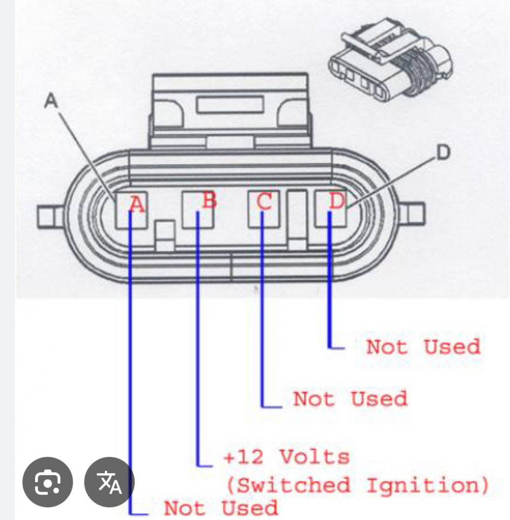

Regarding the wiring, I have the distributor, oil pressure and sending units figured out. I am not familiar with the 4-wire alternator, and I don't have the pigtail for it so anyone know what I should be buying to get the alternator up? The A/C we are going to leave idle. The cab in this 86 K10 did not have A/C so that will have to come later.
