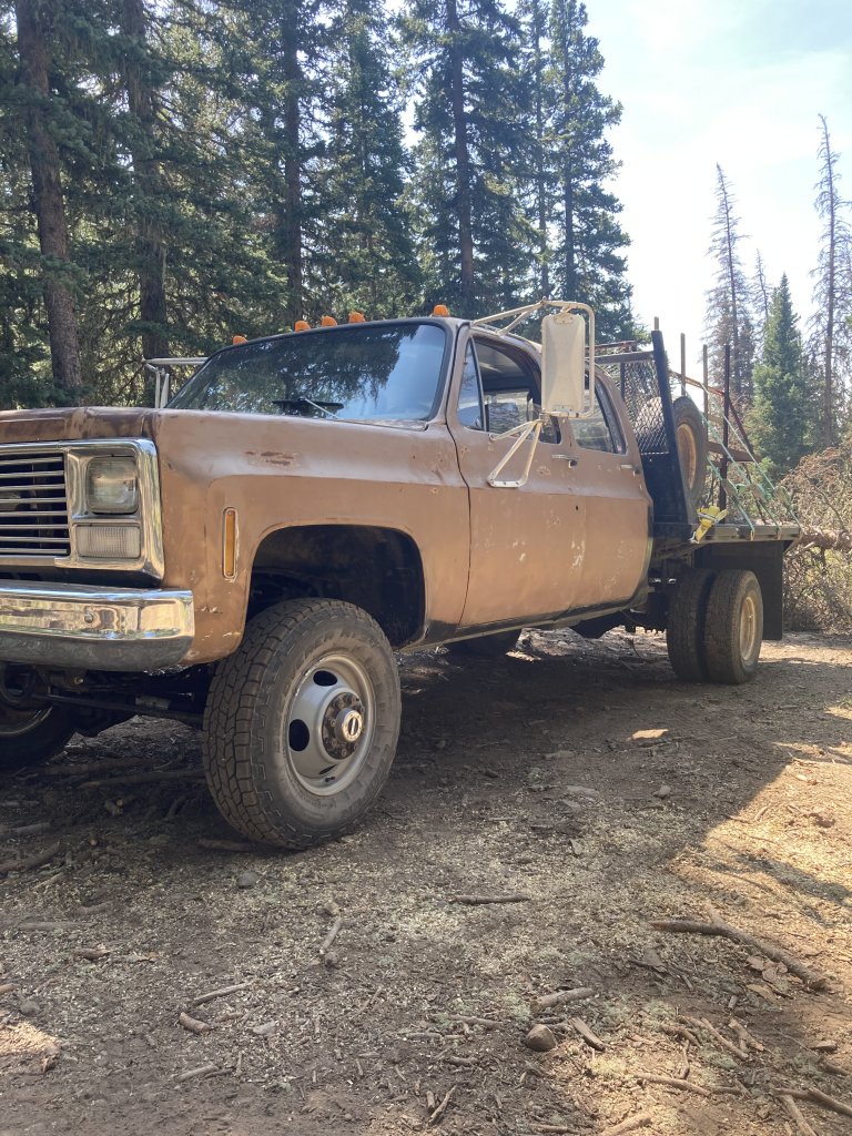

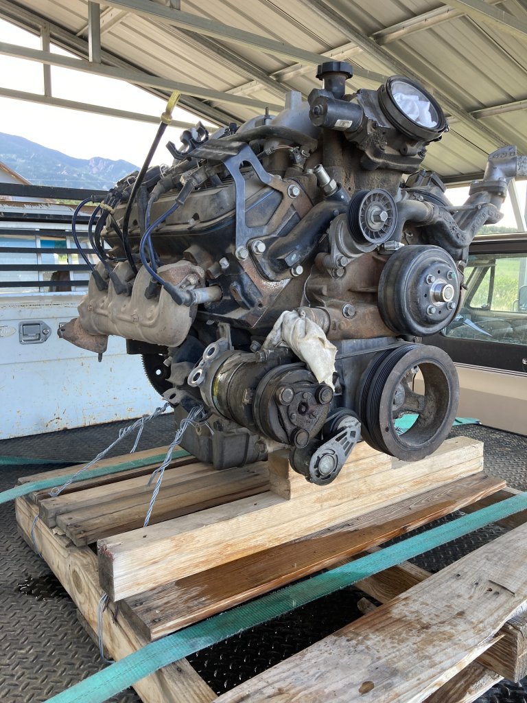

Recently found an 8.1 vortec for a good price. Wanting to swap it into my 1979 k30 with 350/sm465/np205. I’m still doing research and collecting parts. Id appreciate any recommendations for a shop in Colorado to help with the swap.

As far as I know the 8.1 vortec uses the 502bbc block which is based on the 454 big block, not LS* based. 8.1L is 496ci and no LS based block can be bored and stroked to that large of a displacement. 8.1L uses normal sbc/bbc engine mounts and bellhousing bolt pattern
The 8.1L should mate to the SM465 no problem. Use an 8.1L manual flywheel and pilot bearing with my current clutch setup. Ive read you have to open the pressure plate mounting holes just a tad to allow for the larger metric pressure plate to flywheel bolts to pass through as well as remove the two dowel pins from the flywheel. The 8.1L also clears the ORD HD engine crossmember so that’s what I’ll be using.
My 79’ k30 is non-ac so no need to keep the ac compressor. Also read the stock 8.1L exhaust manifolds wont clear the frame but you can use any 454 manifold/headers

The 8.1L is totally different than the Gen VI and older BBC engines. It shares almost nothing and you can't use standard BBC parts on it. Head bolt pattern is different, intake bolt patterns are different, crank is different. It IS NOT based on the Gen VI 502 block. It is a Gen VII BBC and you can basically only get performance parts from one or two different manufacturers, and they are VERY expensive. About the only things that will bolt directly on from old BBC engines are the exhaust and starter. It DOES have the standard chevy bellhousing pattern as well. If you are leaving it stock, that's not really a problem. But if you want to do any modifications you are basically stuck with Raylar engineering https://www.raylarengineering.com/. They have an entire section on engine swaps of the 8.1L into older cars. https://www.raylarengineering.com/vortec-8100-engine-swaps.html
It DOES NOT use the standard SBC/BBC engine mounts. They are basically LS style motor mounts and you will need an adapter to fit to older clamshell mounts. https://www.skspeed.com/dirty-dingo...otor-mounts-gm-8-1l-496-bbc-to-3-bolt-mounts/
