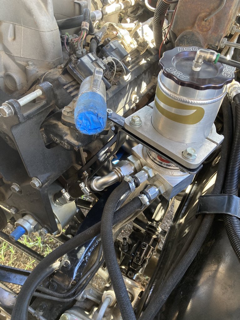

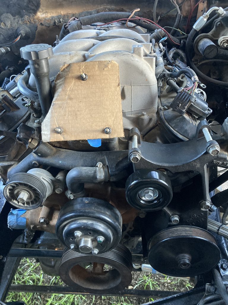

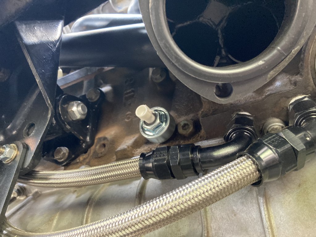

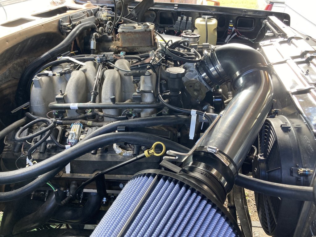

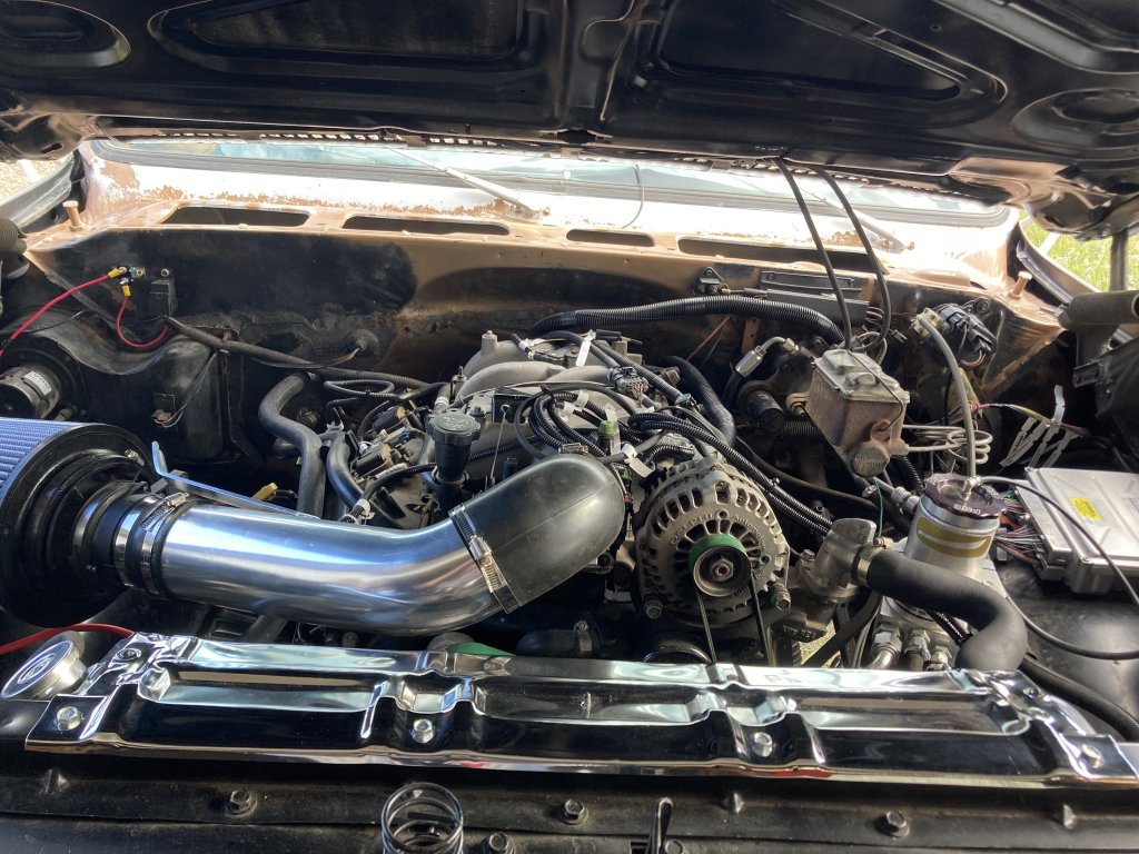

I got the headers installed but I need to relocate drivers knock sensor. I’m trying to find a knock sensor with smaller threads so I can use a different hole on the side of the block. New spark plugs installed. I made brackets and mounted the oil cooler, power steering cooler and psc external reservoir. Also made hoses for the oil cooler. Pressed the 8.1 pulley onto the psc power steering pump. Oil changed with new filter. Filled trans and tcase with new gear oil. I will need to source a different oil fill tube or modify the current one inorder to clear the throttle cable. Installed cold case radiator but still need to get longer heater core hoses and new radiator hoses. Headlights, new grille and trim installed.
The knock sensor can be omitted for the time being and you won’t have as much ignition advance. Are you only equipped with one knock sensor or two? Factory calibration?

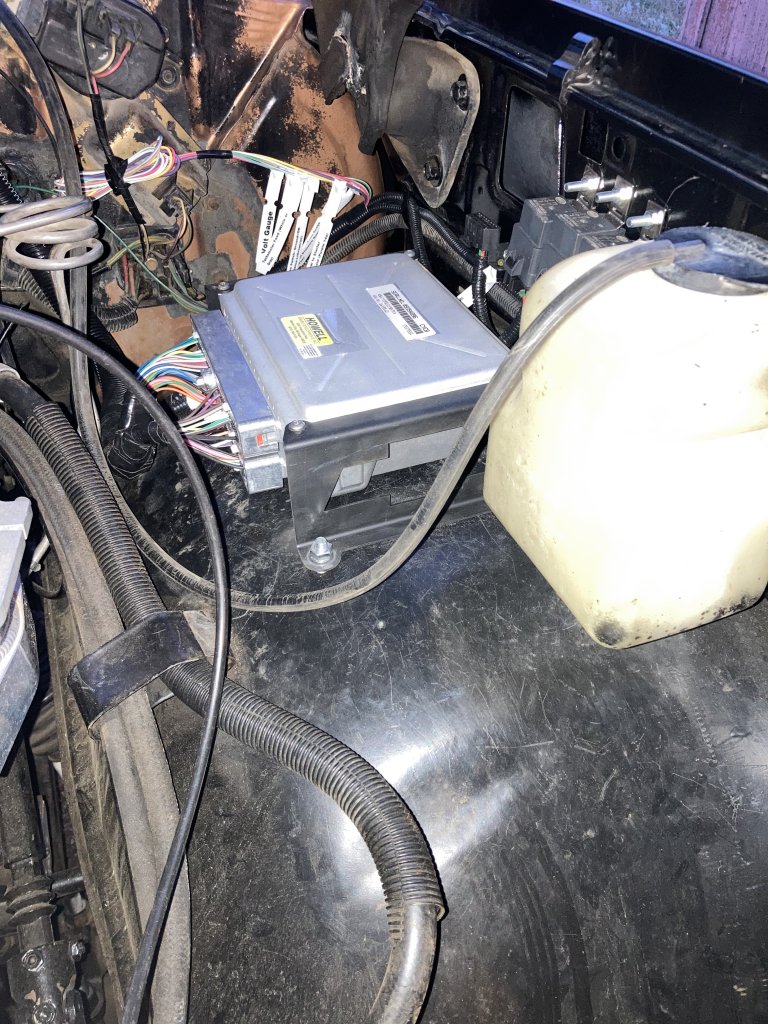

Can I see your power steering reservoir

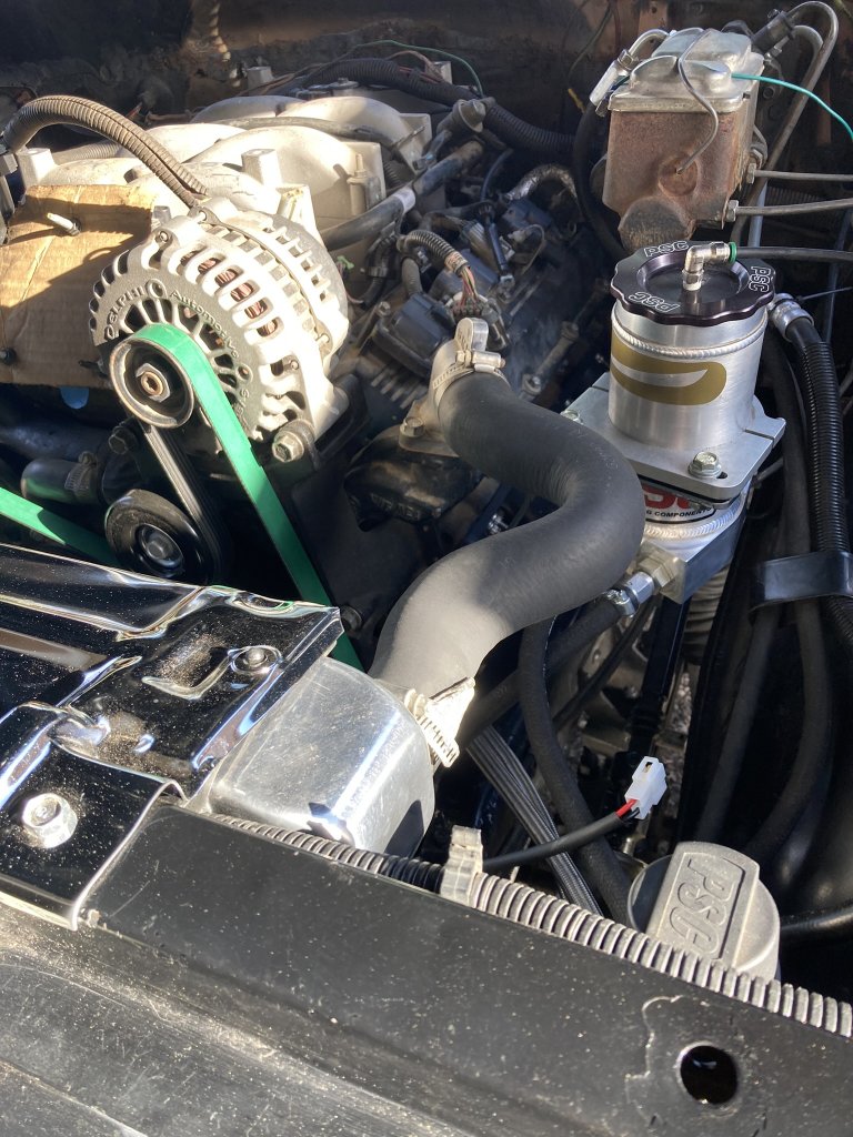

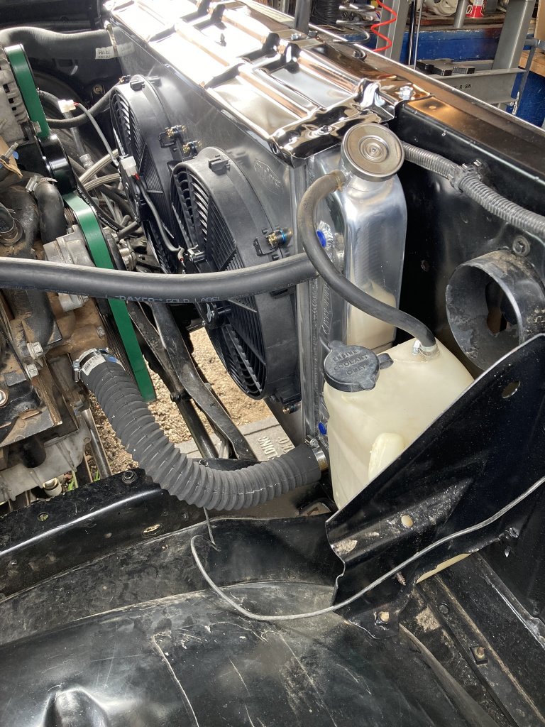

I installed new radiator hoses, new heater hoses and found a knock sensor that I can relocate to another hole on the side of the block

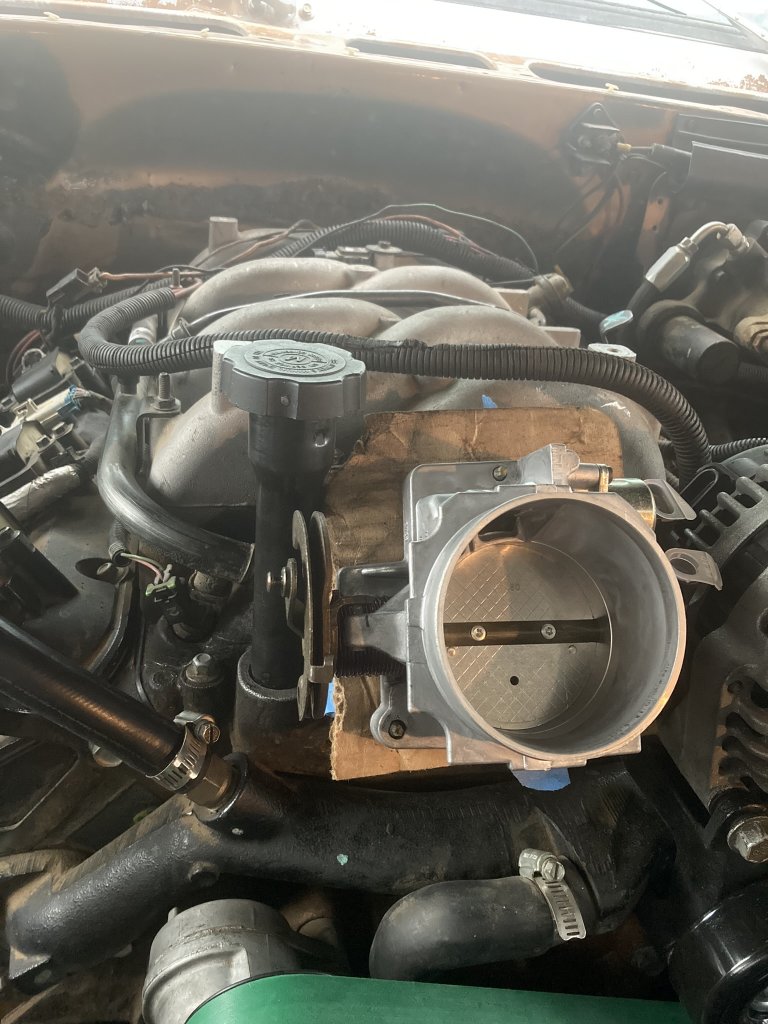

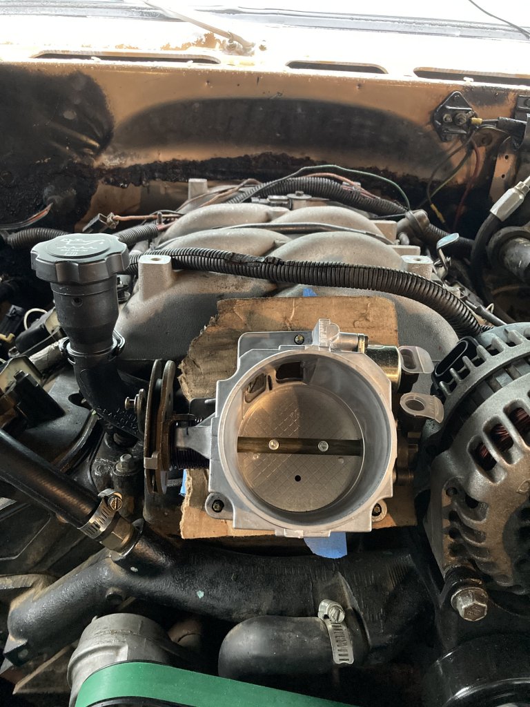

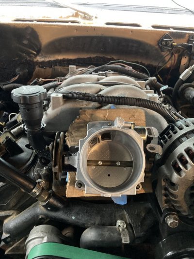

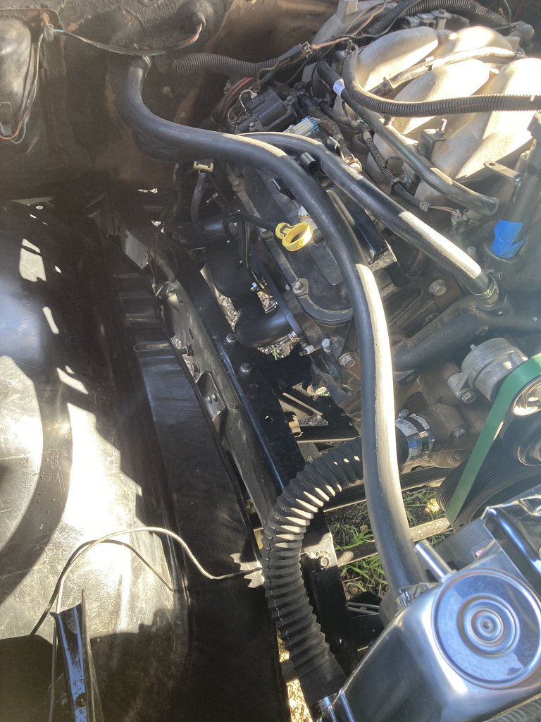

Also finally tracked down the discontinued S shaped oil filler tube that’s needed to clear the dbc throttle body
I like your fab work on top of the cold case radiator to fill that gap, I have the same issue I am trying to solve. I bought the same one and, this is a rare case where I am really impressed with the fabrication quality of a product. Cold Case Radiators are expensive, but once the bill is paid you are really happy that you have something of this quality keeping things at temp.

@Broken85 I didn’t have to fab anything to fit the larger radiator. I bought new insulators and top plate. My radiator support doesn’t have threaded holes for the top plate so used longer bolts with nuts.
Cold Case Radiators GMT556A21SK Aluminum Performance Radiator with Dual 14 in. Fans 1977-1987 GM C/K Pickup [21 in. Height]​
Prothane Radiator Insulators 1968-87 GM Big Block​
Part # 7-1712-BL​
Spectre Radiator Support Panel 1973-80 GM Trucks Part # 4366​

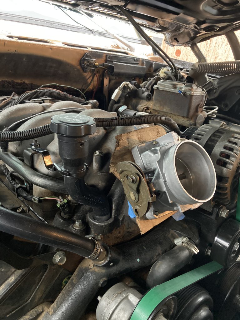

The truck starts and runs. I’ll work on posting a link to a video of it running. Just finishing up the little things now. Gauges are working and I should be in the exhaust shop this week. hopefully it’ll be road ready by the weekend
Can I ask what cold air intake tubing that is and it's size?
Lu Blunt
Jun 6, 2016
222
231
Rye, CO
Luke
350ci
@hoagster I’m using the gmt800 cold air intake from speed engineering. It’s 4” tubing with 6” filter. They also make some universal ls swap air intake kits. I had this setup on a parts truck in my yard and other than my throttle body being 3.5” the intake fit no problem.

Awesome thanks, been looking for awhile and your setup is perfect I want to use the original battery location to box it in!
