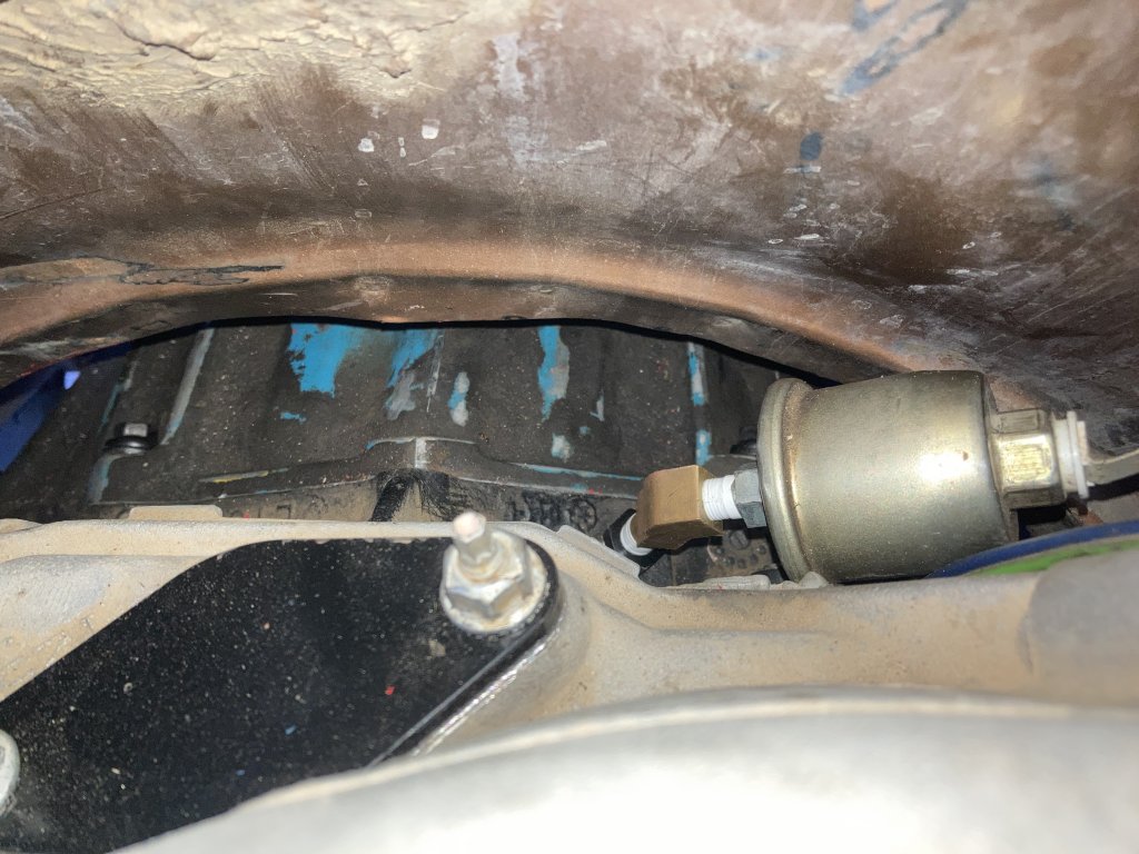

The space between the 8.1 and the firewall is tight but not impossible. To me it looks easier to replace crank sensor in the squarebody than a gmt800. I installed a new acdelco crank sensor with anti seize while the engine was out. Also did egr delete and adapted the oil pressure sensor to use the squarebody sensor and gauge

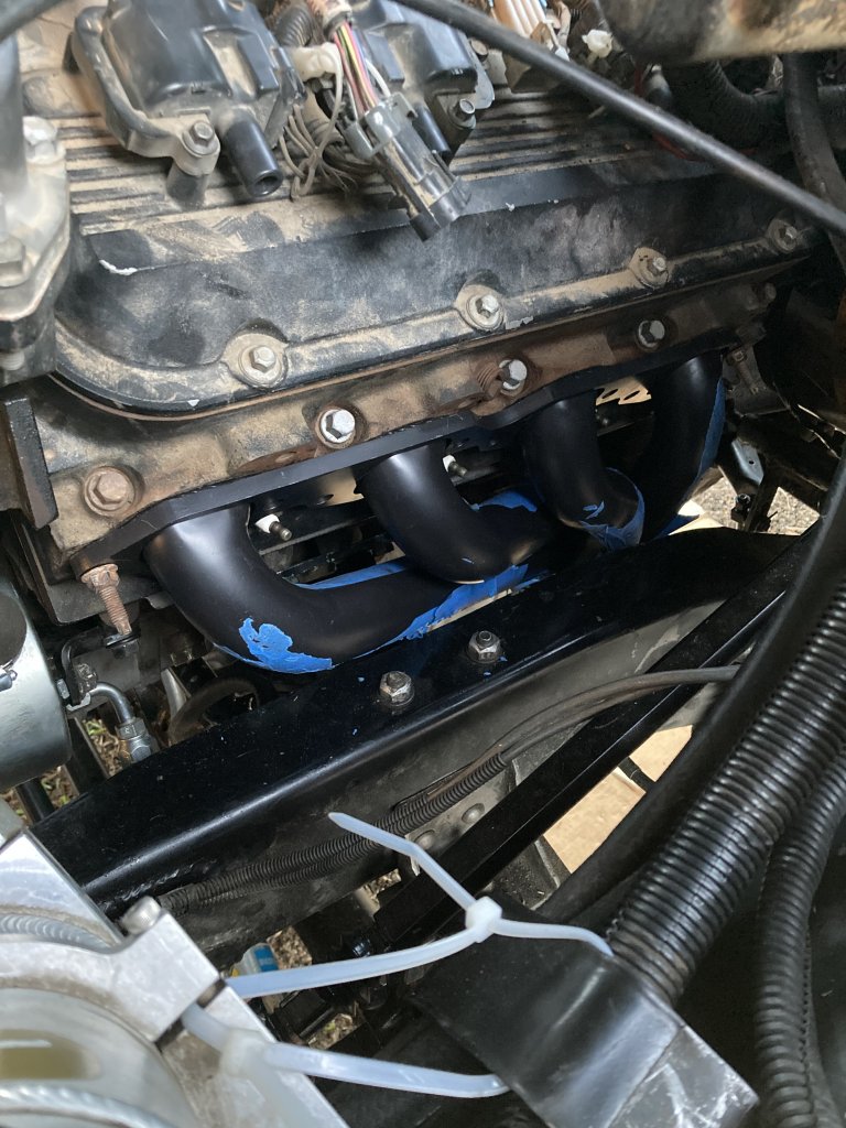

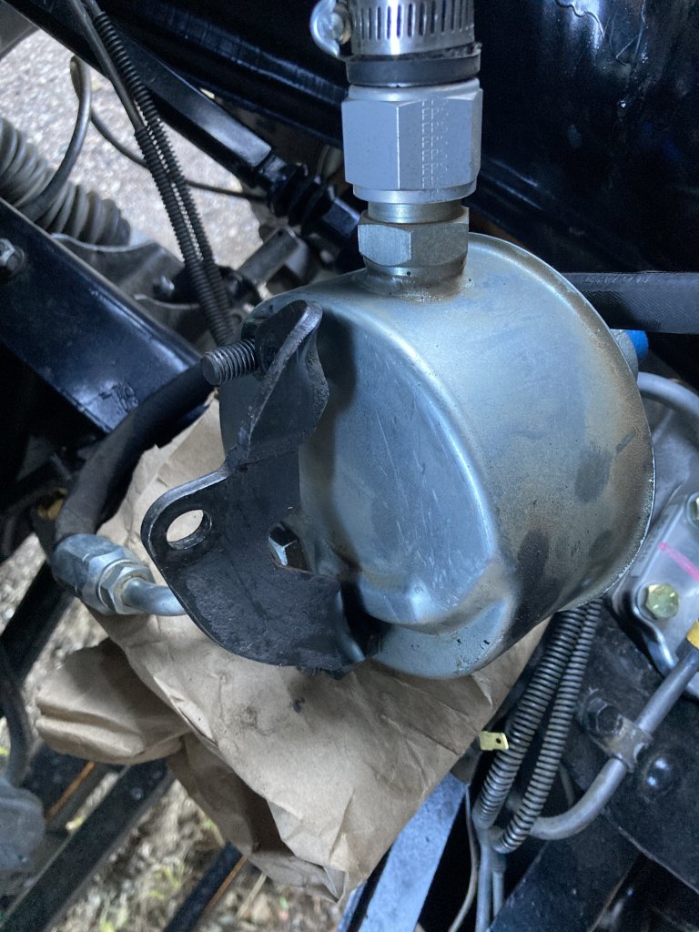

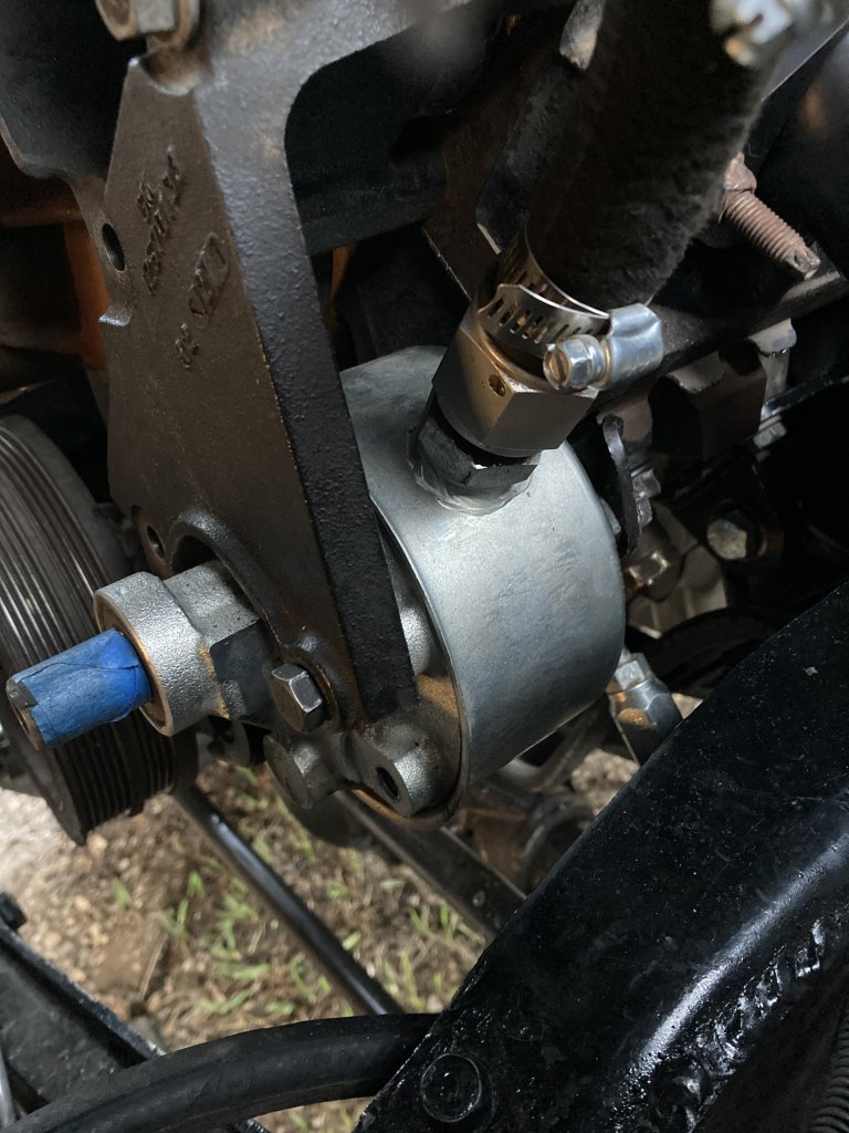

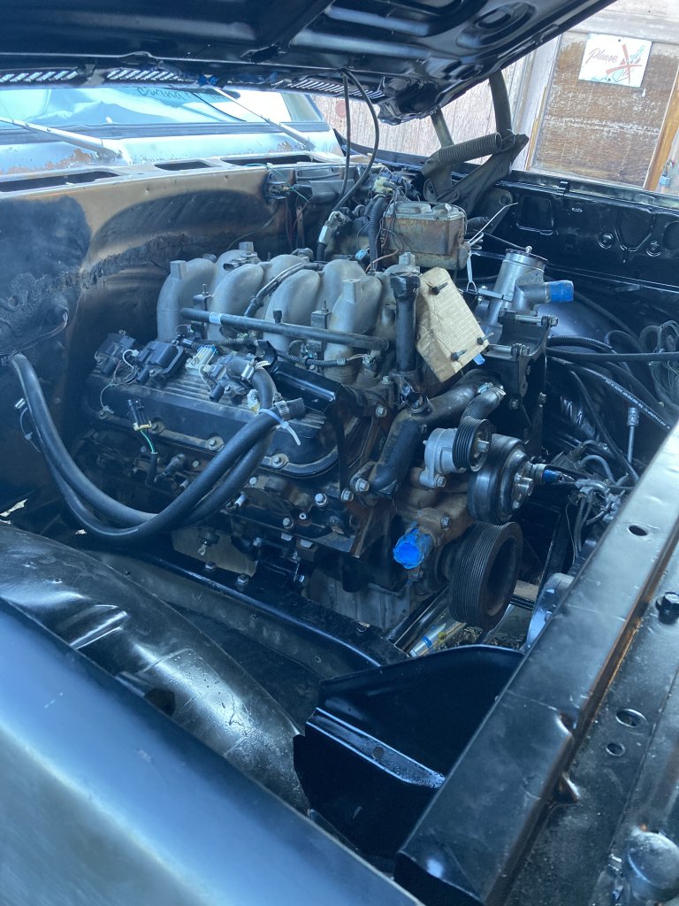

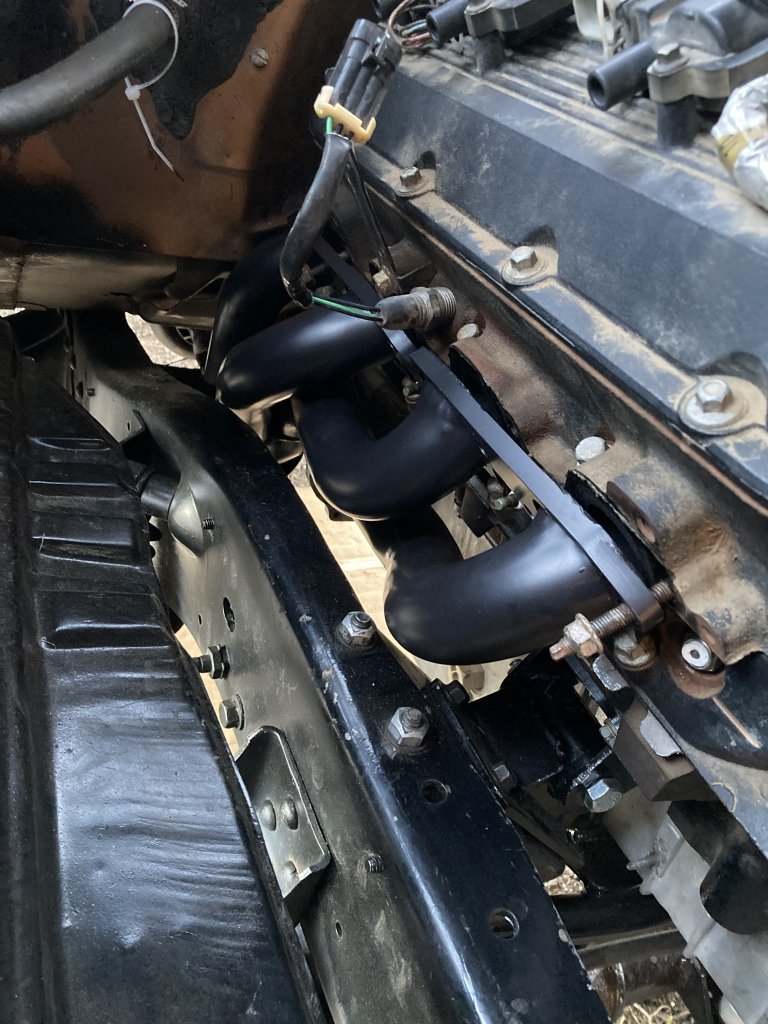

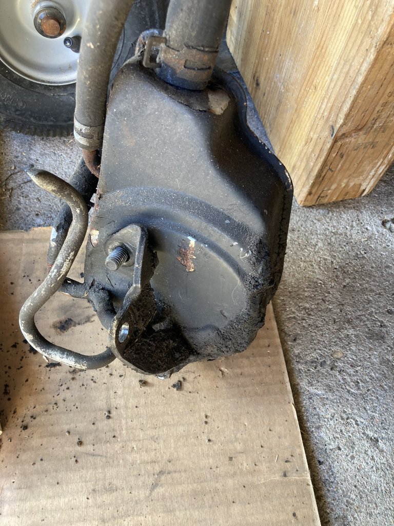

I was able use my psc power steering pump with the 2500hd alternator bracket. The 8.1 oem power steering pump uses three bolts on the face and an extra bracket in the back. I swapped the studs and bracket from the oem pump onto the psc no problems. Also got the Sanderson bb-8 headers test fitted with no problems except the driver side knock sensor is real close to the headers.
