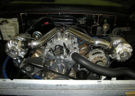

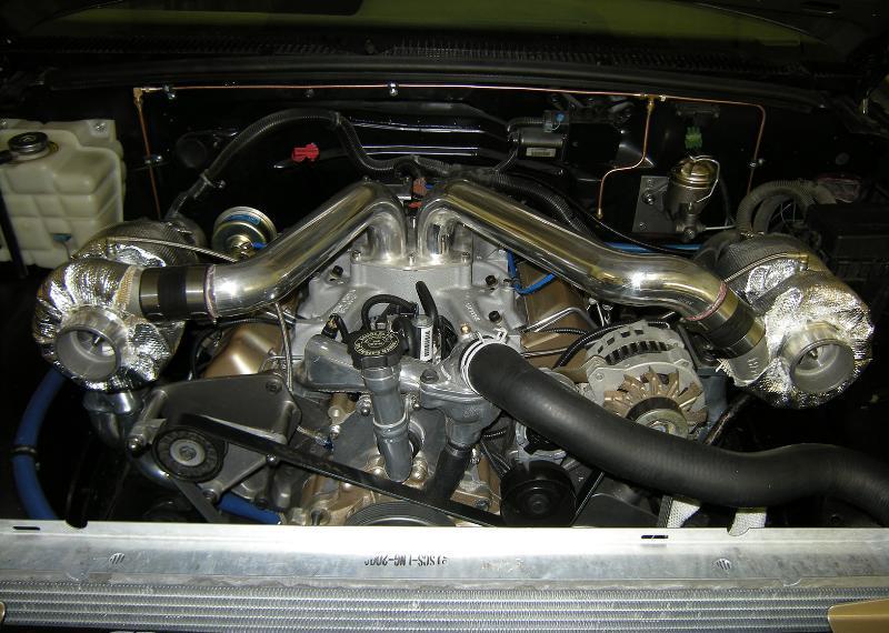

My best friend growing up had one in his 73 Nova with twin chinese 80mm turbo's on it and a blow through carb. He ended up upgrading to Sniper EFI and then pulled the whole thing for an LT4/8L80e combo from Chevrolet performance because it wasn't reliable or daily drivable. He gets double the fuel mileage and much more usable power from the supercharged 6.2L. The 8.1L was a monster and super fun to drive, but he broke it a lot and it was hard to get parts and they were pricy.

Here’s the nova with the twin turbos and 8.1l
And then here it is with the LT4

That's what I'm talking about !
It's one of them things. It's a dedicated punisher that you constantly dump money in lol
Such a waste, but so much fun, which is why I said, it's for gaptizing coyotes in a truck. lol
