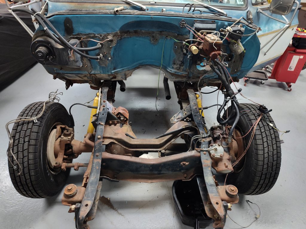

454 Engine, SM465 trans and NP205 are out & sold.. Im fully committed now
