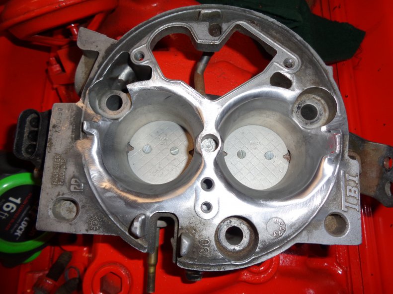

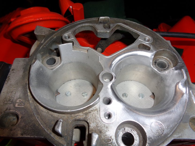

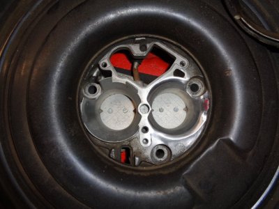

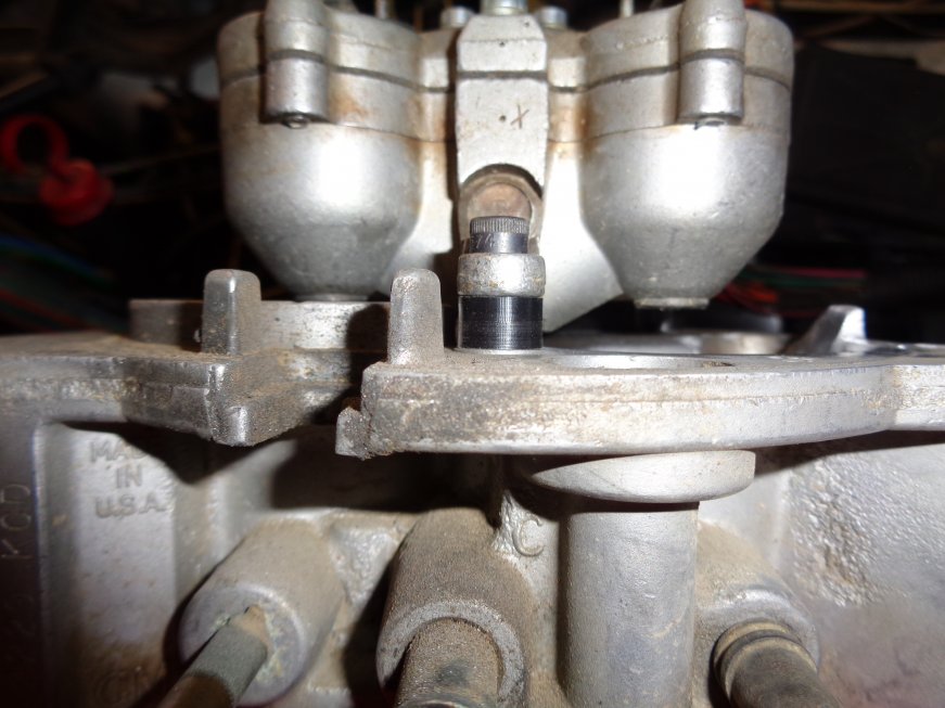

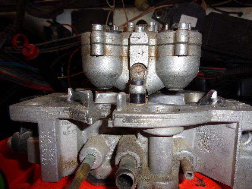

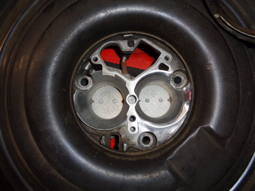

got my throttle body modified for better air flow and put on a injector spacer
probably going to get a hypertech power charger and a spacer for under the tbi
if you do this mod to your tbi leave a little on the side to hold the air breather. you can see in my pics what I'm talking about

I have a stock pile of tbi parts I did not buy anything for this its all stuff I already had.
it just took a few minutes to grind down the edges
