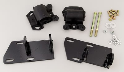

Oct 30, 2014 #31 Swims350 Full Access Member Joined Jul 30, 2010 Posts 4,361 Reaction score 833 Location Logan WV First Name Chris Truck Year 1983 Truck Model K10 Engine Size none what do the v8 mounts look like you are going to use?
Oct 30, 2014 #32 kleedus Full Access Member Joined Jan 25, 2012 Posts 1,726 Reaction score 176 Location wyo First Name Ray Truck Year 1960 threw 91 Truck Model c10 to k30 Engine Size 350 threw 454 I used the transdapt mounts that use the 2.8 motor mount http://www.tdperformance.com/images/ePIM/original/9906-9926.pdf do not use any mounts that use the 4.3 mount they are week both my original 4.3 mounts were bad when I pulled it out Attachments 9906_1.jpg 16.7 KB · Views: 175 Last edited: Oct 30, 2014

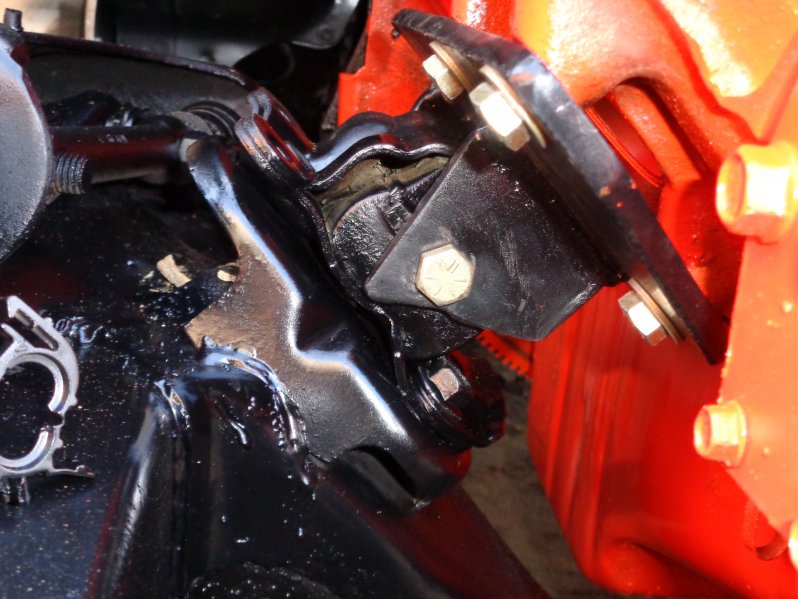

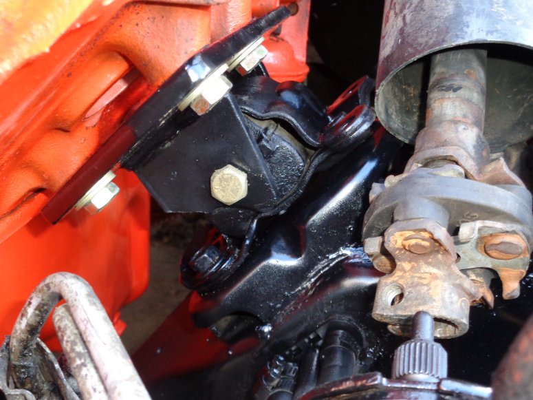

Oct 30, 2014 #34 kleedus Full Access Member Joined Jan 25, 2012 Posts 1,726 Reaction score 176 Location wyo First Name Ray Truck Year 1960 threw 91 Truck Model c10 to k30 Engine Size 350 threw 454 I got off easy the blazers have a raised pad the motor mount bolts to easy removal

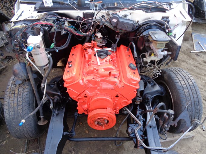

Oct 30, 2014 #37 kleedus Full Access Member Joined Jan 25, 2012 Posts 1,726 Reaction score 176 Location wyo First Name Ray Truck Year 1960 threw 91 Truck Model c10 to k30 Engine Size 350 threw 454 its stabbed in Attachments 001.jpg 96.9 KB · Views: 121 002.jpg 98.8 KB · Views: 127 009.jpg 100.1 KB · Views: 126 010.jpg 95 KB · Views: 118 011.jpg 93.6 KB · Views: 118
Oct 30, 2014 #38 Swims350 Full Access Member Joined Jul 30, 2010 Posts 4,361 Reaction score 833 Location Logan WV First Name Chris Truck Year 1983 Truck Model K10 Engine Size none I see exactly what you mean above them being raised, great way to show what you said man very easy for you.
Oct 30, 2014 #39 kleedus Full Access Member Joined Jan 25, 2012 Posts 1,726 Reaction score 176 Location wyo First Name Ray Truck Year 1960 threw 91 Truck Model c10 to k30 Engine Size 350 threw 454 and the nuts are factory welded to the raised mount these mounts are the same height as the 4.3 mounts were so my engine sits in the same place just a bit longer on the front
