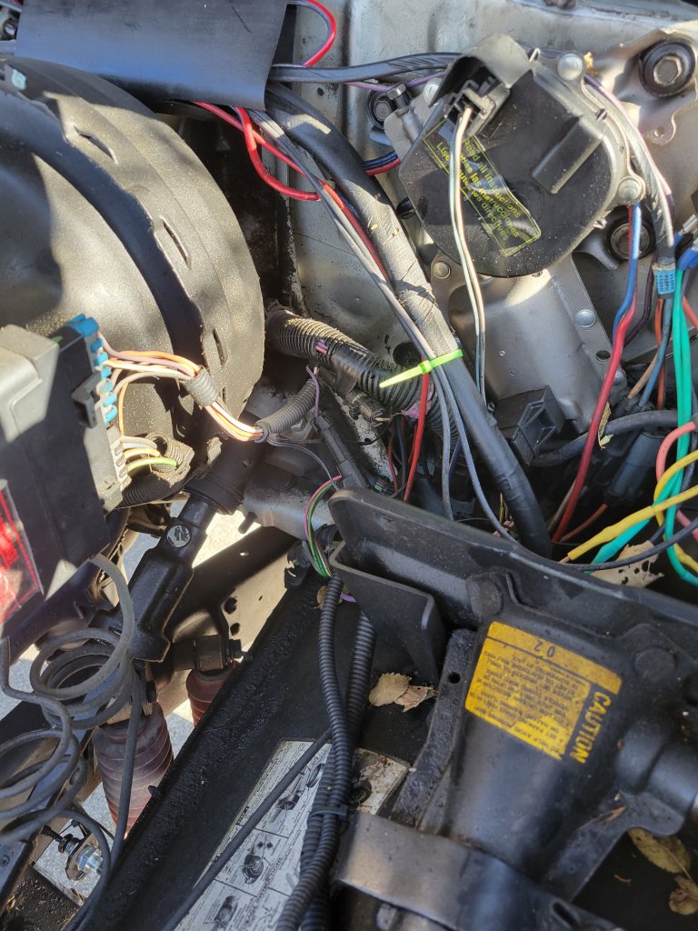

I’ll do it once I can find that plug you said to unplug… I still have no found it nor a tan wire. What is the wire coming from? These are photos of all the plug near and around the firewall/distributor area.

@gmbellew can you provide more information of this plug in looking for? Perhaps a photo of its location?

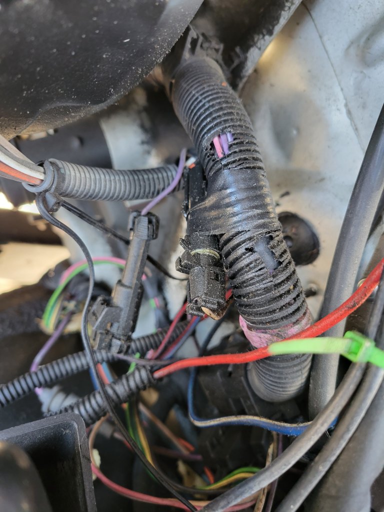

could be a little different on your 87, but it is in the middle of both of these photos on my 90. taped to the main wire loom.

Just found two plugs on base of distributor. One is two wires pink and white? And goes up to ignition module I believe. And the other appears to be 4 wires

Bazinga! Under the clutch master cylinder.

Quit confusing him. The issue isn't that it was at 8BTDC when the guy checked it. The issue is that the guy checked it(and maybe moved it) without the ESC being disabled. There is no telling where the MECHANICAL advance is set at. The Mechanical advance should be set at 0, the ECM will then adjust the timing to where it needs to be.
You cant get the thing running right as it is, so don't try getting fancy and making "performance" changes outside the scope of the published procedure.
My guess is that the IAC valve is totally ***** and that is your problem. I would still check the timing though, because that will definitely cause some drivability issues and you have no idea what anyone might have done to the truck previously. Your pic of the connector looks like it hasn't been touched in a VERY long time.
