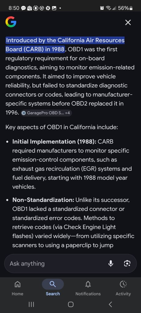

Early stuff was proprietary GM had cccs,Ford had EEC then in 1988 California said hey we need to standardize this so any garage can work on anything. So OBD1 was officially born in California for the 1991 model year. Then the rest of the United States said hey that was a good idea and OBD2 was born for the 1995 model year. GM if you look in the service manual on cars through 90 they say ALDL assembly line data link not OBD port. Naturally people started calling anything that wasn't OBD2, OBD1 by default, but that is inaccurate. And you might buy an OBD1 scanner and it will work on a 1992 model something,but it won't work on an 80s GM product. There are scanners that have specialty programs or cartridges to read early Ford,Chrysler,GM but they are reading manufacturer specific protocol no OBD1.
I had a few things wrong,here's probably better more accurate info. I was justbworking from old memory.

Early stuff was proprietary GM had cccs,Ford had EEC then in 1988 California said hey we need to standardize this so any garage can work on anything. So OBD1 was officially born in California for the 1991 model year. Then the rest of the United States said hey that was a good idea and OBD2 was born for the 1995 model year. GM if you look in the service manual on cars through 90 they say ALDL assembly line data link not OBD port. Naturally people started calling anything that wasn't OBD2 OBD1 but that is inaccurate. And you might buy an OBD1 scanner and it will work on a 1992 model something,but it won't work on an 80s GM product. There are scanners that have specialty programs or cartridges to read early Ford,Chrysler,GM but they are reading manufacturer specific protocol no OBD1.
