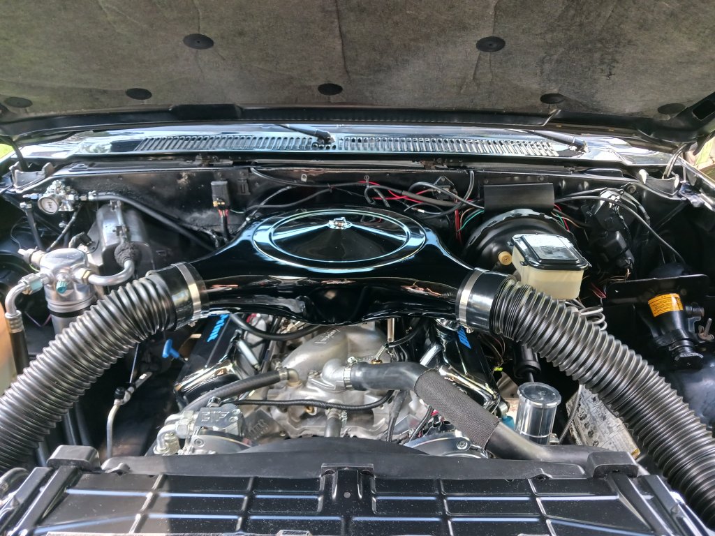

I agree, but I did not change the switch until about halfway through the process. It is out of the garage and running. First time in over a month. Thanks again to all who helped.
