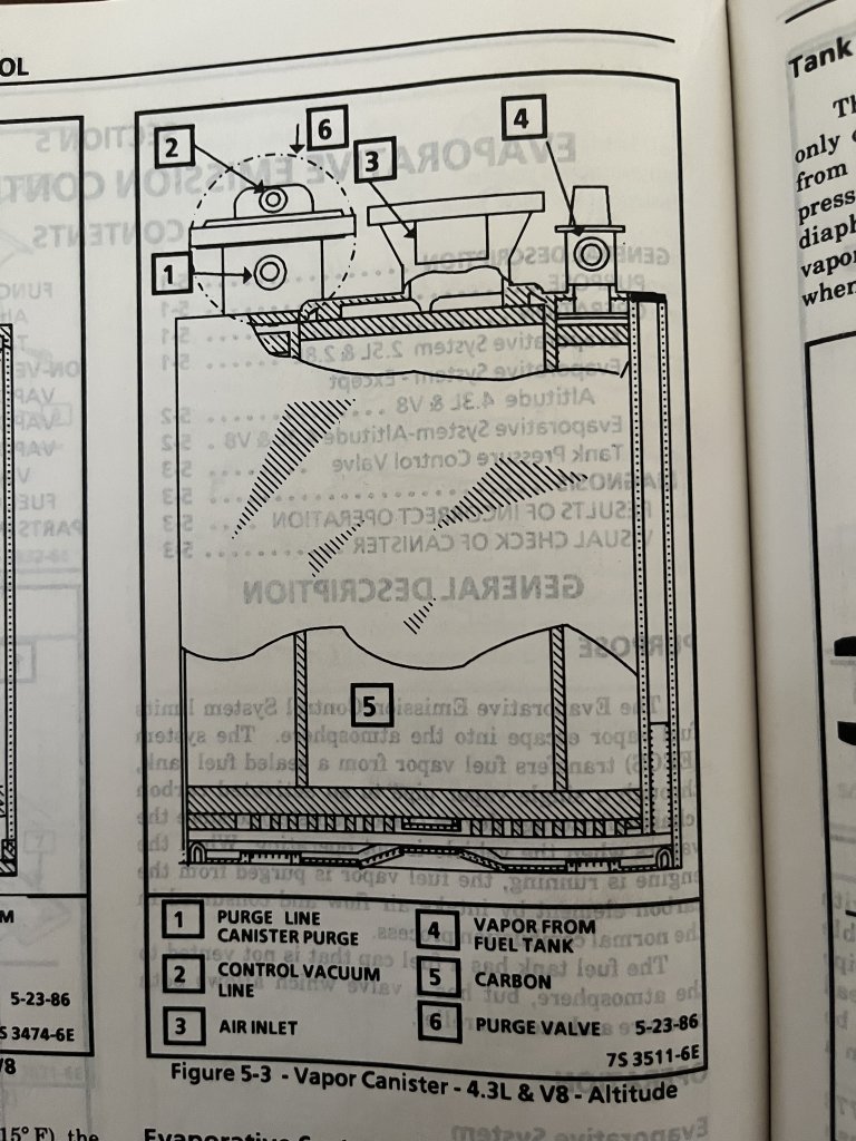

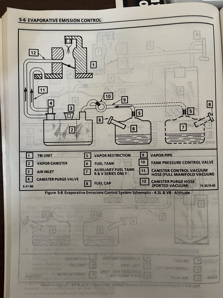

So I solved this problem not too long ago and just remembered that I’d made a thread about it so here’s what the problem ended up being and how I solved it.
My truck, when new, was sold with RPO NA6 “High Altitude Emissions Equipment”. From what I can see, that means a slightly more complicated EVAP system. Instead of just having a purge valve on the charcoal canister it has a second valve on the vent line just ahead of the tank selector solenoid. With everything hooked up and correct, anytime vacuum is applied, that “tank pressure control valve” opens, allowing vapors to pass through the charcoal canister and on into the TBI.
Anyway, so the gas caps I replaced weren’t just worn out. They had a tiny hole drilled into each so the tanks would vent from the cap. Also, I didn’t know that a previous owner had disconnected the hose to the “tank pressure control valve” and left it loose. What this meant is that whenever vacuum was applied, the TBI was just sucking in dirty air from under the truck through the charcoal canister and into the TBI and since vacuum never reached the “tank pressure control valve”, as soon as I put those new gas caps on the tanks they began to build pressure until a line on my left tank popped and relieved the pressure.
The solution was to drop the left side tank to replace the line, AND to go from the TBI to the charcoal canister and on down to the tanks checking every line, checking every connection, making sure no lines were plugged and every connection was clamped and that both the purge valve and the “tank pressure control valve” opened up with vacuum. With all that done, it’s all good.
