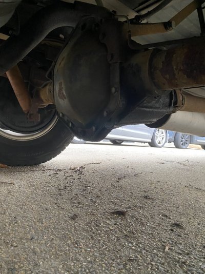

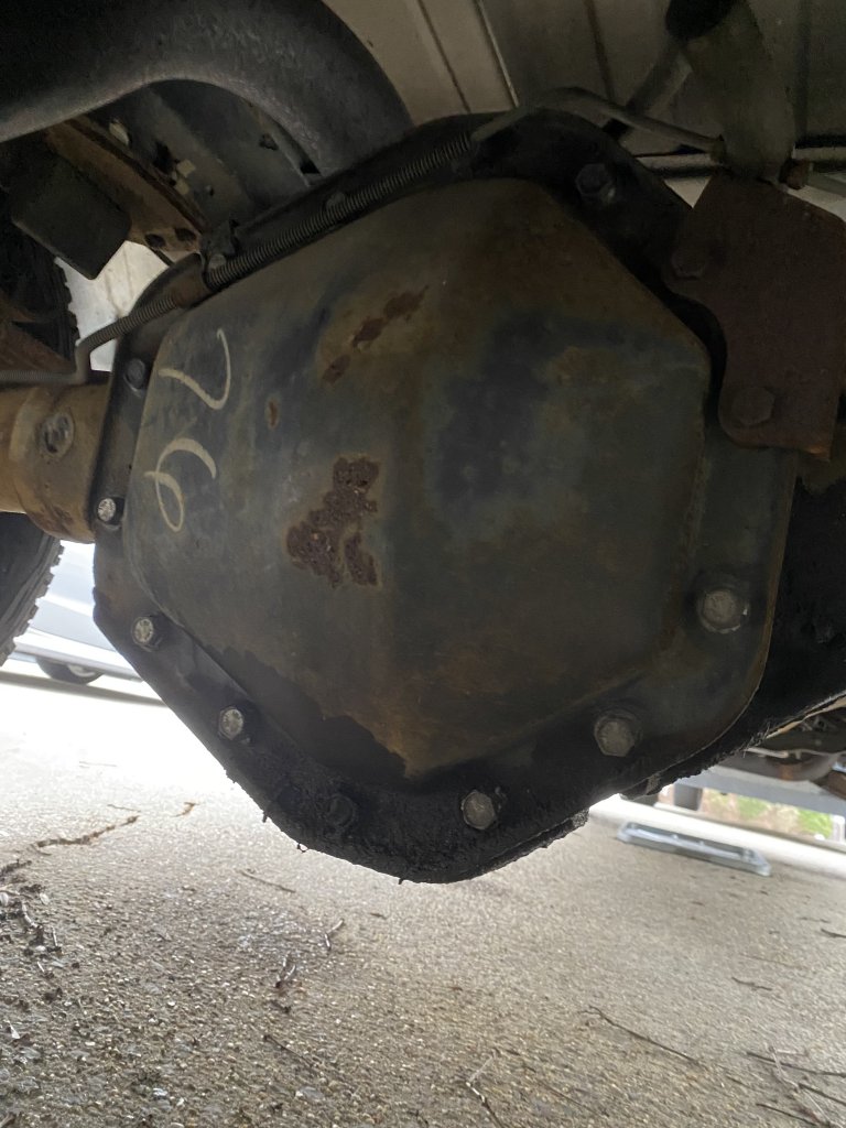

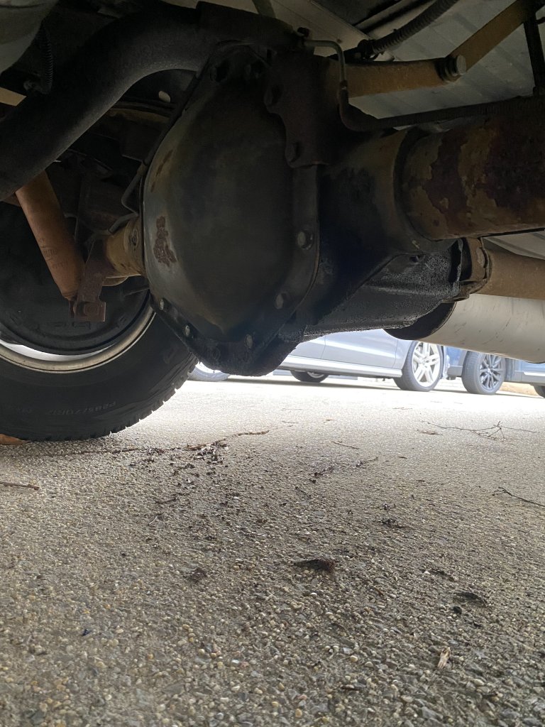

So, my 87 3/4 Burb (454/400) seems to have a bit of a leak from pinion seal I think. Also gotta fix a wheel cylinder. But, this diff cover has me a bit confused with the “76” marked on it. Is it a cover off an older truck? An axle swapped in? Will prob pop the cover off eventually to check what gears and setup is in there- but glovebox sticker indicates a 3.73. It’s a FF 14 bolt.

The number could be anything, unlikely directly related to the model year. Some employees on production lines write on parts for various reasons, it could be an employee number signifying the part was inspected.
Pull the cover and look at the edge of the ring gear, it will have ratio and month / year info stamped in it.

If it is a full float 14 bolt, then it is not original to that burb. 3/4 ton burbs of that vintage would have came with a 14 bolt semi float.

I think this FF is original. RPO shows 3.73 open. I found the same chalk marking, upside down, on the passenger frame rail. Pulled a wheel on the side I know I have a wheel cylinder leak. All looks the same as far as age and no indication this rear has been changed. I’ll be diving in to wheel cylinders and do brakes while I’m there. The pinion can just leak til I can have someone do a locker and replace pinion at the same time, as well as prob do 4.10. Pics for reference for y’all.

2WD 454/TH400 Suburbans got the full float 14 bolts. I had an '88 and my friend had an 87. 4WD got the 14 bolt SF.
