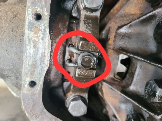

I am in the process of changing the gear oil in my truck.
1986 Chev K30 Crew Cab
14 Bolt Full Float Rear End

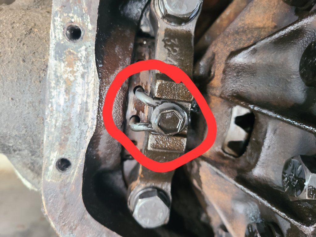

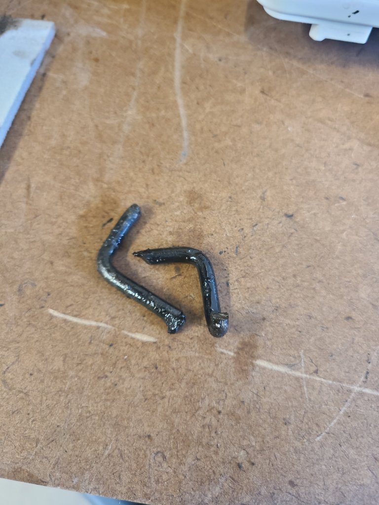

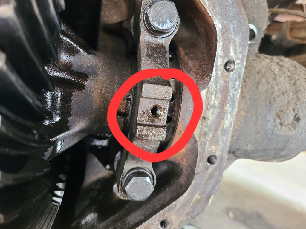

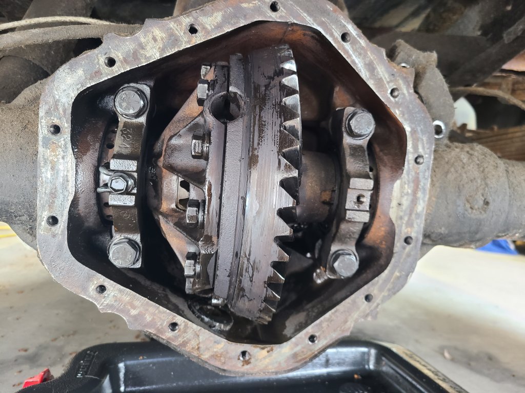

When I took the cover off to drain the oil it was quite dirty. There was also a fair amount of metal shavings on the magnet in the base of the housing including a broken clip. I will post pictures below. The center bolt on the passenger side was missing and I'm assuming made up the majority of the metal shavings
All the teeth look in good shape with mo other damage noted. My question is what is this bolt/clip called and can I buy just that part??
Appreciate the help!

Thank you...what the heck would cause that to break like that?
My best guess would be wrong torque when it was put in at some point. Too much torque cracked the prong and the bolt backed out with nothing to hold on.
