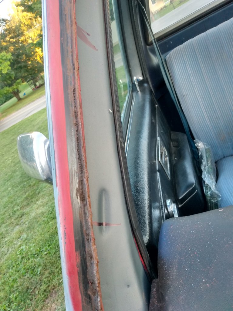

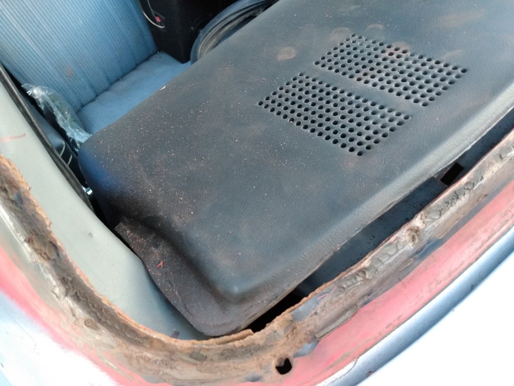

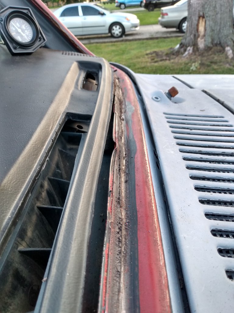

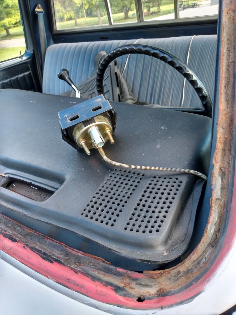

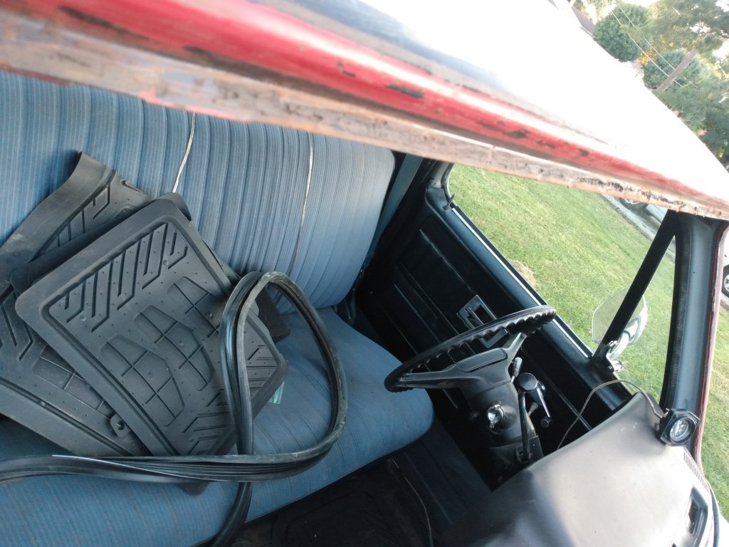

Took out windshield today. it was leaking all over. Sides, top ,and bottom all were leaking in random spots. Before I took it out ,the windshield gasket was sticking out on all corners. ( Not flat with the body) . I see someone put seam sealer on frame maybe from factory. I got a place to put new windshield in next Friday. The pinch weld frame has little rust and 1 or 2 dents. Do I have to get all the old seam sealer off? Or will it be ok for the company to put it in like that without it leaking. I'll do some sanding and a little bit of wire brush but don't want to get it down to bare metal.

Here's some pics

I would strongly recommend taping it off and using some plastic or cardboard, then beg, borrow or steal a small sand blaster to completely remove all the corrosion before sealing with a quality epoxy - something with an etchant in it. This is your best chance to nip the rust in the bud before you have major structural issues.
Harbor Freight has an example:
This will work fine for the small jobs when used with a modest air compressor. If I am not mistaken, Home Depot may have compressors available for rental.
For blast media, I prefer copper slag (just my preference) over sand.
Do the deed on a nice dry day, blow off all excess dust, wipe with acetone and paint immediately.
Then you are good to go.

Suggest you spend quite a bit of time sealing up the interior. Sand WILL get everywhere and it's hard to clean out. Seal up the air vents, steering column and everything else you can think of.
Speaking from experience here. It's no fun crawling under a dash and getting a pile of sand in the eyes.
POR15 is a very good sealer for bare metal and rust.

Wire wheel takes all that off pretty quick. The rust and the original sealant. Your windshield frame is still in good shape.
Of all places on our 86, there was zero rust anywhere on the truck, except the windshield and back window frames. And I cut/welded, patched over a dozen places so take care of it now while it's just a clean up and repaint task.
Good news was I found out all the rusted out areas had rusted from the outside - in. So it hadn't spread past what was visible. You have the best case scenario since no rust through it appears.
You will end up getting some of it to bare metal, so it really doesn't matter how much is bare when you're done prepping it.
Many different materials will work fine for re-coating it. Por15 or similar followed by primer and paint. Epoxy primer followed by paint. Or just a good direct to metal primer and paint.

I'd also consider adding a couple more drain holes near the middle of the windshield. Mine kept water trapped in the middle as it was rusted there pretty good. I actually just enlarged some rust holes into drain holes but absent of that, I'd drill out a couple more spots.

Acetone will turn the old sealant soft pretty quick, yours looks exactly like the sealant that was on mine.
I prefer the stripper wheels to a wire wheel, they come in every size & shape. The roloc disc type or one that will fit in the arbor of a die grinder would fit your application well. These will definitely take the paint off too, but if it's already rusting you might as well get down to clean bare metal and coat it with epoxy.
Probably a good idea to straighten the pinch seam where the big dents are too
