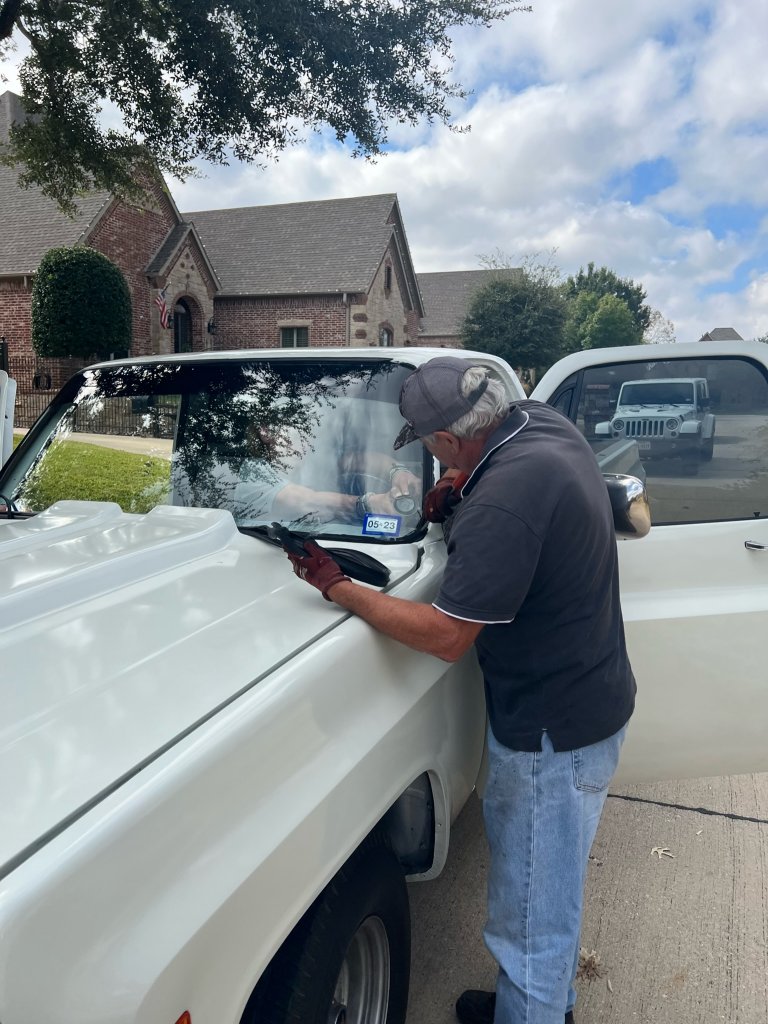

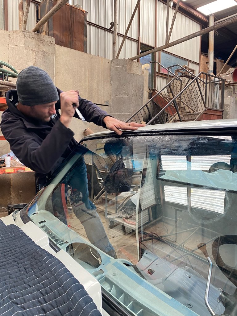

I helped the glass guy put my windshield in and he put it on the pinch weld first and used the hook tool like in the Precision video.

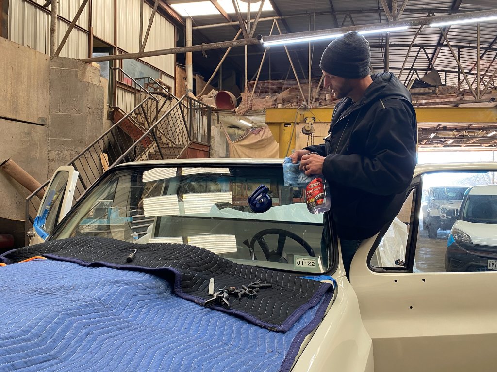

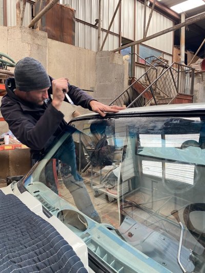

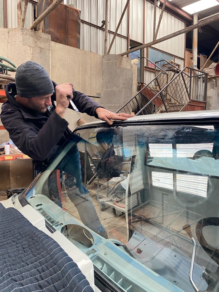

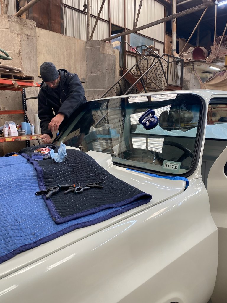

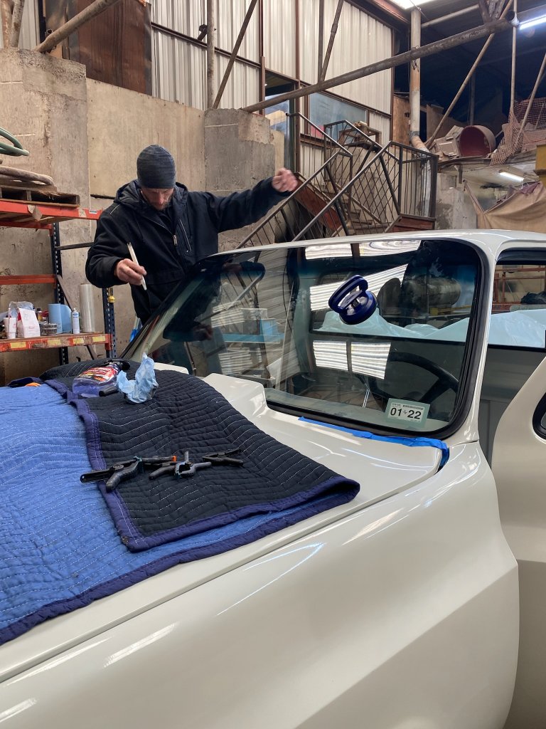

Pinch weld first yes, glass second as stated above. We had to do ours twice because Easton chose a one piece gasket first and once installed had large gaps and leaked everywhere. Went to a two piece and been dry ever since. Used Precision gaskets.

I told the glass guy to leave me with the lock strip. I soaked it in warm soapy water and used the proper tool.
