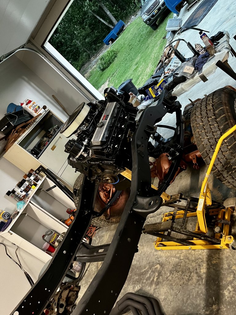

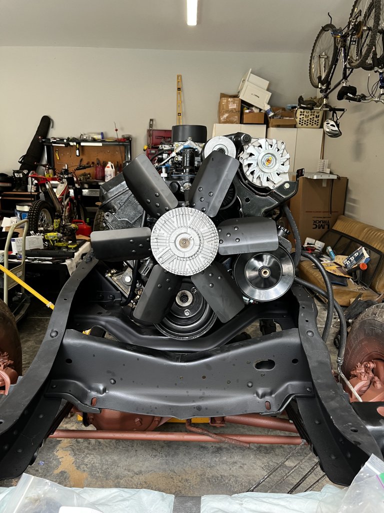

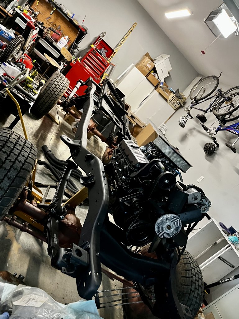

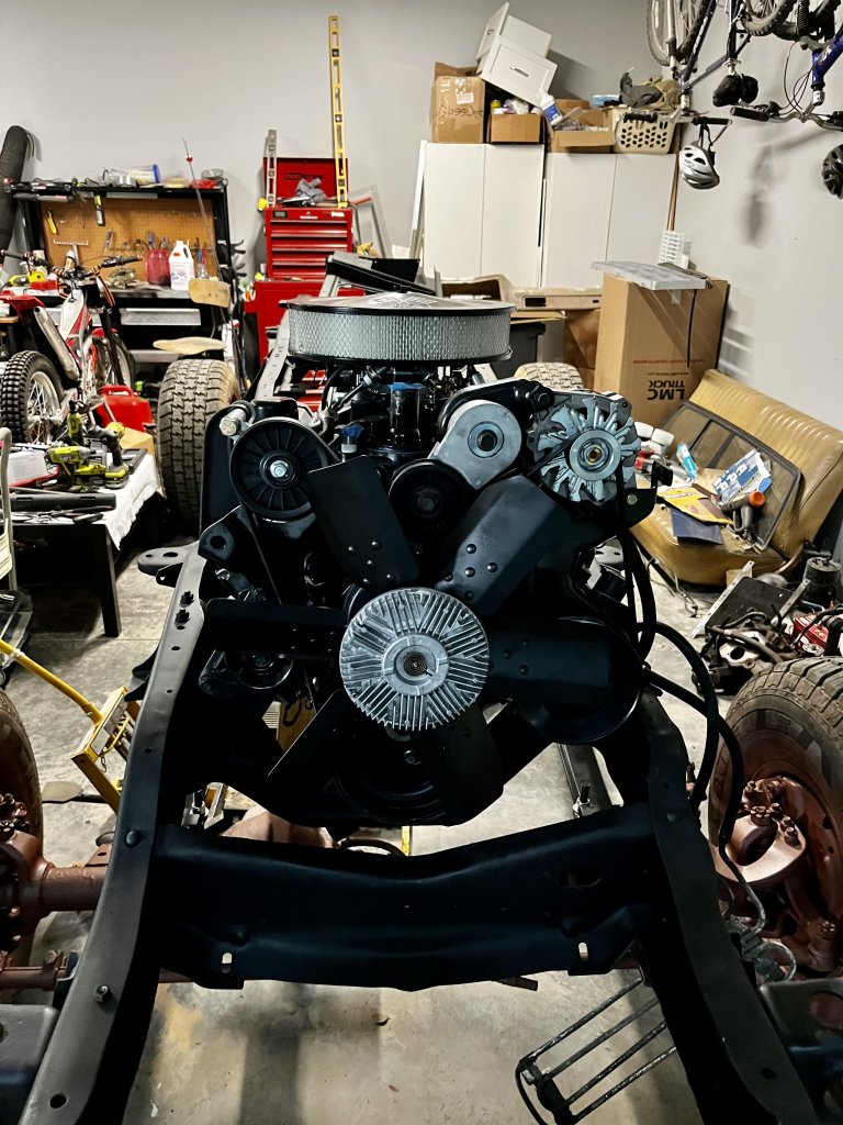

Thanks everyone for your responses. I finally got the motor in. Ended up buying competition style motor mounts from Off Road Design. They fit and had enough clearance for my long tube headers. I have a new summit racing 8 inch oil pan on it and it barely clears on the right side. Here are some pictures of it in.
