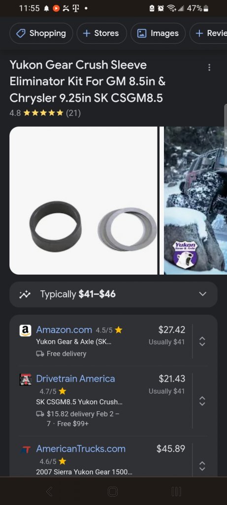

To make your life easy get a solid crush sleeve replacement before you do the pinion seal,and inspect the pinion bearing. If it looks bad nows the time for maintenance.
