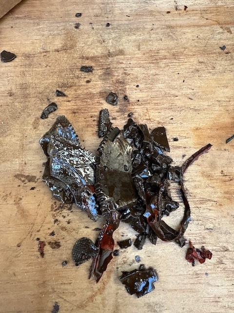

Looks like I am going to be rebuilding a 14 bolt 10.5 to swap into my truck since my 9.5 rear has grenaded the gov lok and is on borrowed time. What is everyone's choice for a posi/locker? I am looking at the true trac since it is kind of the gold standard, but am also tempted by some of the offerings from powertrax like the Grip Pro and the No-slip traction system. I dont really want to go to the trouble of regearing the axle and not put in a good traction aid.
Pic of some of the gov lok carnage I removed from my 9.5, which surprisingly still works and really isnt noticeably noisy.

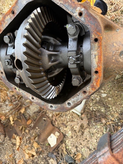

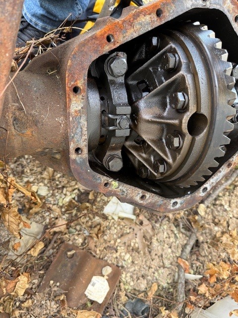

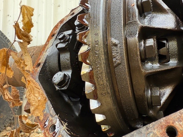

Pulled the cover on my spare 14 bolt. I believe this is an open carrier can one of you more experienced guys confirm? Also included the ring gear numbers showing factory 3.21 for the 14 bolt.

Yes, typical open carrier BUT do some research if you plan a gear ratio swap because I'm not sure if the 3.21 carrier is the same as 3.73/4.10 carrier or the 4.56+ carriers.
