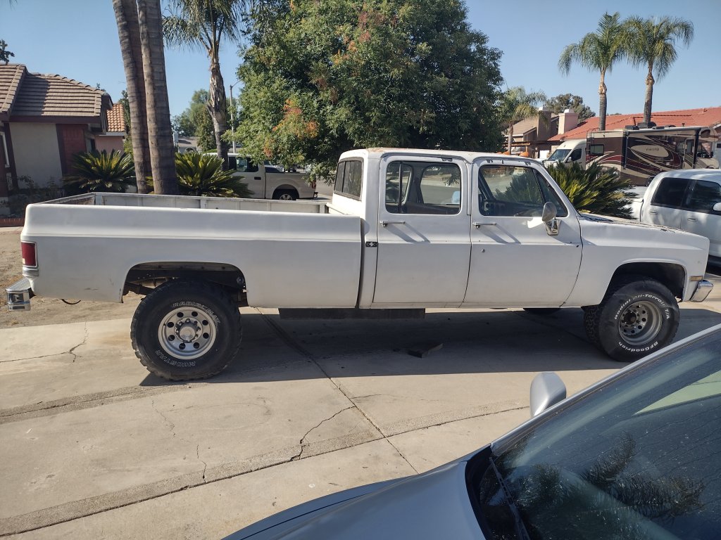

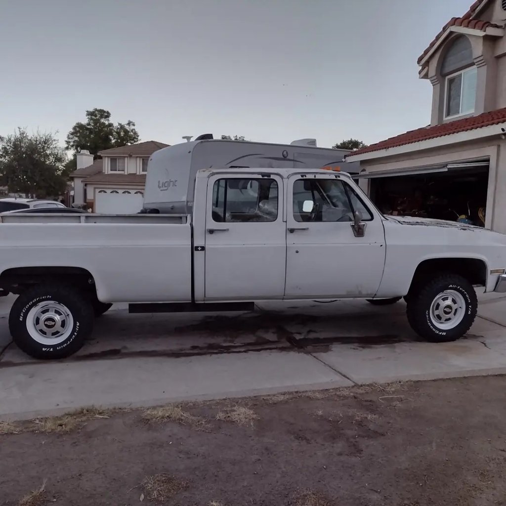

The rig: My brother and his boys are big offroaders and outdoorsmen as am I, camping, fishing, dirtbikes, hunting, off-roading you name it we love and we are all in construction so this truck got ran and ran hard and has always been a great truck....completely rust free and body damage free other than a few daily use dings. She's got a recently rebuilt 5.7L TBI 4 bolt long block, a fresh Turbo 400 trans and the beast 14 bolt FF rear diff with 4.10 factory gears and the dreaded G80 "Gov-Lok" diff....not the best but it has never failed yet.
The plan: After the boys grew up, bought their own trucks {all Chevys and all very rigs} the Cow sat for years in the driveway unused and I regularly asked my brother to sell it to me....he wasn't ready, when my last nephew got married his wife wanted to clean up the yard and all 4 boys said they did not want the Cow and my bro finally called me and we agree'd on a price that was fair for all I think, but trust me.....way below value when done. My plan has always been to convert her to a 4x4 but, in SoCal where I'm at GM passenger side drop Dana 60 front axles are non-existent and the few around they want $4000-5000 for them in mediocre condition....I finally ran into a Dana 44 out of a 74 K20 and a divorced NP205 transfer passenger drop so its the correct 8 lug pattern, all GM parts and a pretty easy swap I'm hoping...the new front diff is 4.10 gears open diff, immaculate internally and rust free externally and came with leafs and all the stock steering parts. The T-case has 1350 input yoke and rear output yoke same as my stock drive shaft and a 1310 front output yoke which is the same as the new Dana 44 so easy fitting components together.
Pics: one will be the day I got it with miss matched deep rims with mismatched 35" tires and all filthy....other pic will be after I found some ford econoline rims at a pull you part in 8x6.5 bolt pattern and 7.5" x 16" wheel size which I snaded and degreased, primed and painted white and a set of stock hubcaps and new set of BFG AT's and a good wash job....great starting point for a truck is going to be a daily driver, hunting/camping/fishing rig, MX race and dirt bike hauler, light wheeling and back country exploring.....the Dana 44 is plenty strong for the 235/85r-16 tires and the whopping power of a stock 5.7L TBI
