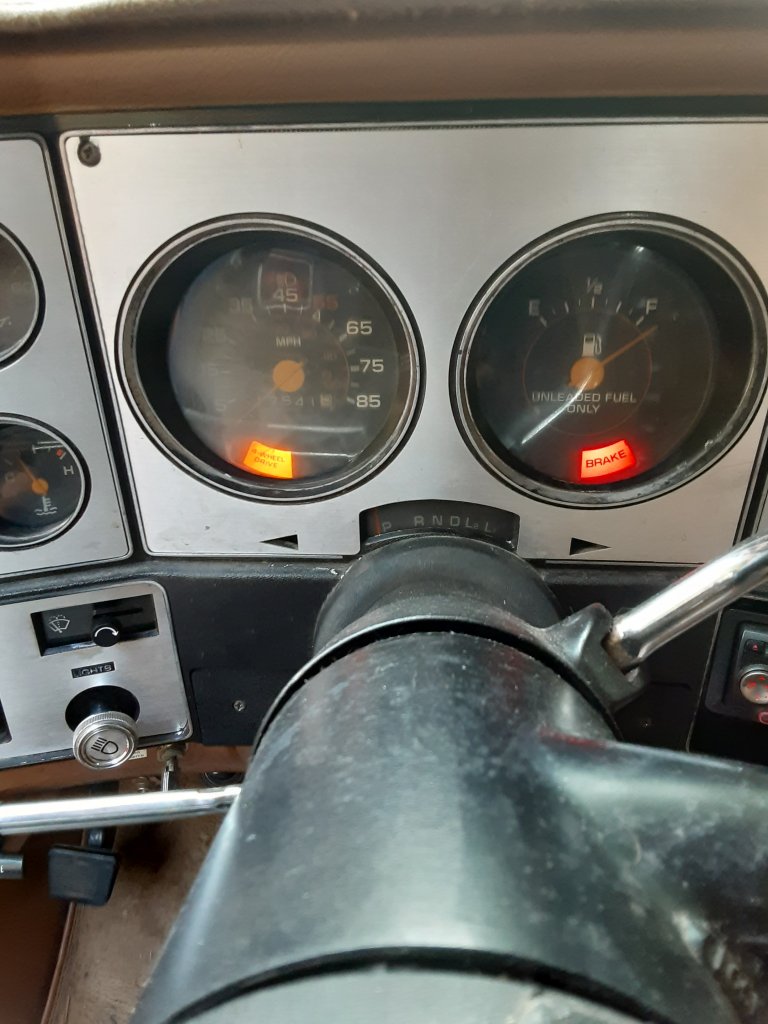

Well, it now works - kind of.
Not the old switch after all, and the shifter is sloppy so the light can be problematic.
