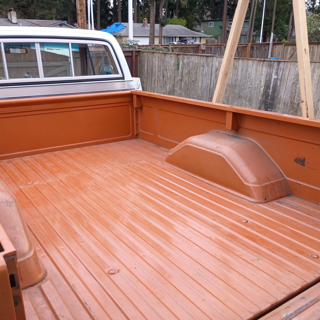

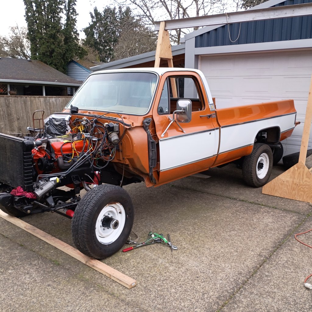

FINALLY, set the body and bed on the waiting chassis. Overlooked the '77 frame not being drilled for the 2nd line of bed bolt holes. So had to go in reverse for a bit. So far, I'm liking it. Fired up the fresh 468 monday and broke in the cam. That went very well except I had to bend the flexplate back into spec. I used a standard turbo 400 converter on the '89 version 400, and it didn't slip on the trans pump, so after bolting up the trans, I had shifted the starter ring gear roughly 3/16" forward where the starter wouldn't release. Destroyed the factory starter, then attempted to eat a powermaster before I caught the issue.
