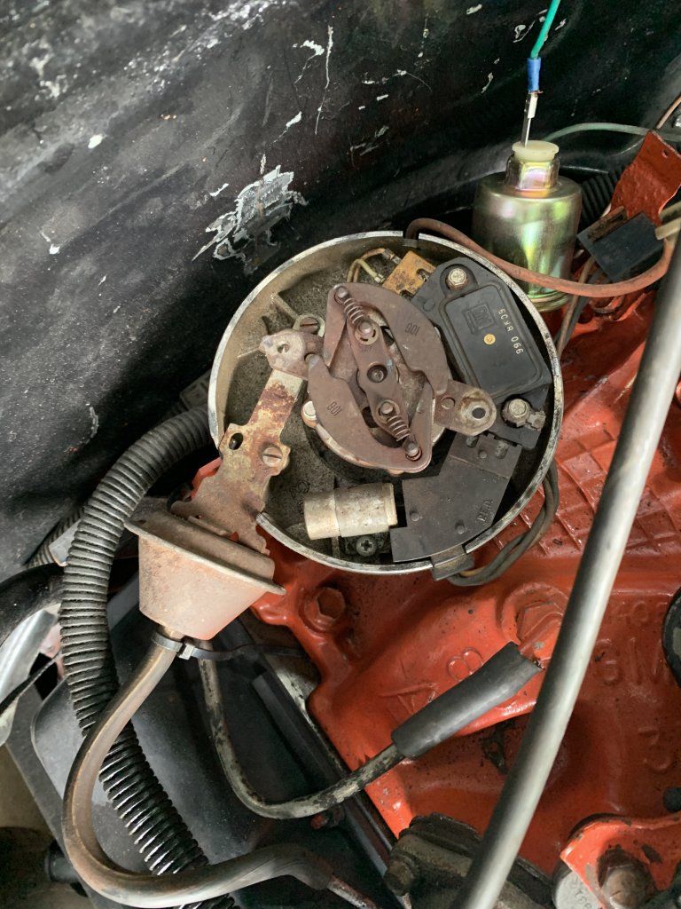

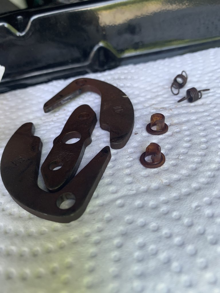

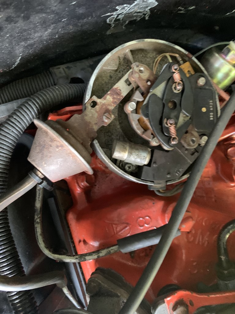

The last time I had the distributor cap off I discovered the bushings on the weights were worn out. I looked around for replacements but was unable to find anything. I finally decided to purchase the Moroso 72300 advance curve kit.
Honestly I didn't really want anything more than the bushings, but the bushings in the kit will not fit the stock weights so I had to install the full kit. The kit has 3 different color bushings. The black bushing were the ones that fit my distributor.
The black and silver springs seemed considerably stiffer than what was in there so I went with the copper although they seemed much lighter. I was considering one copper and one silver spring, but we will see how the truck feels. If I need to go back in I can change them later.
I was not expecting a huge change in the base timing, but it was showing 20 degrees when I checked the truck after the install. I adjusted distributor back down and set it at 8-9 degrees. It goes up to 31 degrees when revved up so it seems to be working properly.
I am not really looking for a performance gain. I am just happy to get rid of those worn out bushings and knock off another item off the list of things to do.

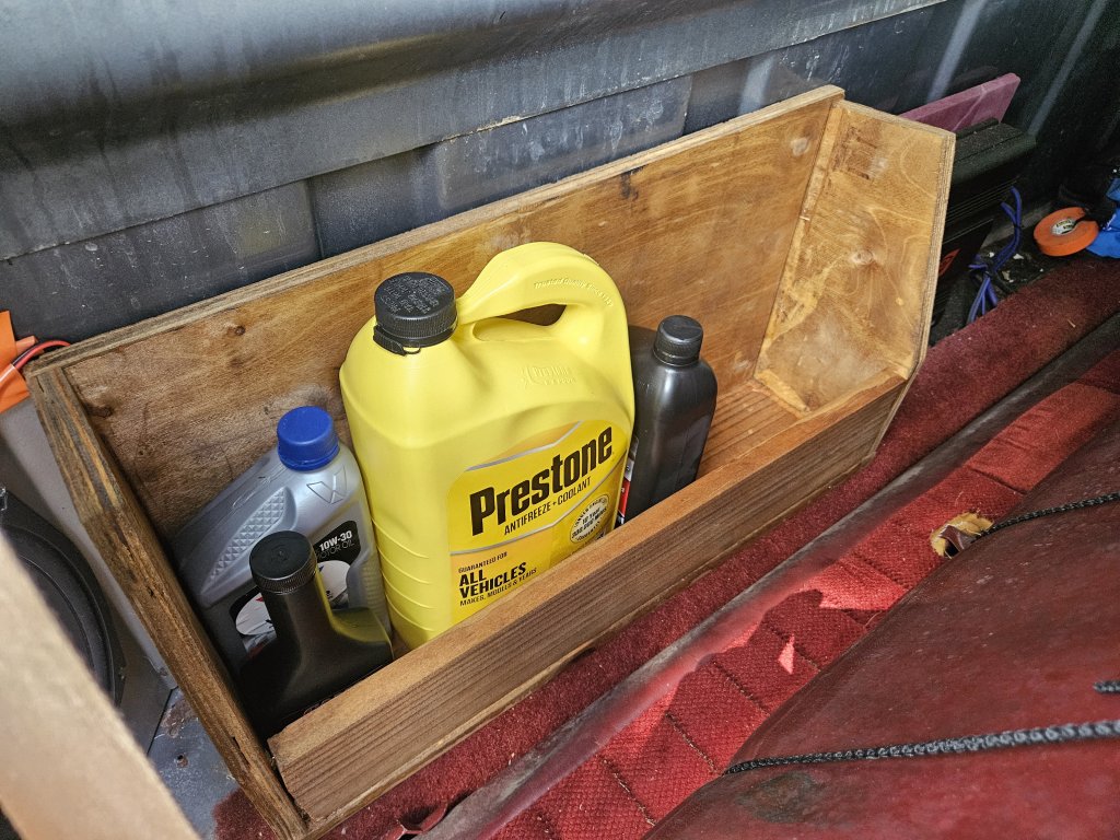

Emergency stash box ready. Might paint it to match the interior... not sure yet. But so far is holds antifreeze, power steering fluid, tranmission fluid and motor oil. You never know when you will anything.

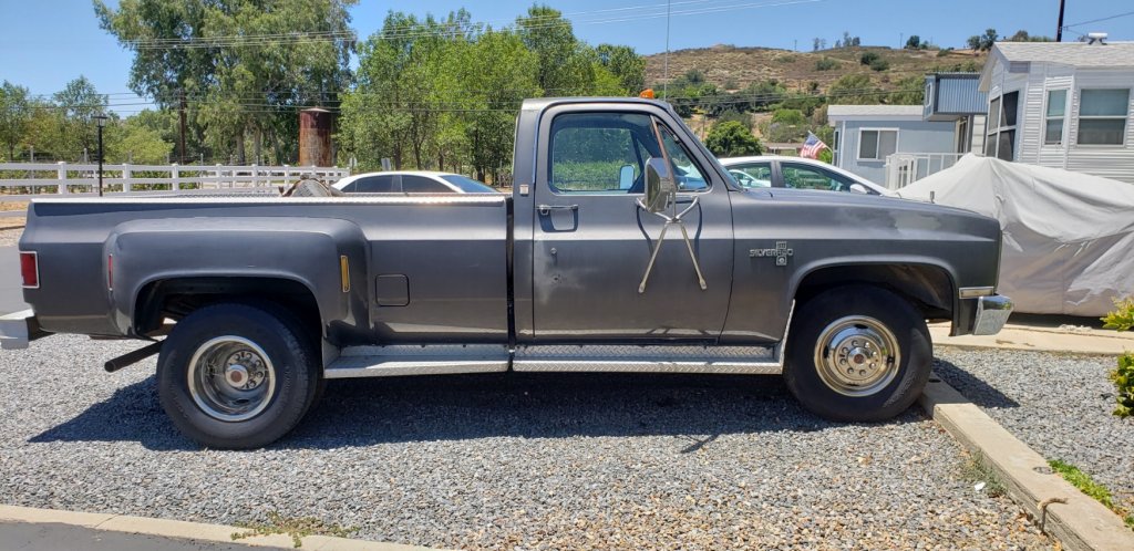

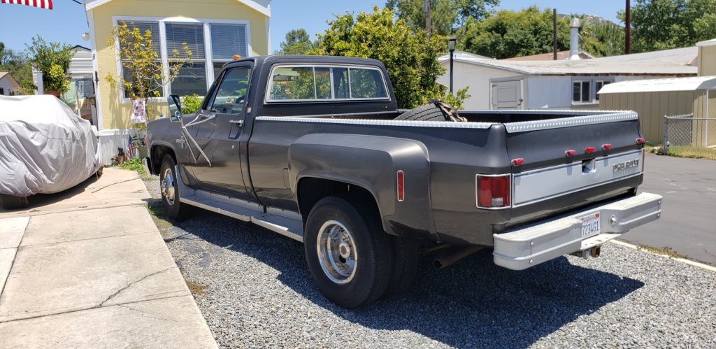

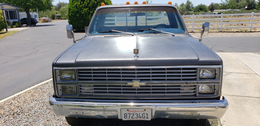

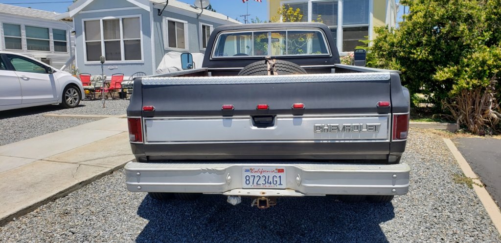

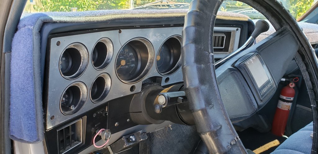

Got the lights replaced in the dash with LED's, looks good at night! Washed years of dirt and bee chit off from being stored in a field. added clean gas, started and drove. Ready for Ramona Cruise Night but will probably try to buff out and polish. Made an offer on a place with a garage and workshop, fingers crossed!
I like it, but I would cut that angle steeper, looks like those top front corners will poke a hole in the seat back where it is now.
