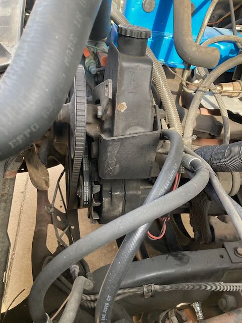

I'll probably get it off and find out its the water pump, or PS pump.. But my big stick says alternator. Of course, it's underneath the others. $36 from rock auto.

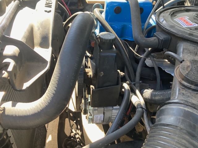

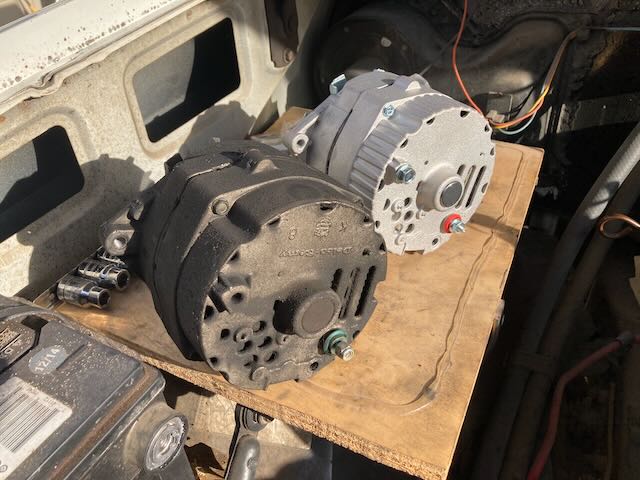

So, OK, I did correctly diagnose bad alternator bearings, and replaced the alternator in about an hour. Looks buried under the PS pump, but, two bolts and out, then in. Hook up 1 plug and main output.. No big deal. Rock auto, $36, plus $7 core, plus shipping. I'm not returning the core, but will rebuild myself. Only about 90K miles on the truck. Do you think it could be original?

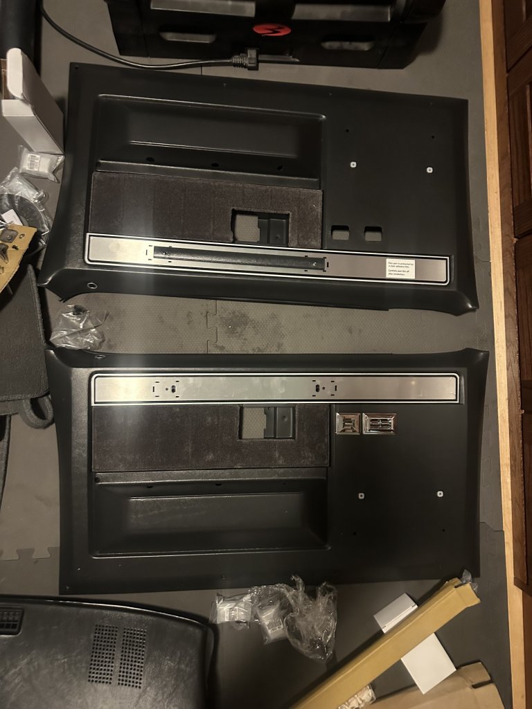

Started on the interior, painted all the interior panels including the dash with "SEM" Dark Charcoal, began fitting the carpet. The headliner was done months ago, just getting to the point where I can install it. It looks better in real life, plus it will be hanging upside down so I am not worried about the bumps.
