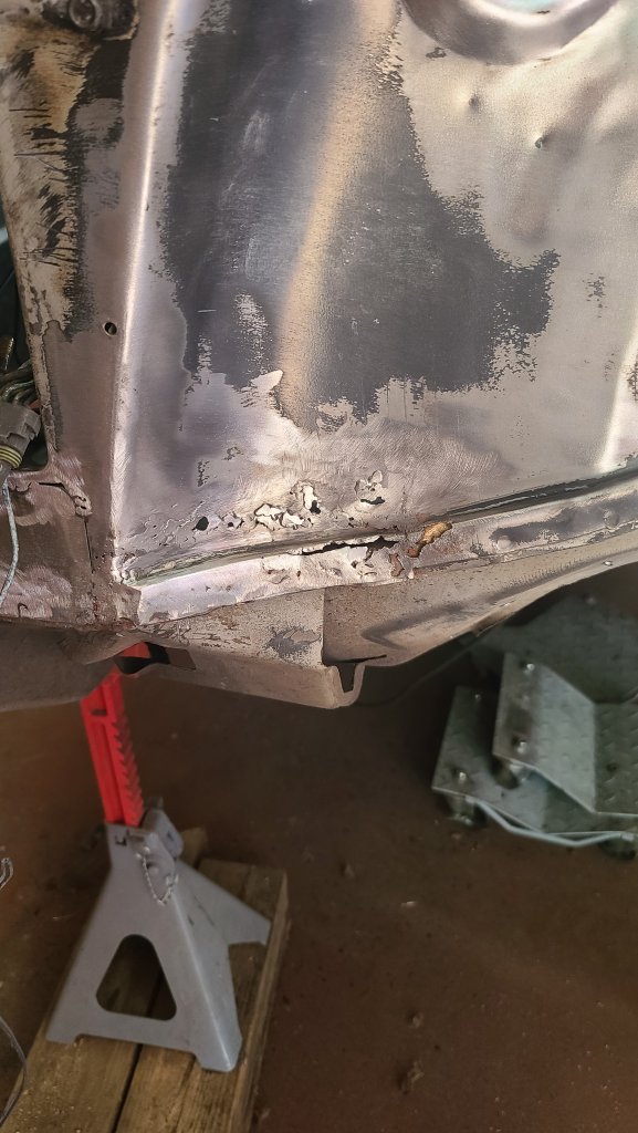

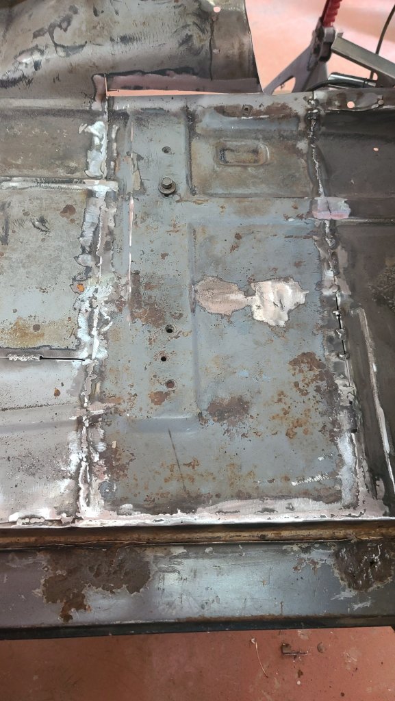

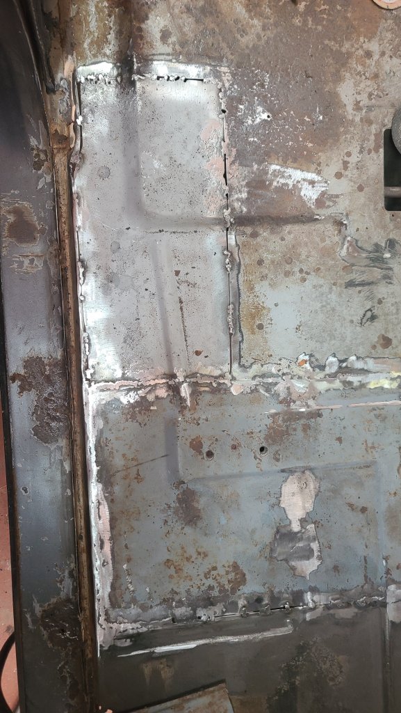

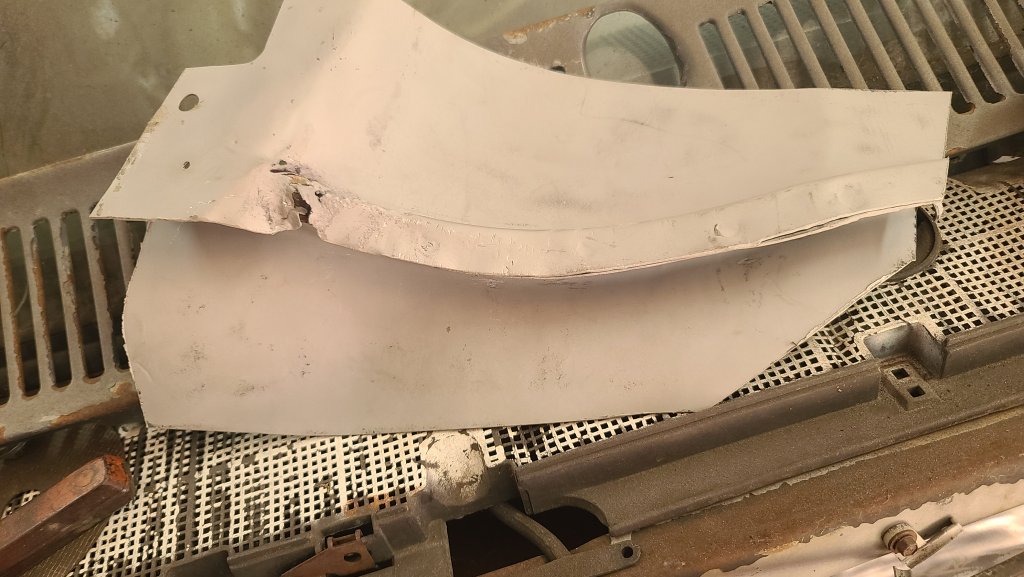

Got a little more of the passengers side floors started. Also started cleaning up the firewall. Have to fix a spot. Cut out a panel off of the 2wd Blazer. Sand blasted it.... I forgot how much of a PIA cleaning seem sealer out..
