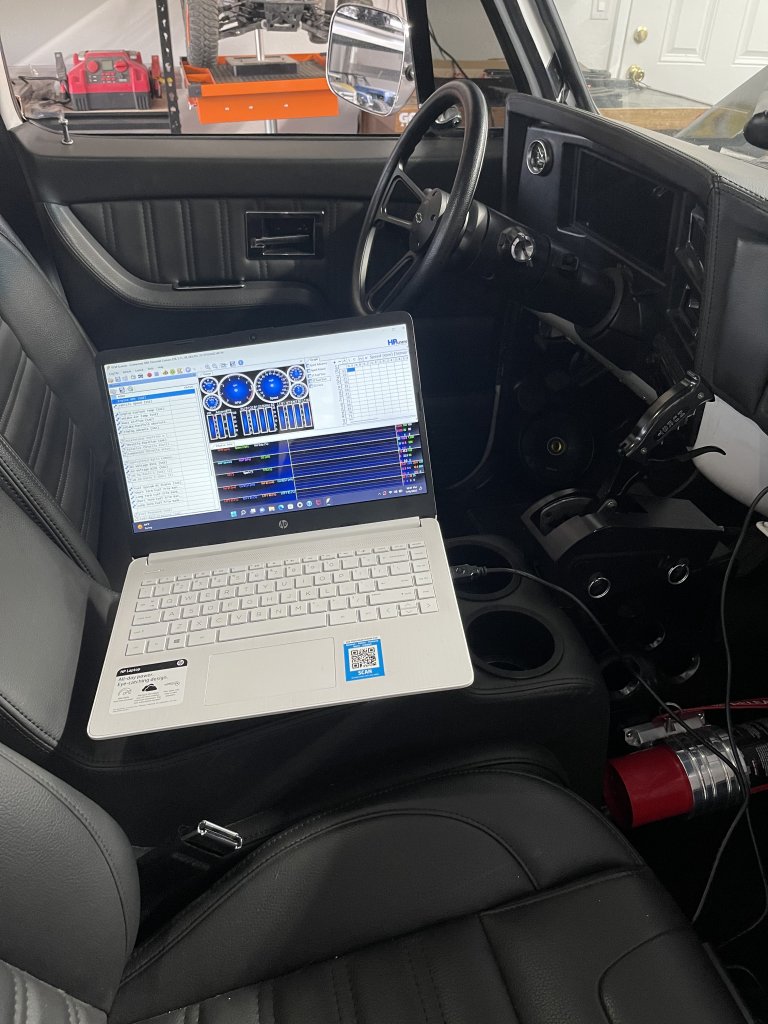

I bought a cheap refurb hp laptop and the HP tuners suite so I can tune my stuff myself! Wideband kit is on the way then the fun will begin.

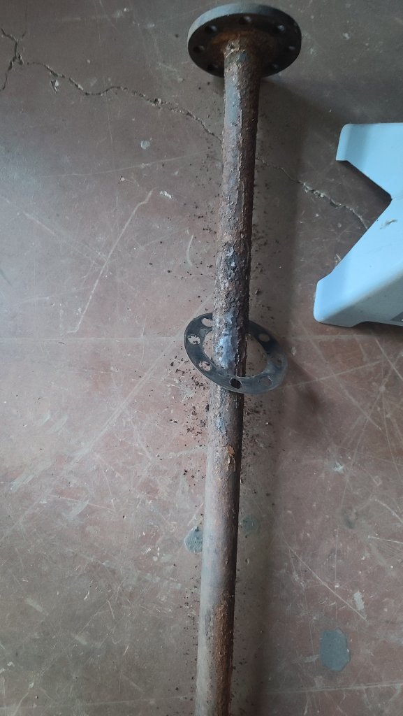

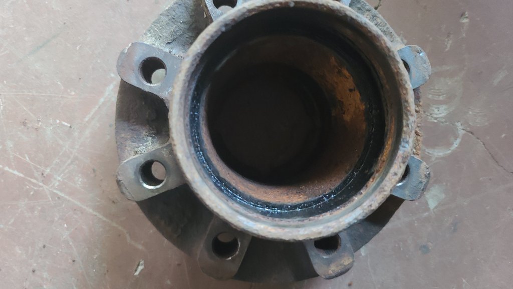

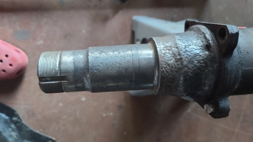

I started disassembly of the rear end to day in preparation for the disc brake conversion. I was a bit surprised when I started taking the rear end apart. I got the rear end 20 something years ago in trade for some work I did. It has sat outside since I've had it, who knows how long it sat outside before I got it. I guess I should have check to see if there was oil in it...there wasn't!
My question to the group is...Should I try and clean this one up, or should I try and find another 14 bolt. The other side is in much better shape. I can only imagine the ring and pinion are shot. Which I already had plans on re-gearing to match the front.

Oh dang, that seal surface on the housing looks like Scruffy the Crime Dog... Ruff, ruff, ruff!

The bearing surfaces and nut threads on the housing tube look okay. You'll just need to glue on a speedy sleeve where the seal surface is. Use #2 Permatex, good to go.

Where do you get a speedy sleeve from anymore?

Do y'all think the Axle shaft would be fine to just wire wheel it?

First, you need a good parts guy. All the part houses can get them, but will they go to the trouble for cheap part?
Advantage I have working on a fleet, we buy lots of parts = lots of money. So they will take the time to help. Do you have a NAPA store near you?
If you can't get one, give me the measurement from the good side, and I'll get you one.
