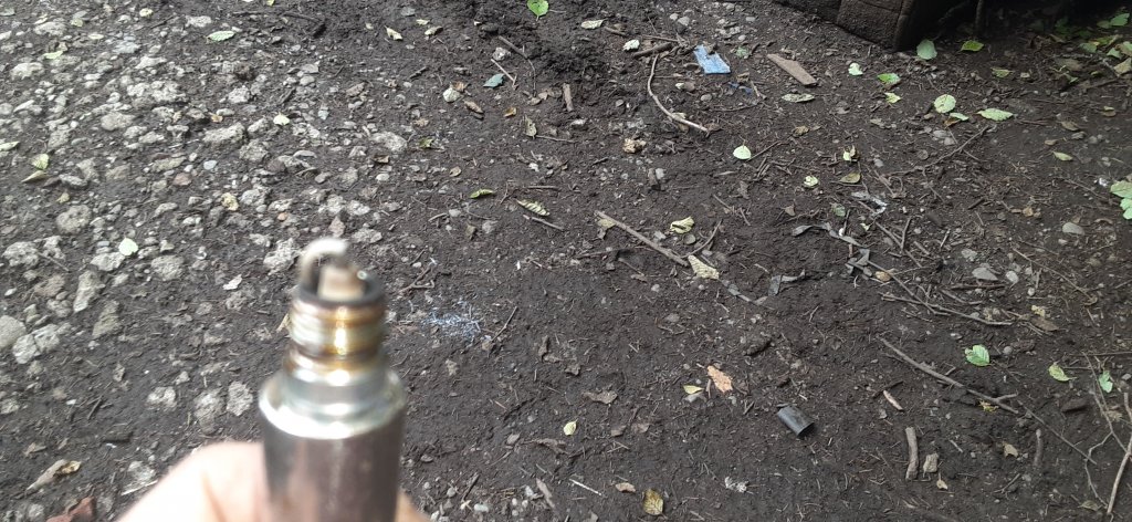

Finally I pulled the #7 spark plug. This was the cylinder that was fouling every 100 miles or so with oil. So now nearly 3,000 miles since the intake manifold gasket replacement it looks clean and good. What's better is I'd only used about 3/4 of a quart of engine oil in that 3,000 miles. Pretty good for old 305 of unknown mileage!
I blurred the plug pic a little bit but I think you can clearly see the colors look good!

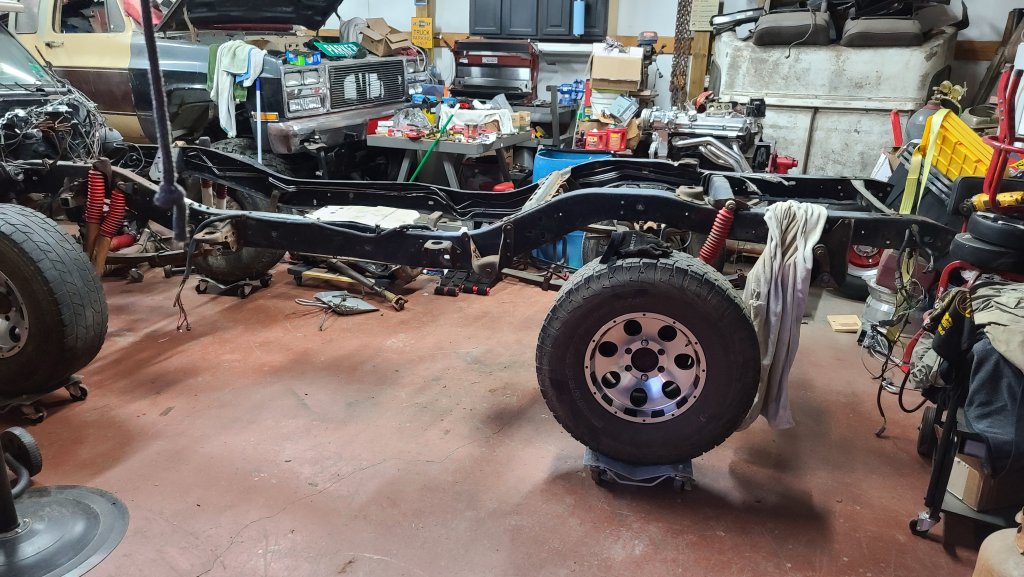

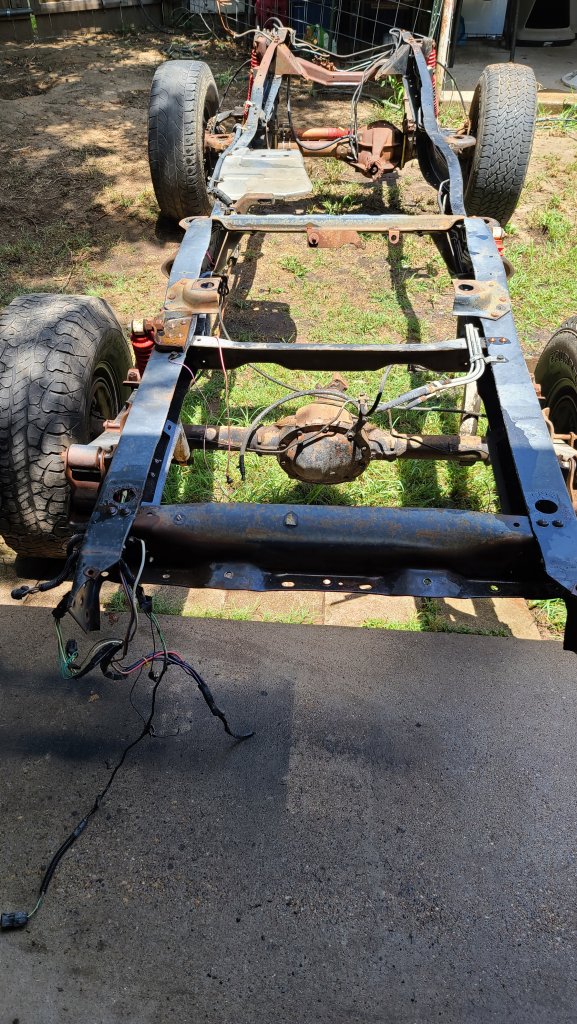

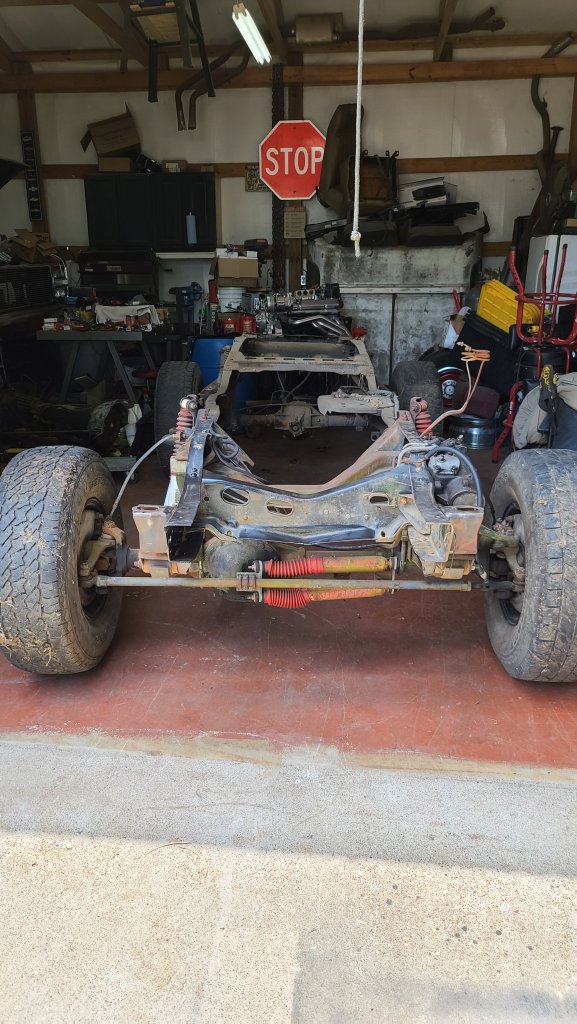

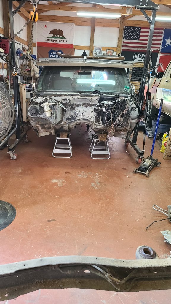

Got the frame out from under the body. Pressure washed the hell out of it...Next up...Shackle flip, 14 bolt, and cleaned up springs, and POR15 the rear portion of the frame...
