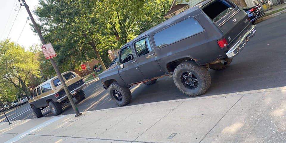

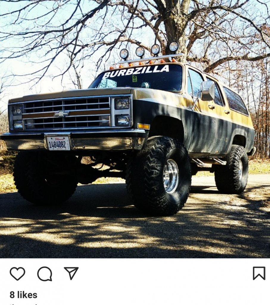

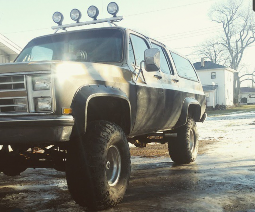

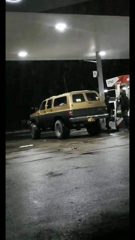

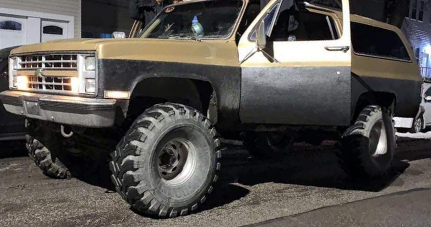

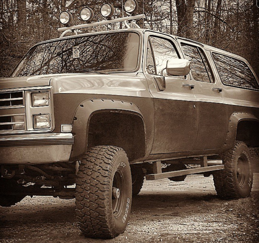

Looks like 40's, but doesn't look like 12 inch lift. Really hard to tell, but you can kinda see the arch on the RF spring. My guess is 8". It also looks like the fenders are cut.
Thanks for the help bucket. I have these photos as well. He said the size of tires in the photo that's not filtered in 37 if that's any help. Obviously we can only estimate with photos but I didn't think it had a 12in lift either

Yep, that really looks like maybe 8" springs. Those are cutout flares too, which you have to remove a fair amount of metal to install them. That explains why the wheel wells look like they do in the other photos.

That actually may only be a 6" lift. It doesn't look all that much higher than mine with 36x15.5's on it. Mine has 4" front springs and about 5" over stock in the rear.
Certainly no 12" lift at all.

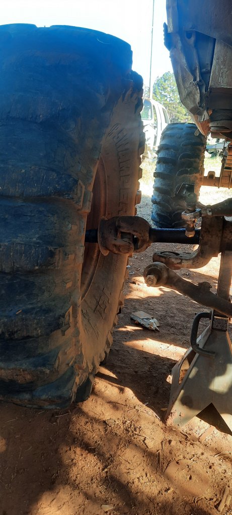

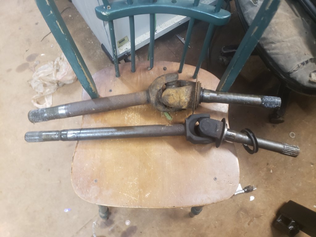

I wish I still had a spare 10 bolt front axle shaft and a 10 bolt rear axle shaft laying around so I could show you the disproportion of one of them next to a 40" tire. Its a twig compared to a 40"
But in the meantime, you're in luck.. I'm servicing my Dana 60 front axle on my trail truck,, so enjoy a picture of what a 1 ton axle shaft looks like next a 1/2 ton shaft, (old pic) and then what a 1 ton axle shaft looks like laying inside of a 39.5x18x16 tire, and maybe think about if you really want to strain that 10 bolt like that. Hell even the 60 looks like it could break with enough traction and power.

Thank you guys for the feedback. So what would be the best option if I'm on a budget? Here's some photos of what I want my truck to look like. The owner told me the tires were 40s in most of the photos and 37 in the unfiltered photo that has cut out flares. I'm not sure about the tire size in the filtered photo. Bucket estimated that it has around a 6in lift. Bucket also noticed the fenders were cut to accommodate the flares/bigger tires. If any one has any experience with fenders, would you be able to give me an estimate on how much was cut above the wheel? Thanks again
So, the biggest issue with these trucks is, there's usually plenty of vertical fender space, but never enough horizontal fender space.
What some people usually do is just trim the corners of the fenders off + lift to accommodate larger tires. You eventually just get to a point where you have to lift the entire tire out of the fenderwell and put the truck above the tire once it's a big enough tire. LOL
I'd say if those really are 40's, it's probably a 6" lift based off how much of the tires fit into the fenderwelll.
I would (personally) stop at that 6" because you'll start having to get into custom driveshafts if it keeps getting lifted, and then eventually you'll wanna consider crossover steering because the factory steer will begin to suck and making left turns becomes difficult past that.
Imo, that 6" lift is kinda the maximum lift on a budget for minimal work.. past that 6" things become expensive if you wanna do it up decently and still have 4x4.

I meant to say by the way, I hope you didn't take my post as me being ****** with you when I said "maybe think about if you really want to strain that 10 bolt like that. "
I meant no malice in it

Thanks for the help. The flares look pretty similar to yours. Could you give me an estimate on how much metal is cut out above the wheel? I just asked this on my other thread not realizing I could've just asked you
And I just accidentally replied to the other thread, lol. I'll try to merge the two and maybe it will all jive.
I believe Bushwacker is the only maker of the large cutout flares for our trucks, so they are probably the same. Doesn't matter if it's front or rear wells, you actually don't take any from the top. Just the sides. I've got a thread around here somewhere that I showed what gets cut, ill have to find it. I'm not sure I have the pictures anymore.
