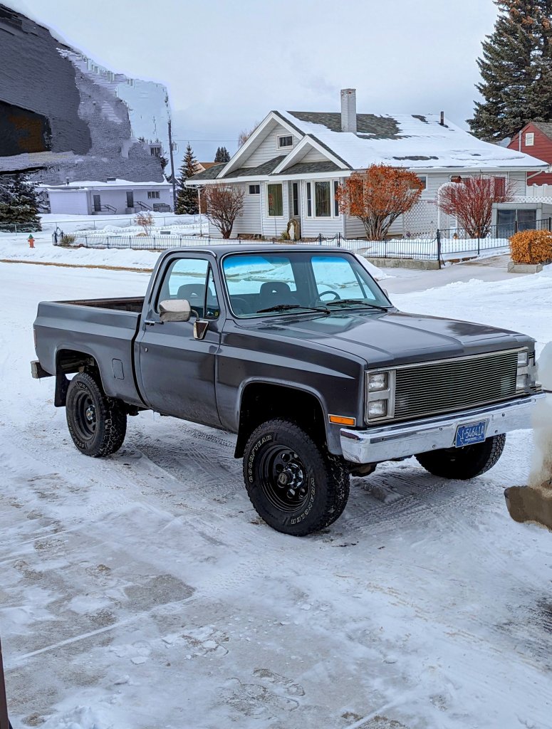

What tire size you running and pic for bonus.
9,558
17,538
The way your truck sits, 285-70 would be about right, 295s would be pushing it. 33-12.50s would be balloons on your wheels.
Bigger than 285 70s my gut says rubbing in front will be an issue with any suspension compression while turning, with what looks like maybe a 2” lift in front. Even with an oe type offset.
Personally I’d go white or black with the wheels. Black looks tough with the sand color wrap you have.
Use your current setup , measure clearance when front wheels turned, calc what it will be with your new offset and tire size options. Best way to gauge it and it’s quick easy and free to doo.

Pirelli Scorpion 285/75R16 (daaaang close to a 33). New springs - lifted it 2" but wasn't a 'lift' kit per se.

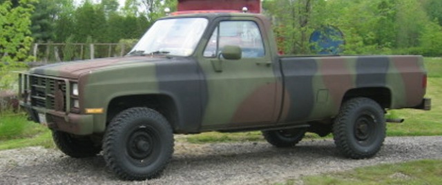

285/70/r17 on 2 inch lift

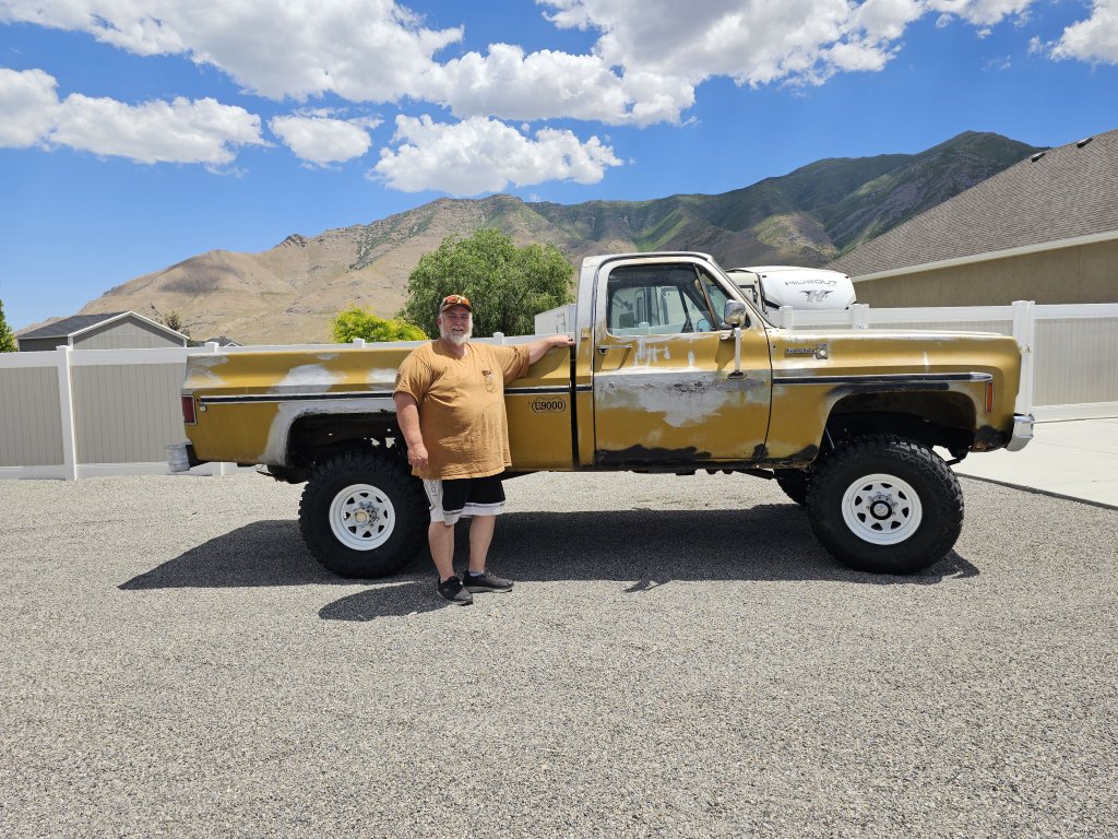

Dan, I just painted my 16'' rims and put on 35's On my K20 with a 4 inch lift. Good luck I had a hard time deciding what to do as well hope this helps.

@duckslayerja right? It can be frustrating to try and decide. lol That combo looks good! Thanks for helping me out.

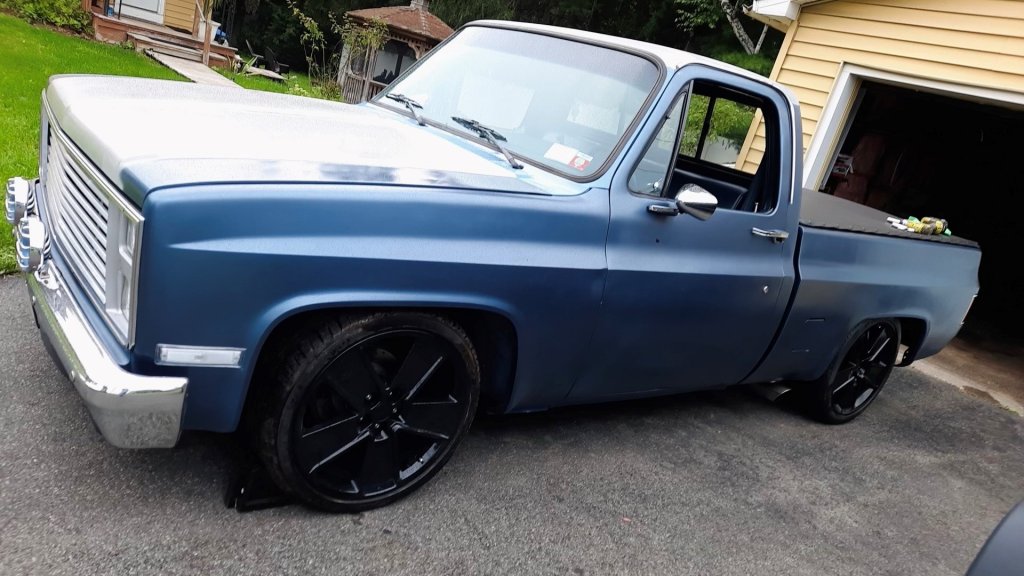

Just to stretch your imaginations a little, here's my 86 with my 2010 Camaro wheels,
275/35/21 in the rear, 245/40/21 in the front :cool: this was only for a day to see how it looked
