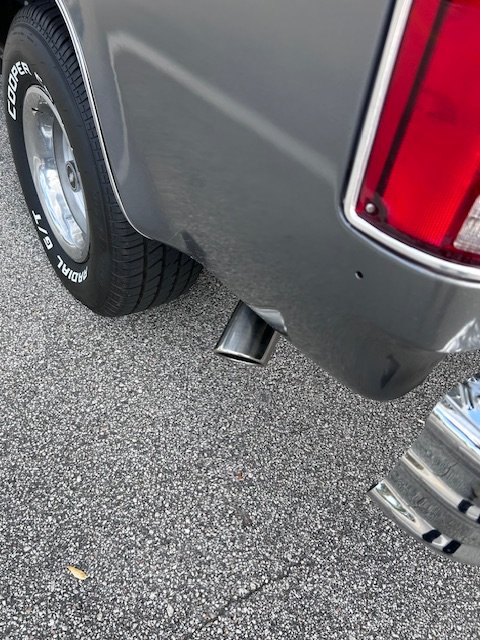

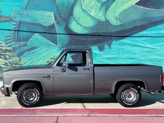

255/70/15 but my truck is not lowered on purpose.
