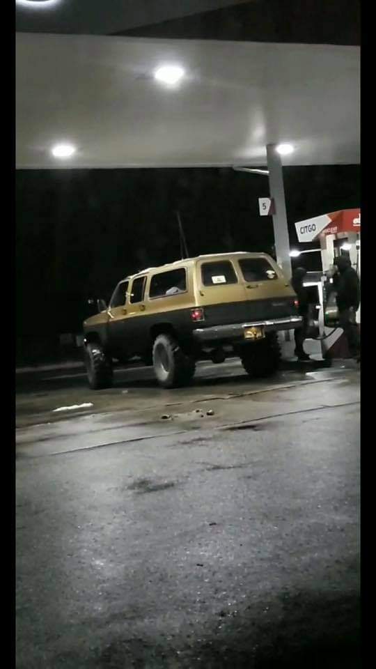

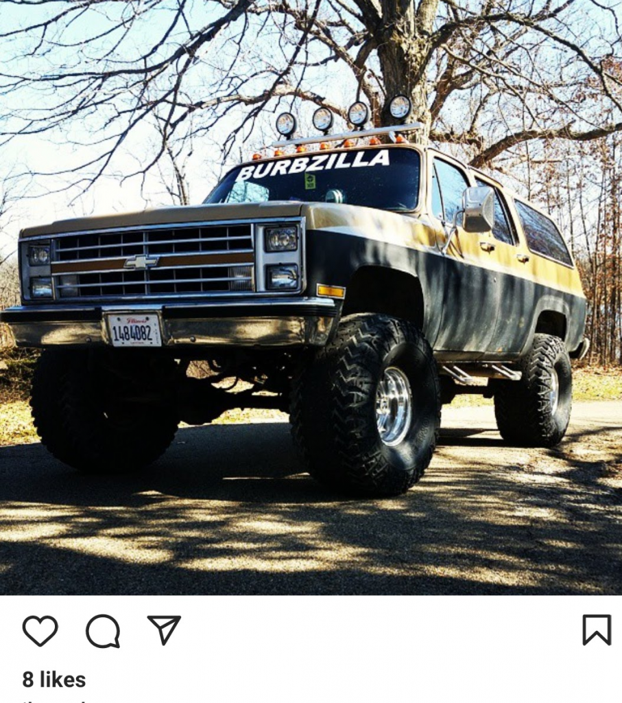

Thanks for the help. Can you help me out trying to guess the lift and tire size on this suburban? The guy who owned it told me it was a 12 in lift on 40s, but i don't think that's accurate.
Looks like 40's, but doesn't look like 12 inch lift. Really hard to tell, but you can kinda see the arch on the RF spring. My guess is 8". It also looks like the fenders are cut.
