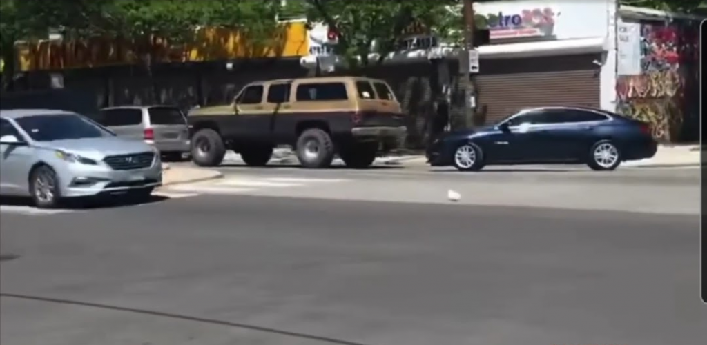

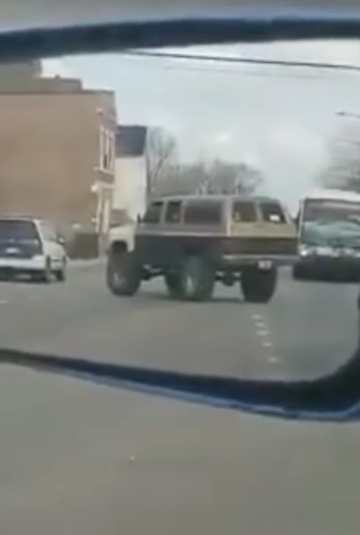

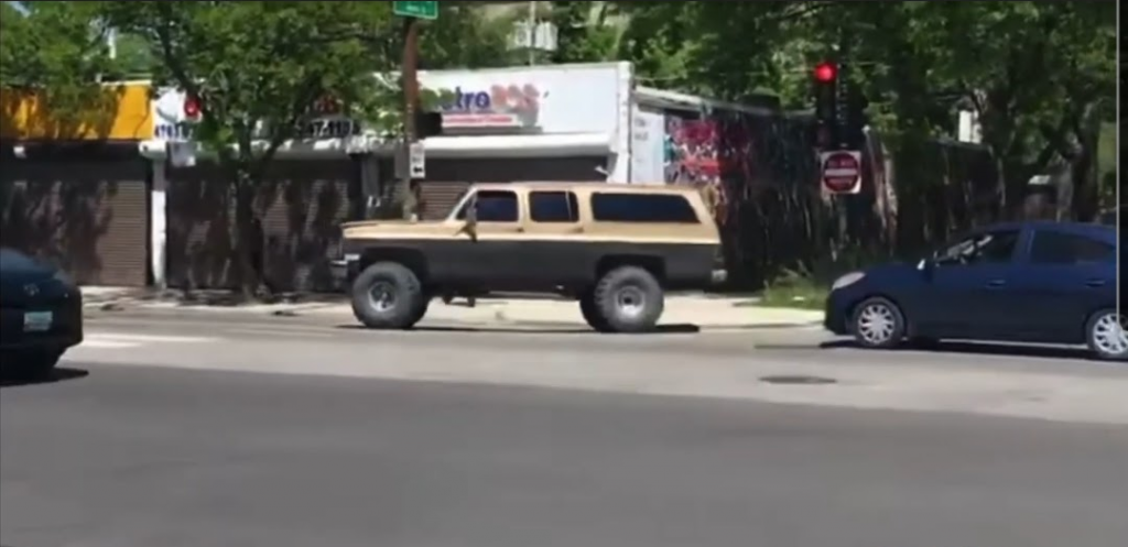

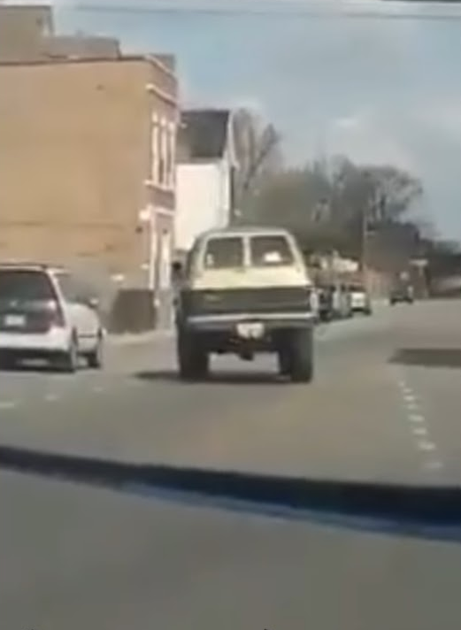

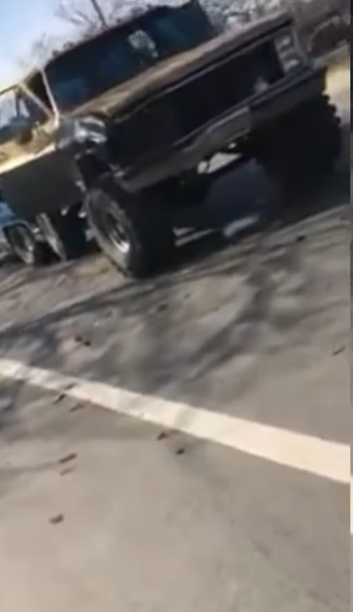

@bucket, I’m confused too. Or think I am.
Is burbzilla “not” the OPs truck and the black one is? Think that’s what I got out of this recent post.
At this point, OPs priorities or wants seem to be in conflict with his wallet and real world conditions.
Short answer, 40s won’t destroy axles (at least quickly) if it’s just a show truck. No bumper cars, lol, no hooking up a 40 mph burnout on a log or dry pavement.
But if you want to use the truck, and actually put any real torque on those 40s or whatever, stock half ton axles will be in the scrap heap fairly quick.
Sorry I should have given more detail. Neither of the trucks are mine. The look I am going after is the look of the brown truck with out the flares. I saw some photos online of the truck, and I messaged the owner asking about the details. He told me the truck had a 12 inch lift and 40in tires. I didn't believe that to be accurate and now here I am

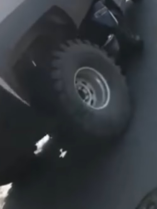

Those axles under the brown Burb are 1/2 ton, 10 bolt axles. Without getting into cutting and welding, there's no 6-lug axles to use that are stronger. There were later generation trucks that had a stronger 6-lug rear axle that can be swapped in with modifications, but that doesn't take care of the brakes. If you do swap in 3/4 or 1 ton axles, they will be used. Look for a set with the highest (numerically) gearset you can find. As for what is stronger, swaps directly in, etc, is a whole nuther subject and it's been covered here a time or two if you want to do some reading.
If you aren't willing to cut the fenders, you are going to need a much higher lift than that brown Burb. Which then of course, there's a lot more to it if you want a truck that you can reliability drive around in. Particularly driveshaft angles and steering.
