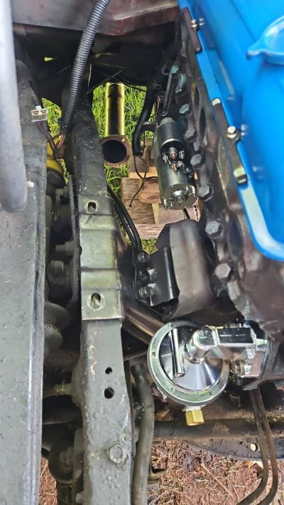

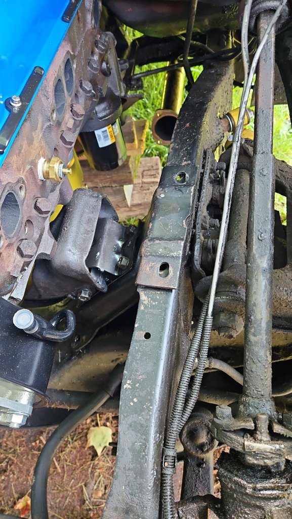

Had a couple things I had to do so I couldn't do much.
Obviously motor is in and bolted to bell housing and T/C.
I was able to set the mounts right on the frame, about an inch from home and just slide it back by hand.
The passenger side dowel pin lined right up and I got a bolt to start in. The driver side just needed a little jack up about 3/8" and it started in. All bolts went right in.
All by myself. Whoot hoot.!
Tomorrow, I will have to use a drift pin to get the motor mounts in line with the bolt holes. The new mount rubbers are making things a tad tight. But I expected that.
If all goes well, it might be running by noon...ish...

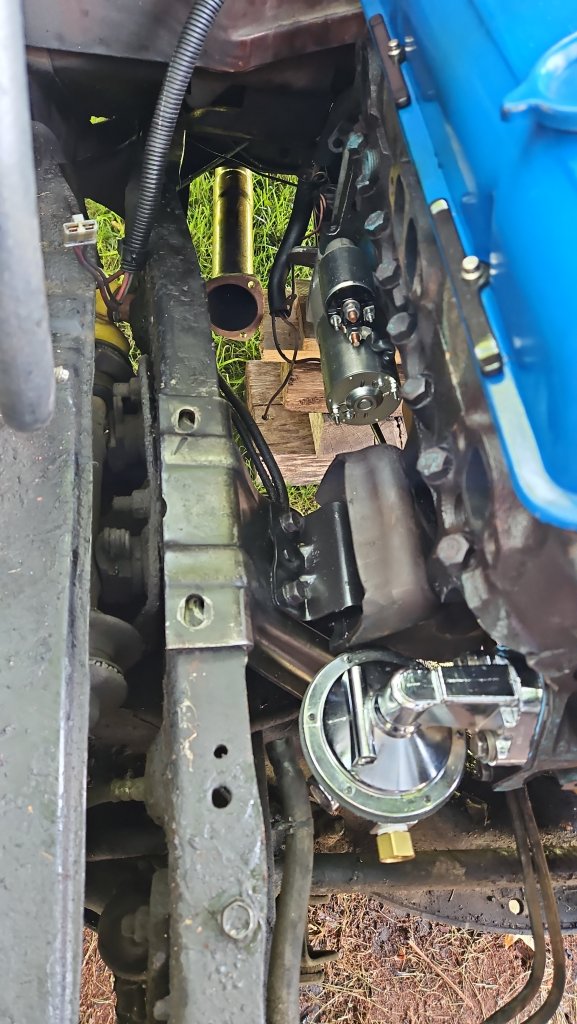

BTW...
After sleeping on it, the second shift mechanics did not like the idea of using a ground-down tapered bolt to help with lining up motor to bell housing.
And here's their reasoning...
If the bolts were in the motor and something shifted or moved with a lot of enertia behind it, a threaded hole in the block or a thru hole in the bell housing could be broken off.
Not worth the risk.
Better to take time to line things up.

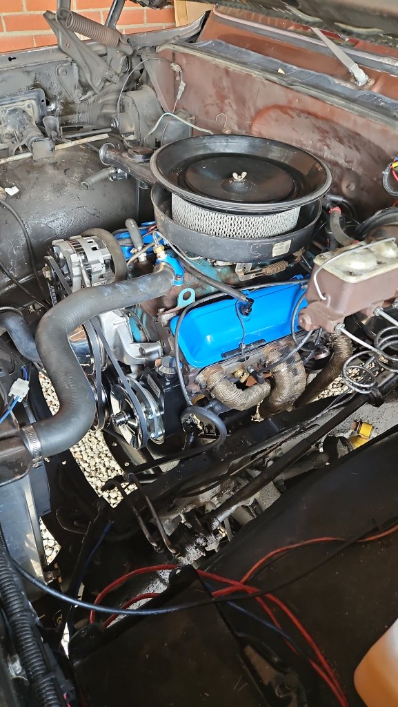

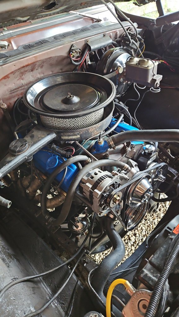

She is back on the road.
I will have the replace the hi side p/s hose. I did the low side & hoped the hi side would be ok....it is not ok.
Other than that...it sounds amazing. Runs so nice.
Funny. Just by eye, I set it to 2° before putting on the timing light.
My buddy came over and helped with the timing and get the hood on.
Drove it for a bit, got dinner and back home.
I'll have to get some pics.
