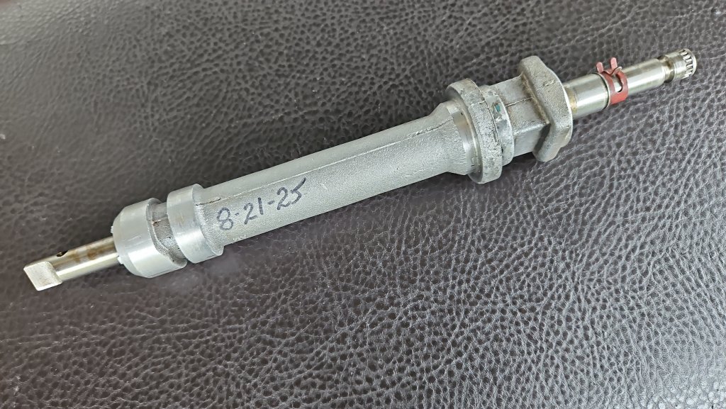

Probably last post on this one, seeings how everything looks good.
I just wanted to share the dizzy re-purpose oil pump driver..
Took the original dizzy, havked off the top, pressed out the bushing from the top and pressed it into the shaft housing.
Slipped on a spring hose clamp to keep the shaft from dropping down into the block. And since I can see the oil pan from up top, the possibility exists.
