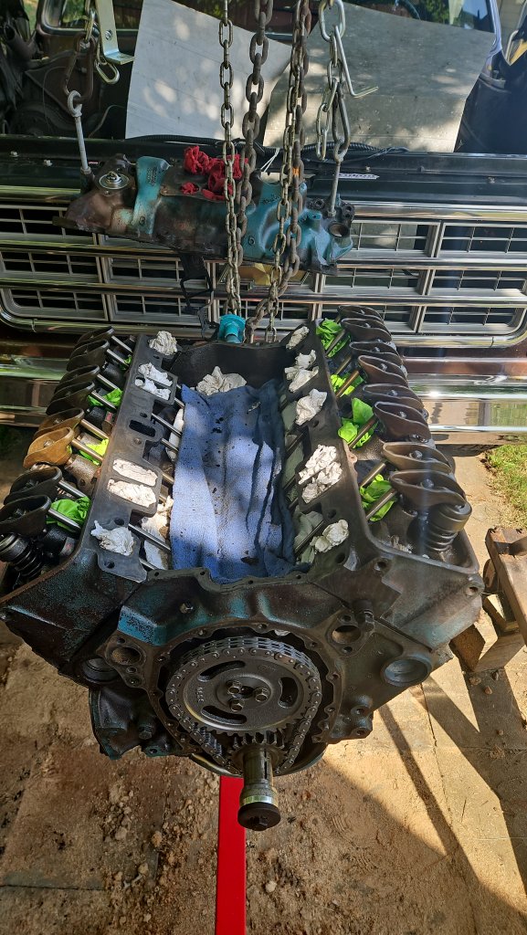

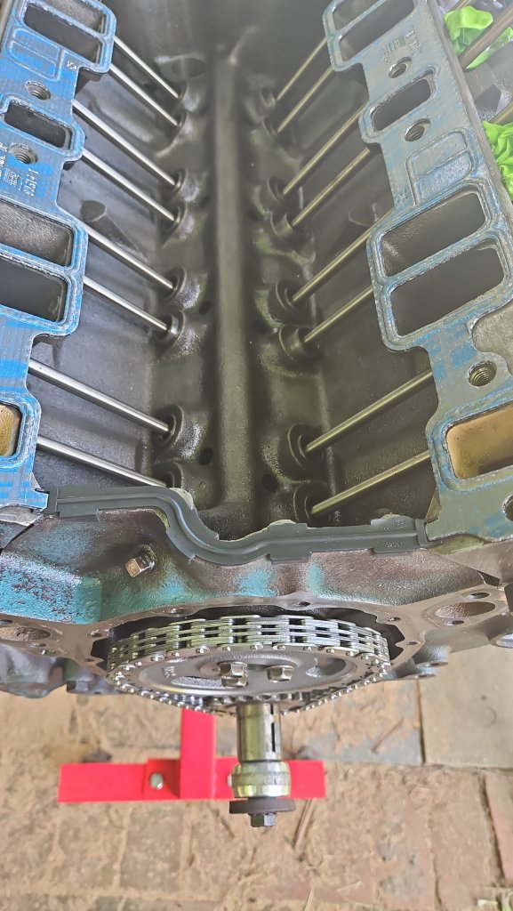

So,

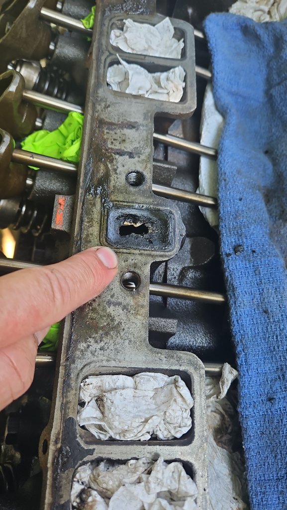

Grabbed some parts this morning and started wrenching.
By early afternoon the valve stem seals were done. Half way thru my 25 year old spring compressor gave up, so another trip to parts house, then finished up.
Then off came the intake manifold. I can't believe how loose half the intake bolts were. No wonder it was leaking oil.
Anywho, cleaned everything and sprayed all the mating surfaces with brake cleaner and ran a tap into all holes and rinsed with brake cleaner and compressed air a couple times. Applied rtv as per gasket instructions and bolted the manifokd back on. Timing chain cover went on and by then it was time to feed the mosquitos.
If all keeps on track she may be back on the road by the weekend....Lord willing.
Oh yea....check out the almost choked off heating passage. And it was packed tight on the intake side.
No wonder it acted so cold hearted.

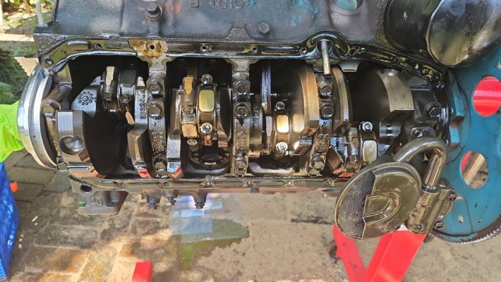

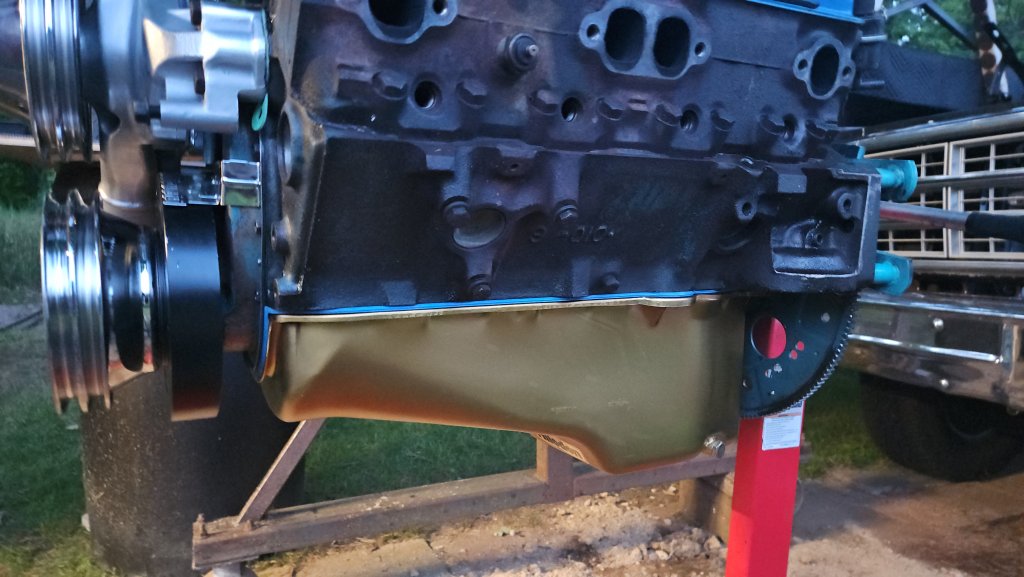

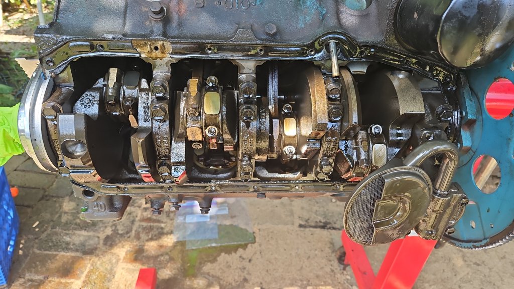

Didn't get to it till afternoon.
Then I had to run to SR for rear seal !nd to straighten out an issue with timing cover. The cover has to timing marks and the only oned they have are over at the 2:00 position. My timing marks are at 12:00 and you have to time thru the top of the water pump. I wanted to get a new dampener because I could see cracks in the rubber of the 47 yo one. So in trying to sort this out, here come to find out, this is a rare motor. Not sure what makes it rare...maybe because the owner is half baked....ha..ha..
So finally I just got a standard dampener and bolted on a standard timing marker.
Flipped the motor crank up after dropping the pan.
Cleaned it all up and dropped on the 1piece gasket..
Oh... the rear seal was no problem. Took a small punch and got it started out on the block side. Grabbed it with needle nose and out it came. The new one slid right in. I would not want to be doing this with motor in the truck....no freaking way, fred...
I might get it back in the truck tomorrow...if it don't rain.

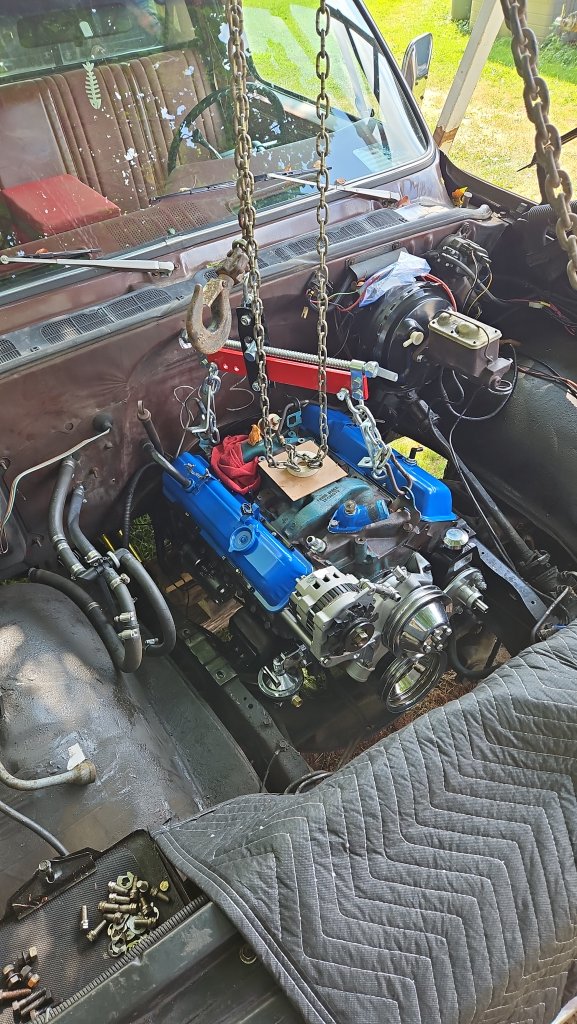

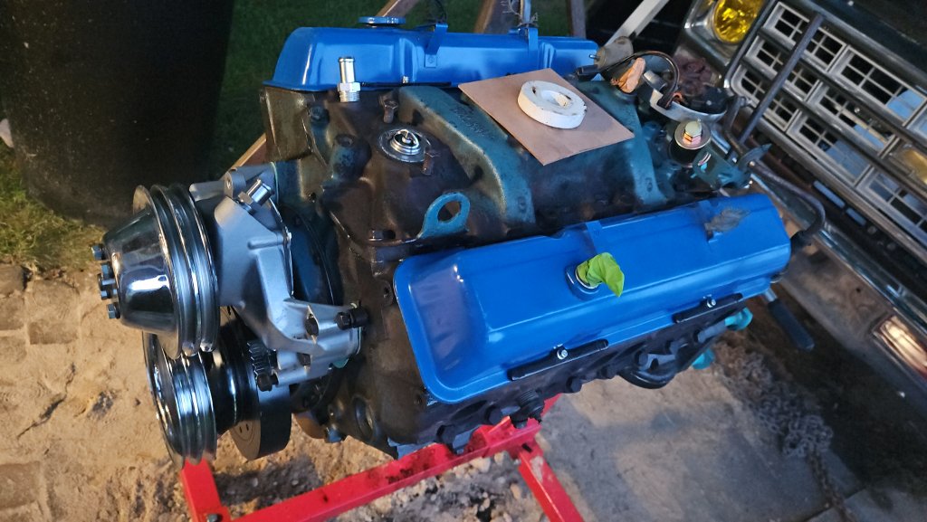

Well...I am pooped.
The goal was to get the motor back in today, but the little things derailed that plan.
2 trips to SR for a p/s pump that finally fit. First on had the return line interferring with the block.
Oil filter, oil....still forgot spark plugs.
Converted the old dizzy into an oil pump drive.
Stuck it on a cordless drill and ran the oil pump while slowly turning the motor over by hand. Did not see any leaks.
So the game plan for tomorrow....
Mount the mounts.
And get the motor back in and running.
The weather keeps looking like it's gonna pour any minute.
