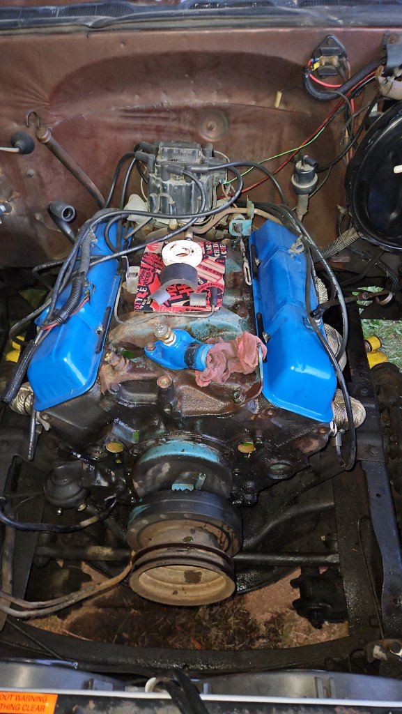

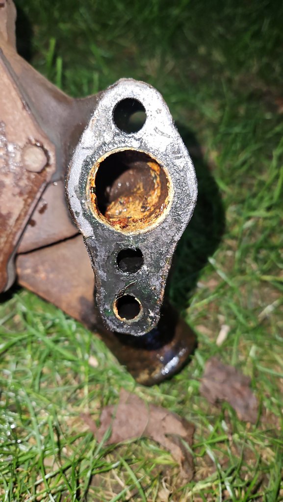

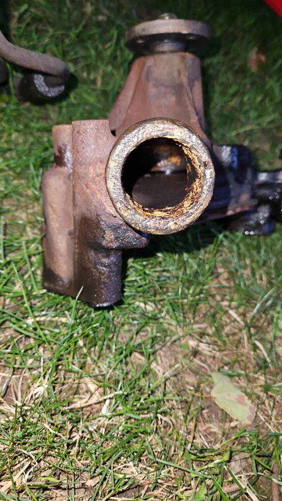

Well...I had my wife do a quick search for an engine stand and found a local one for dirt cheap.
That cinched it for me. I had set $50 as my lmit and this one was well under that.
So I came home and got going on the "big yank".
First off, I made up a sling for the hood and used a block and tackle to lift it off the truck, then the wife backed the truck up and gently lowered it to the ground.
Then the batteries came out.
Drained oil and coolant.
Removed, alt, p/s, water pump and carb.
Tomorrow the rad will come out, then the headers.
The rest of the wires then the flex plate and motor mounts.
Lord willing, the motor will be out by this time tomorrow.
I can't believe how nasty the water pump is.

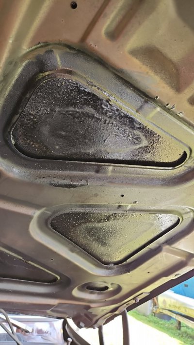

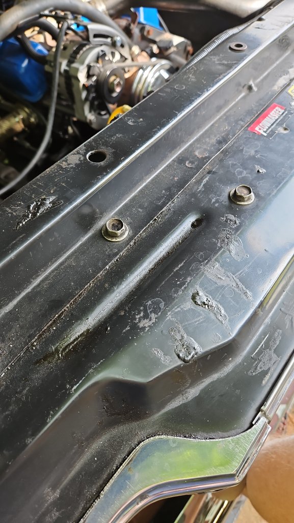

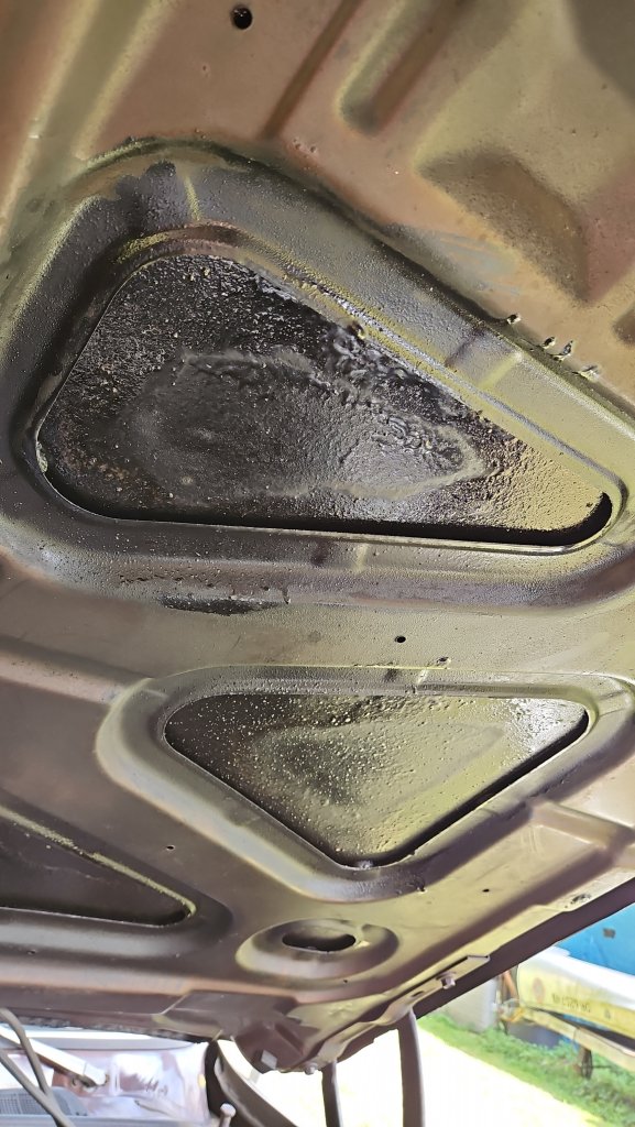

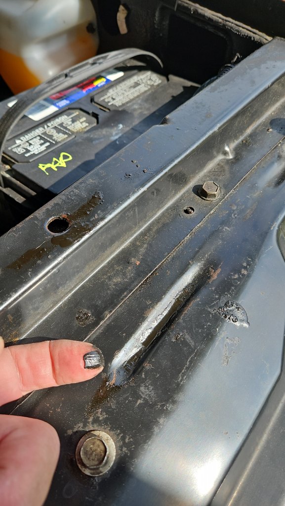

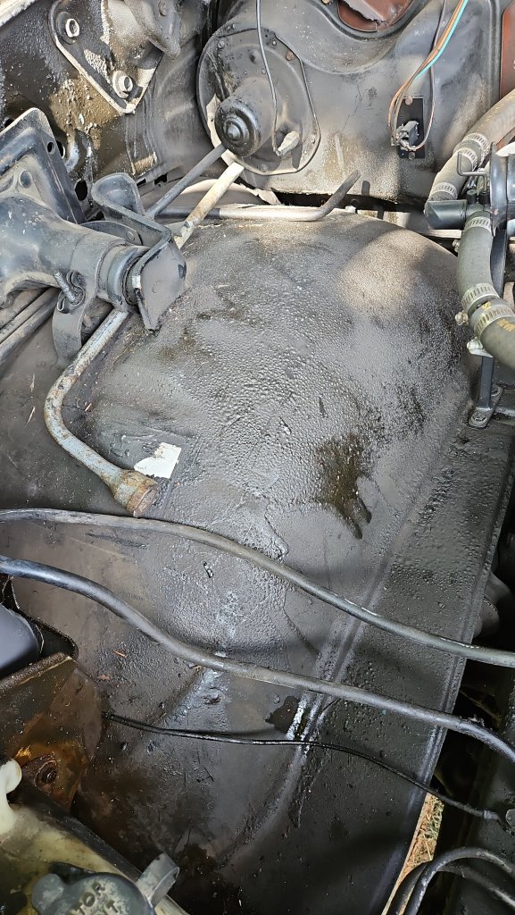

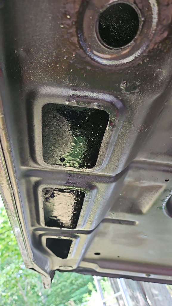

Here is some of the undercoating.
9,558
17,538
Yuck, wtf? And it’s sprayed all over where they DONT rust out…..
Well I’d start collecting folks’ old boat gas. A pile of rags and 5 gal can of gasoline should do the trick!
You’re making good progress. Don’t forget to label wires and hoses and bag/tag bolts since it’ll be a minute before you reassemble.
Bag and tag.....and the wife wonders why we go thru ziplock bags so quickly.
As for the ziebart, the cab has 8 holes drilled just in the roof. The stuff runs down the inside "A" posts. And the back corners are just as messy as the engine bay.

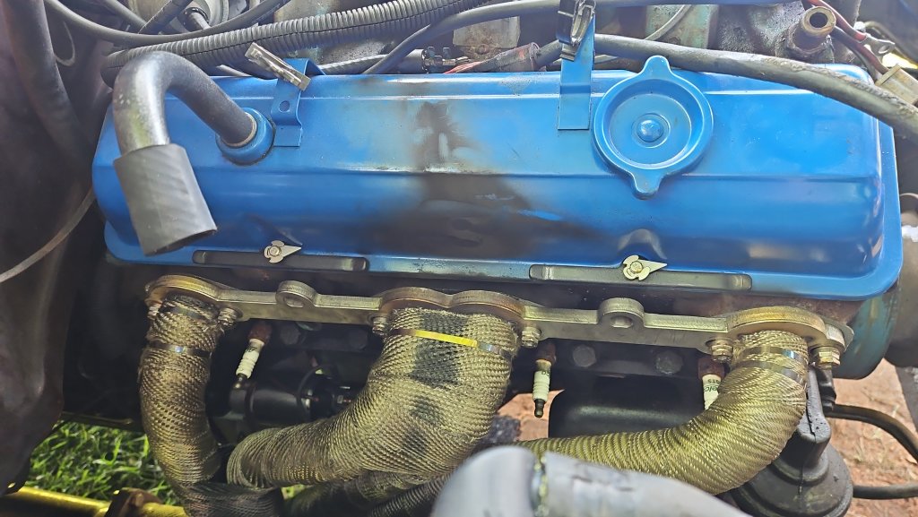

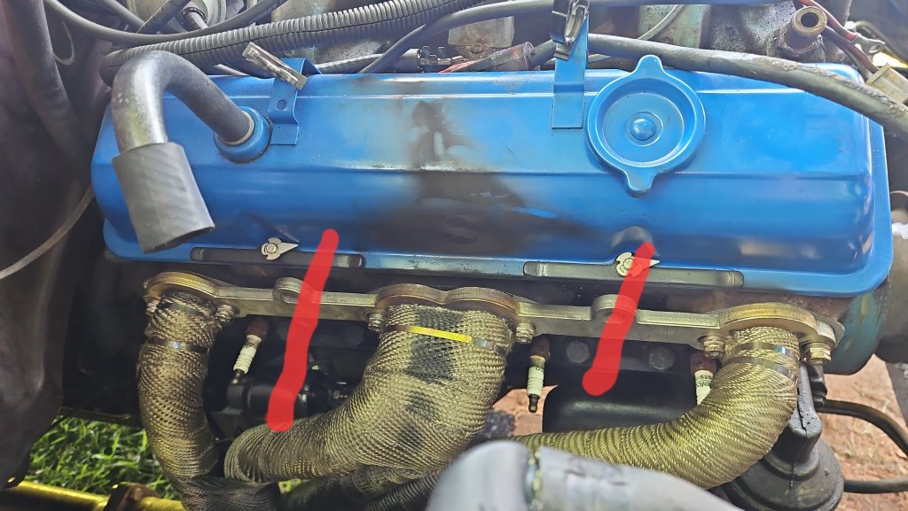

So, I have a question for those who have been there-done this....
The header motor flange is 3/8" SS. As you can see in the picture, cyl 4&6 are leaking. And reardless of the bolts used, the flange gets hot and expands away from the motor....of course it would. And I had been told this is usually an issue.
So here's my ???
If I cut thru the thinner web area between the exhaust ports...i.e. (see red line)... between #2 and #4...and #6 and #8, is those now "free floating" 3 pieces going to behave them selves or twist up even worse?
Thanks.
hey mister
Jun 15, 2024
519
1,164
North Coast
Marty
My other thought was to take a grinder and "thin" out the area at the red line.
They would still be connected, but now the area of "give/flex" is away from the ports.
And here's my reasoning.
The material at the ports is very thin compared to that bar spanning between the ports. That bar has a greater expansion distance because of it's length.
And there is one on each side of 4/6. Double whammy...
