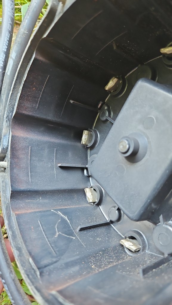

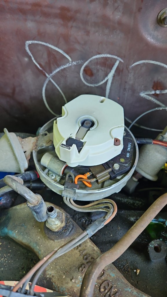

I must of missed something, somewhere....or I was lied to...
Everything I ever looked up for this engine said that it had no contacting points in the dizzy...i.e. nothing to replace unless the brain blew up.
Because, when I got the truck, I did, plugs, wires and was gonna do the dizzy cap & guts. Everybody said nothing to replace...it's non contact....even Summit.
If the coil pack is good and the module is good, leave it alone.....Aarrgghhh!
Oh yea...what's with the condenser?....geeze!
Oh well...add it to the list...

Yes an HEI distributor doesn’t have any breaker points, rather a magnetic pickup.
Cap and rotor, along with the carbon element are all still consumables/wear items like a points distributor.
Coil, condenser, module, and pickup are still service items, but quality parts (OE, or quality aftermarket) should have a long service life.
From the 79 service manual, 22.5k mile intervals to check the distributor.

Look like you got-a big vacuum leak
in the rotor picture

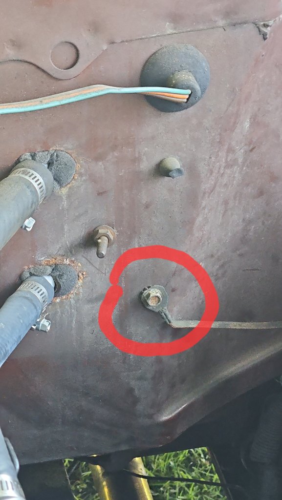

And this just cracks me up....
Ground strap from motor to pass side firewall...
Held on by a 10mm bolt...freaking metric....
It shouldn't surprise me...I had a ford f150 and the bumper bolts were imperial. In fact, most of the frame bolts were imperial. Inside door sticker said made in canada...

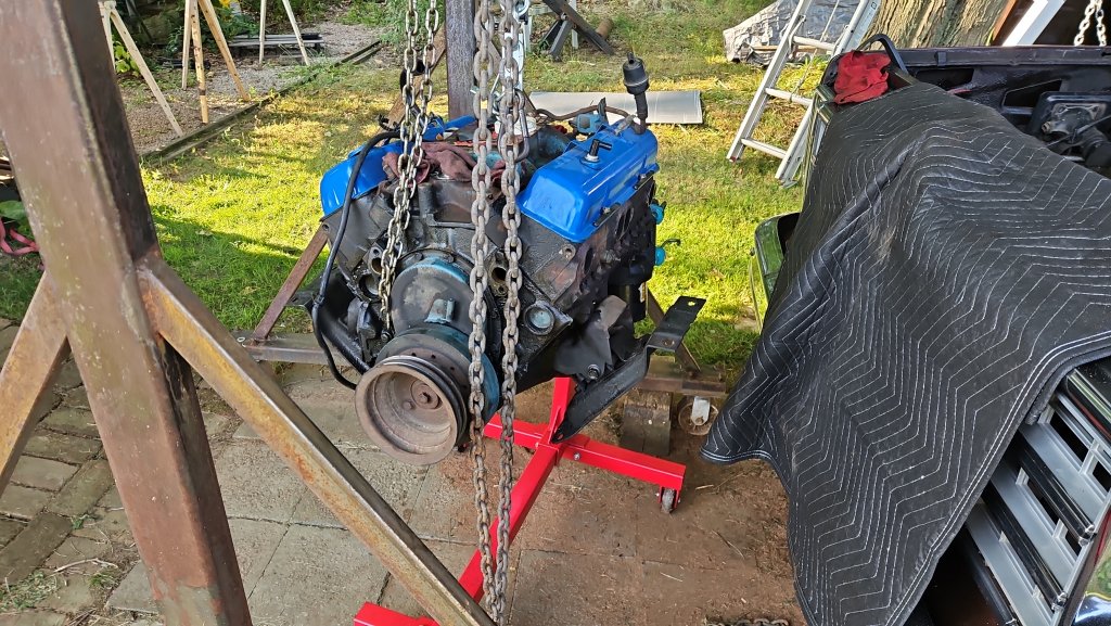

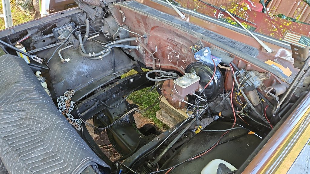

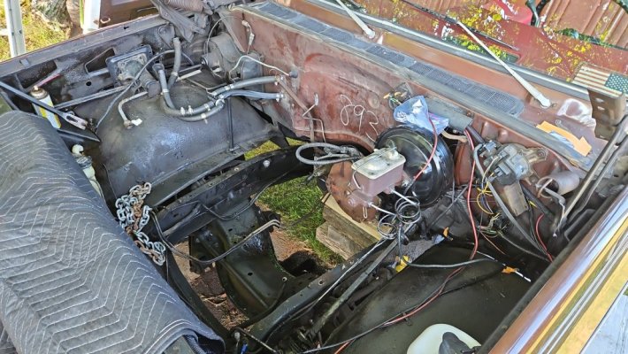

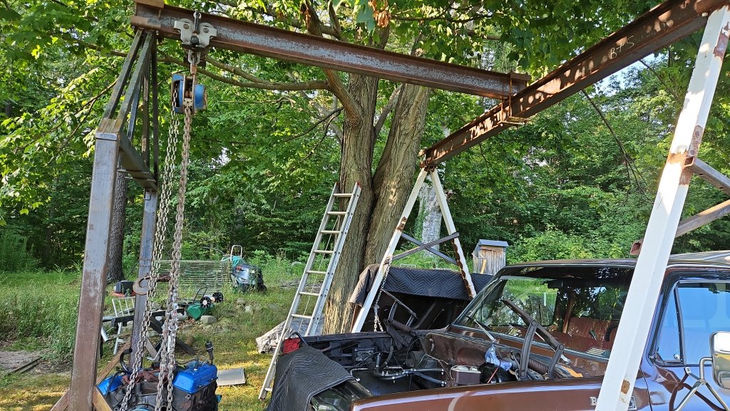

Motor is out and I did it with no help (other than wife mentioned previously).
All by me lonesome I did...
And no bruises or bloody spots.....a tad sore.
I don't even know where to start with the tens unit.
The biggest hang up was the motor mounts. Not because of rust, but because I wasn't sure which mount to take off.
I started at the 1 long bolt, but that required a very high lift to get clear enuf to bring the engine foreward, and off the bell.....fail.
Then I started to unbolt the clam shell, but the 1 bolt was too tough for me to get a wrench on.
So then I said screw-it and took it off at the frame.
Took up the chain tension and made a couple adjustments to the leveler and gave a little tug...out she came.
Fortunately, I had measured the distance I needed to raise the motor clear of the core support. Had 10" to spare.
So with a bit of cipher'n... i started working on it at around 5 pm yesterday and quit at around 8:30. That's 3-1/2°. Started at around 9 this morning and the motor was out by 5:30ish. That's 8-1/2° including lunch and a few breaks and I was in no rush. Took my sweet time. Total is 12°. I don't think that's too bad for a first time, solo yank with a gimp hand. (had major hand sx 14 weeks ago)
Yes, things are better but it's still only about 50% strength. But coming along.
Fred (that's the name I gave it) (Fred Gwynne) stitches reminded me of Herman Munster.
Anywho. None of the bolts have any signs of rust. Zero.
The motor mounts are mush.
The dizzy shaft has a bit of shaft play. Not the end to end play...diameter to diameter fit play. So I'm thinking a total replacement.
The power steering pump I suspect is original. It works fine and I can clean it up and give it a krylon rebuild.
The hoses will be replaced...the ends are all cracked. Alt was new last fall.
So other than gaskets and seals, that should be about it....

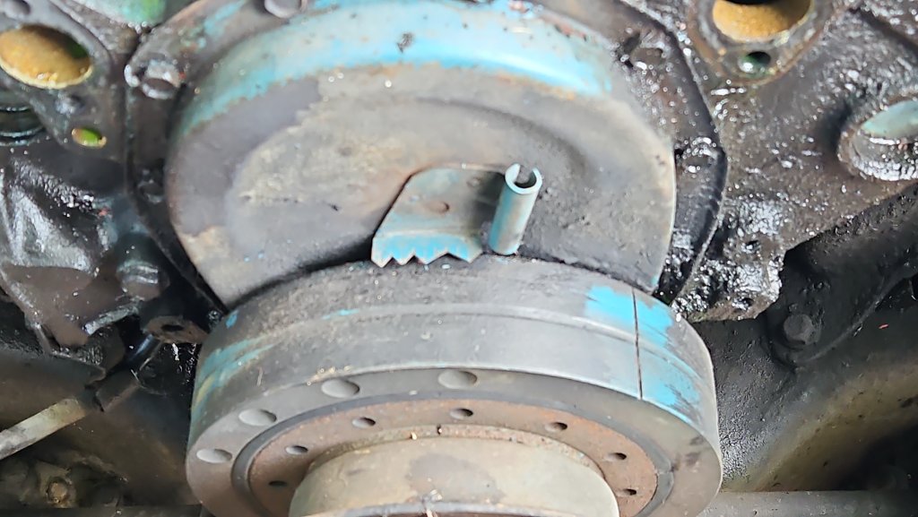

Speaking of which...I picked up a nice Edelbrock timing cover. But it has no timing marks. What is a po-boy to do? Looks nice anyway..lol

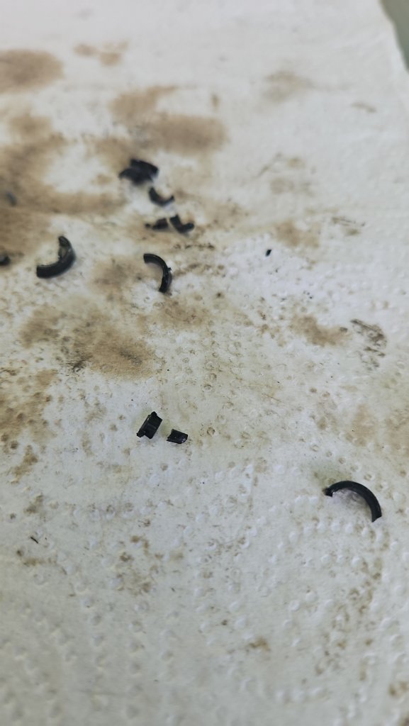

But I did find out that my valve stem seals are □ o-rings...there were 3 options.
Took SR 3 tries to get the right ones.
And oh, those are so much fun....
47vyear old O-rings petrified years ago.
My '81 is blend of metric and American sizes.
