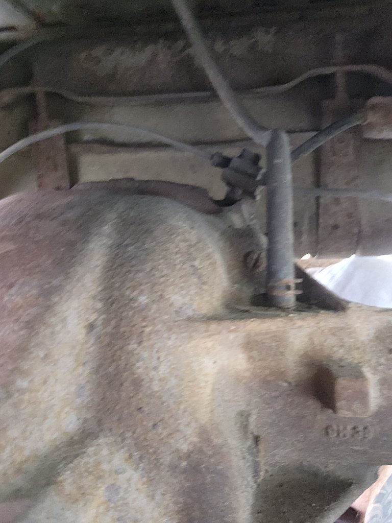

Hey guys,
K20 1982 3/4 ton 6.2 v8 diesel
Decided to change oil in diffs today. Only had time to do rear.
Despite being careful the gasket tore and jt leaked. So silicone and now she's drying up.

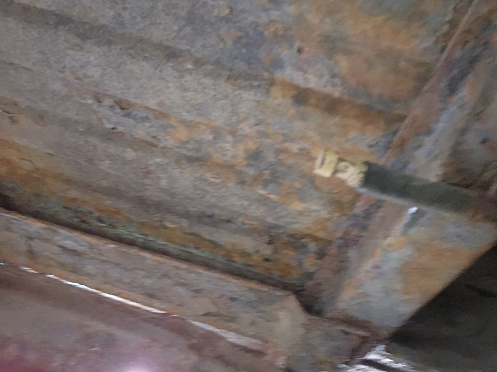

Onto the question... my rear diffs fill plug, it has a narrow 1/4 " diameter tube about 2 inches tall, and a rubber hose coming out of it and up to a plugged end bolted To a bracket on the body... see pics. What on earth is that? Is that to fill it from a more comfortable position?
Then plastic plug at the plugged end looks like it can come off and I tried butnit felt fragile and indidnt want to break it...
Anyways the entire length of the hose is about 2 feet maybe which tells me you could fill by feeding the hose through the wheel arch and do it from a more comfortable position... is that the only apparent goal, has anyone seen this before?
I didnt see it in the Haynes squarebody or 6.2 diesel manuals...
Sorry for the blurriness.
You see the hose clamp holding the rubber hose to the fitting that... honestly I didn't want to damage it by seeing if it was threaded in or whatever. I jist bypassed the hose and filled it with my gallon hand pump and clear hose.... then it leaked. Anyways....
Who has seen this before? And what do you guys have as a fill plug?

Look at the passenger side of the front part of the differential for a fill plug.
A 3/8" square drive will fit it.

Axle vent, that's what I thought, so that plastic tip then is like a screen prevent dirt n crap getting in and just breathe to equalize to atmospheric pressure as the fluid moves around... a.k.a a vent. Lol ok cool good to know

I thought I saw a 3/8 drive plug and then saw that line with the vent. So tomorrow I should fill through there and not through the vent, that 3/8" drive plug is my fill as well as tell tale for when it's full, correct?

Yes, with the truck sitting level, fill until it just barely starts to run out the hole.
And, as a general rule I was taught back in the 1960's, if you can stick your pinky in the hole, aim downwards, and you have gear oil touching the finger close to the first joint, you have plenty of oil in it and there is no danger of it running dry or being damaged.
